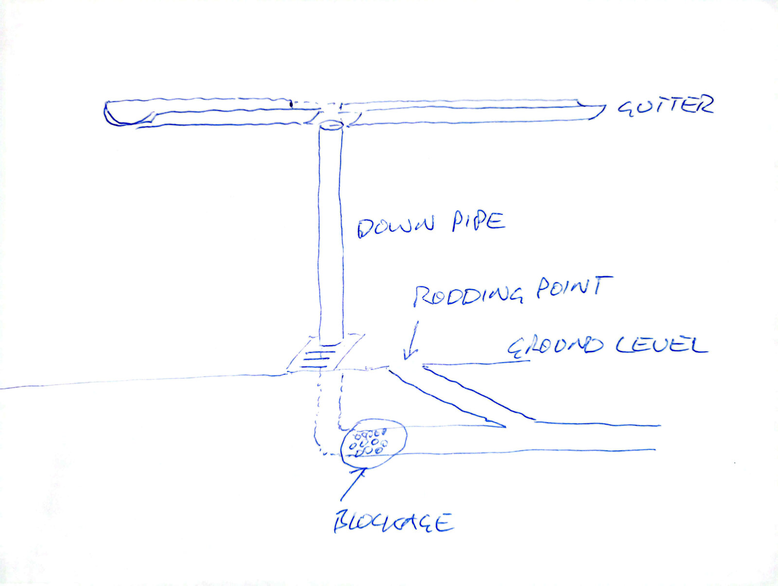

I have a down pipe from the gutter, that goes down the side of the house and goes into a ground drain.
Diagram below.
I can get my arm all the way down to the blockage and have completely cleared that far, but can't reach round the 90 degree bend, shown, to get to the rest of the blockage.
I can feel small stones, chuckies there, just about touch them, and don't really want to push they further down the drain with a power washer.
I haven't yet tried the power washer, though it's obviously an option.
Is there a
- rodding set that does 90 deg bends that is of use. I don't see anything obvious on Toolstation or Screwfix
- way to pull what's there out without pushing it further in?

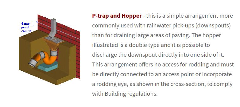

Water sitting in there,quite far down, could be becasue it is a p-trap, or just becasue it sits that high with the blockage.
Starting to think the water level means it's a p-trap, even if it is partially blocked.

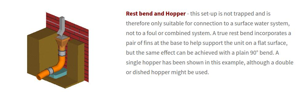

I think this drain is a "rest bend and hopper", 1st dagram below, but it could be a "p-trap and hopper", which is the pasted diagram below that ..
