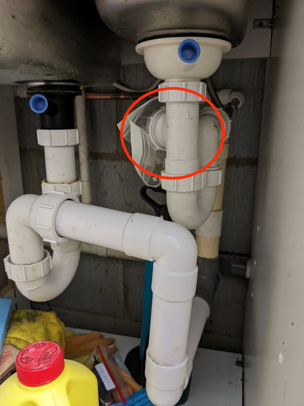

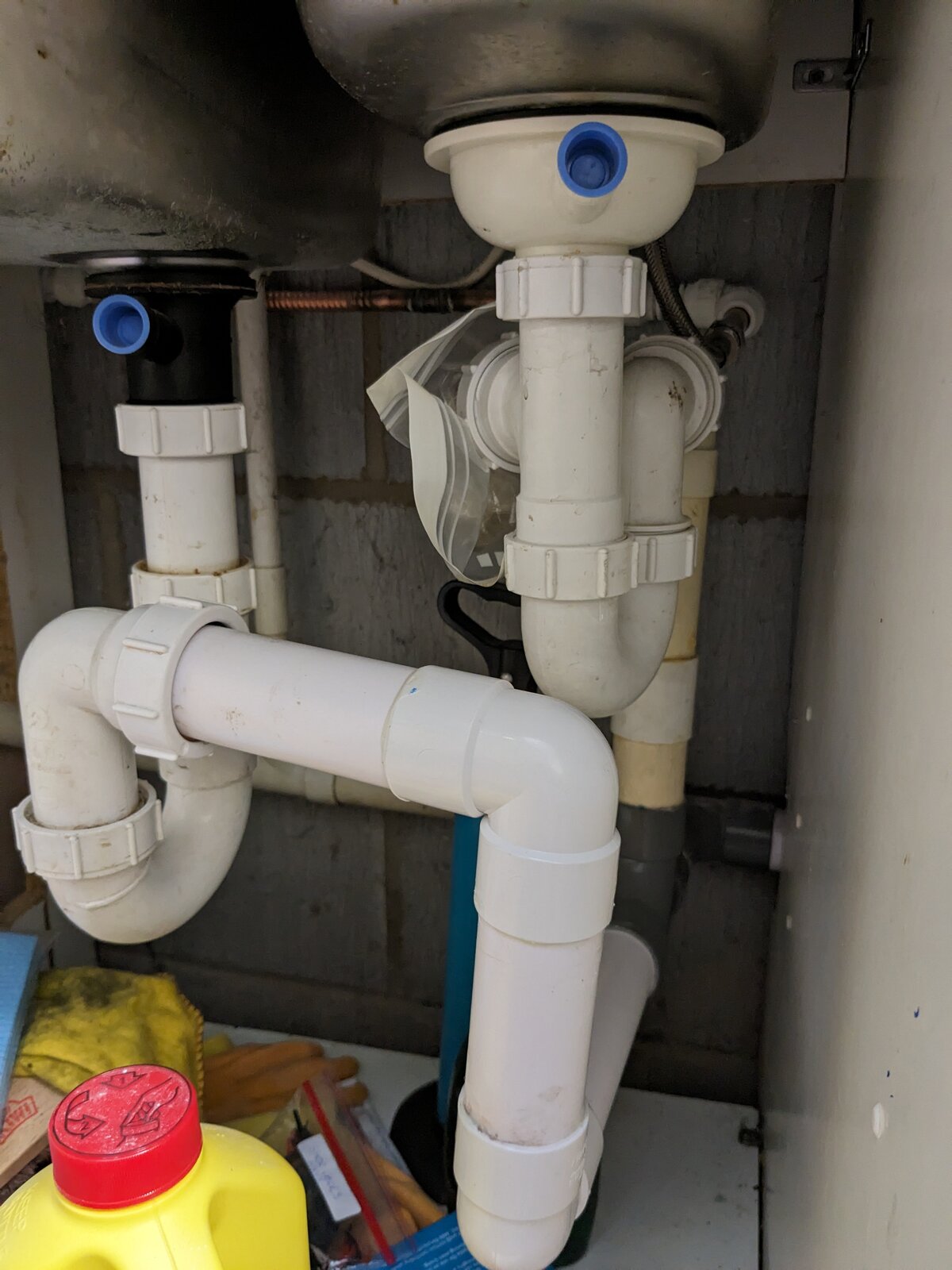

see pics
Under sink plumbing - the smell comes out of either sink. This was how the original was plumbed in so just replicated it using old fittings and a bit of new .

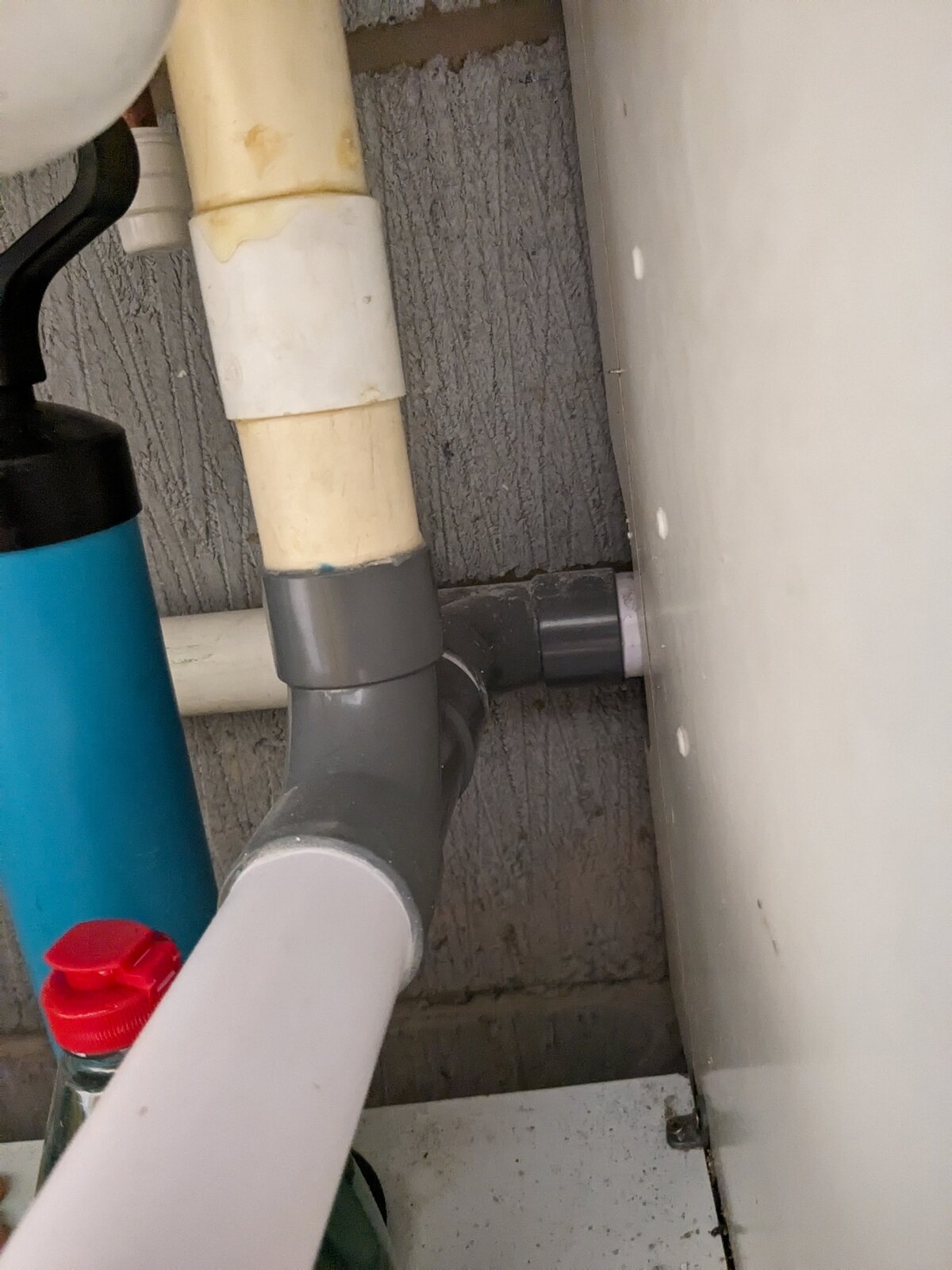

This is where I teed it into the waste pipe to the soil stack

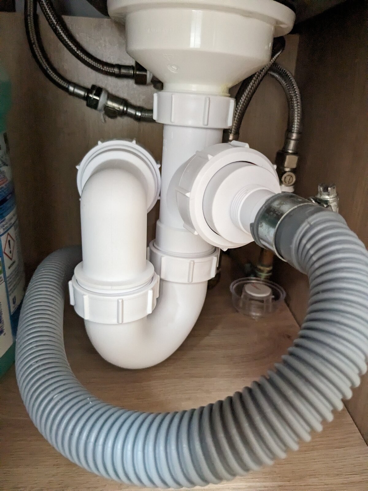

Is the appliance spigot sealed?
OK - the only thing that is can be then is back pressure from the other outlets or there's syphoning occurring - nothing else could cause it, unless the traps/waste were gunged up of course.
Hi..traps are clear . This is the plumbing under the utility sink- ie washing machine waste- spigot? (is that what you mean- apologies if not). Waste pipe through wall and I connected about 3 foot the other side of wall.
I meant this one
Not that it matters really - as suggested the only thing that will allow sewer smells back up into the sink is if the water seal in the trap(s) is compromised. Everything in the pics looks fine, even tho the swept T is round the wrong way, could that cause back pressure in the other trap - possibly.
