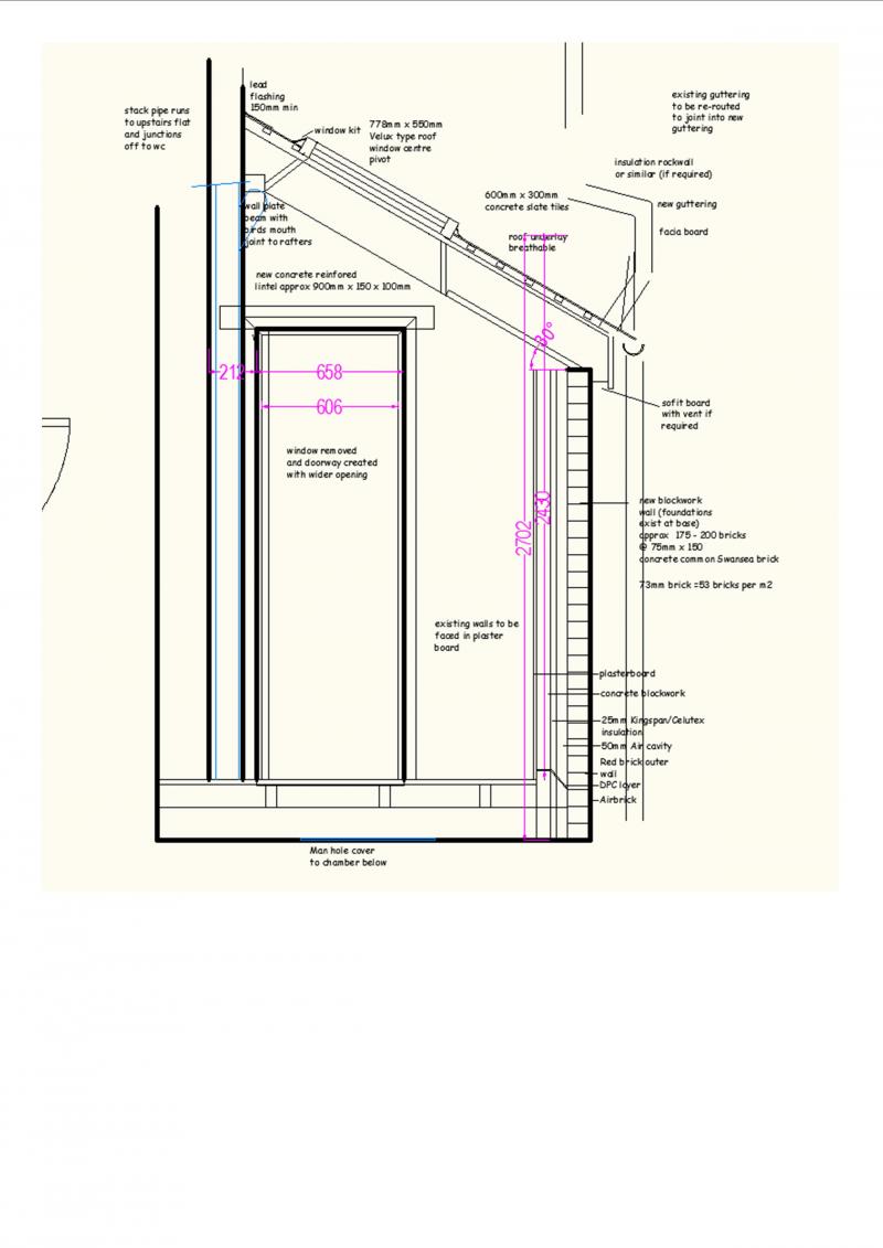

new first draft CAD drawing of utility cross section

Why don't you just re-new from the hopper downwards in plastic, that way you can sort the leak under the floor (which if left as it is can cause subsidence), and you have a chance to neaten it all up and box it in? That way you don't have the hassle of asking the people above for money.
It will be a relatively cheap and easy fix. As far as regs go, you can no longer install hoppers unless replacing like for like, so you are good to go on that one.
If it was my place I would get a couple of quotes to move the inspection chamber outside the utility room and run all the plumbing down the back of the building, I know you dont want to pay for past bodges but you may have no choice if you want to do it properly.

Looking at this (and your other post ;) ), assuming its not too corroded or leaking, i'd be inclined to leave existing iron stack (in the corner) as is. (Less work!)
Remove the hopper and downpipe, and dig out existing gulley in utility room. Couple onto outlet from former gulley, and install appropriate piece of drain and new 110mm plastic stack with AAV on the top. Reconnect the wastes above the roof into the new plastic stack, tidy up as necessary. Join existing wastes in utility room into new stack at appropriate level. All now sealed. (Run whatever you decide past BCO though for approval!)

I'd leave the stack for upstairs toilet well alone if its not presenting a problem. Going to make you more work (and expense) to change it, and you'd also need access to flat above to change pipe up to the pan, pan connector, making good etc. Unless its leaking or badly rusted leave well alone otherwise you'll be making a lot of aggro for the sake of it. :rolleyes:
My suggestion was to tidy up the wastes, connecting those into a plastic pipe, join this to the existing pipework underground. If you remove the old gulley, then the pipe from this can be used, simply fit an appropriate collar to convert from clayware to plastic.

Dear Plumbing, Soil pipe and drainage experts (especially Hugh ;)
Sketch of rear of property looking at utility from railtrack showing proposed soilpipe arrangement:
Sketch of new bathroom waste pipe arrangements:
CAD elevation drawing showing creative design for new bathroom + utility door:
CAD Plan drawing showing creative design for new bathroom and utility:
Having been in contact with some people on here a few months back I have had various people around to view the work with the aim of them doing it. However some folk never even submitted a quote and others wanted the price of a new car to do it. So I am back to considering doing as much of the basic (ie donkey) work I can and getting in trademen to carry out a few tasks for cash and me scheduling it all and working out the correct sequence.
I am hoping you could have a look at my designs and give a bit of feed back as to the logic or if conventional or not. Just let me know if anything stands out being the 'wrong way to do it'. Since I am replacing mostly old for new and carrying out maintenance I am less inclinded to pay building control for every 'job' that needs doing around the house and there are lots of them. Many builders commented that it is all basic repair work.
One suggestion was to leave the 'corner' CI downpipe as is in order to avoid any disruption with people in upstair's flat and their loo respectively. I would therefore need to run a complete new plastic downpipe and fittings near to the outside wall at the back of the property. Although since there is a new cavity wall being built along the back there the pipe would need to be set in slightly by about 350mm. Also I am a bit confused as the rainwater guttering would need to link into this same downpipe. In the sketch I didn't know how to draw this at this moment. All the drains in the property are shared for surface water and soil waste it is not split as Victorian etc.
So hope someone can give me a few pointers before any work starts otherwise I could try and charm the plumbing shop to help a bit with advice in exchange for me buying their pluming fittings for my renewal job!

I'd call BCO and try to esplain what you're doing. In my exp they're pretty helpful. Very likely they'll come and look to advise on what's ok and what's not on the drainage side, since what you have is shared with someone else, who's done it wrong! You needn't tell him that you're the landlord of the upstairs flat.
