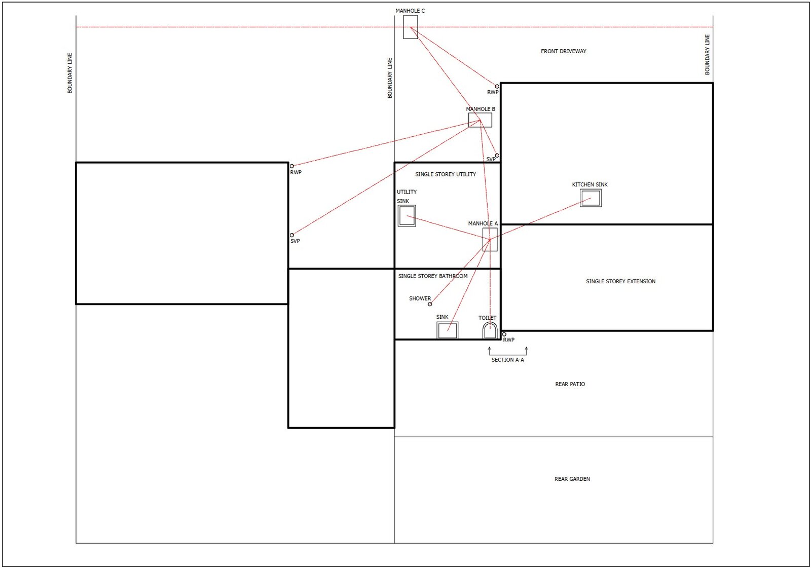

I have attached a plan of my property (right hand side) and the neighbouring property to help with the explanation of my problem…
So the RWP on the rear patio has got me scratching my head…
I noticed one day that it wasn’t draining, so I had it jetted which removed a load of gunge that had made its way down there from the rooves it is servicing. This then allowed the water to drain away, although not quite as quick as would be expected of a 4” pipe.
The guys then set about exposing the pipe in a bid to see where / if it is plumbed in. It starts off with a 90deg bend, runs horizontal for approx.. 600mm, then another 90deg back to vertical, appears to reach around 1m below patio level, and then hit a load of hardcore / rubble. Not what I was hoping to see.
The guys then opened manhole B (which is not as deep as the RWP to the rear, approx.. 650mm), ran water down the rear RWP with some tracer dye, and it eventually made its way to manhole B. The problem is it appears to be making its way into the pipe in a crack somewhere between manhole A & B. A small amount of water also eventually comes out of the pipe running from my neighbours SVP into manhole B. It also looks to be leaking from a crack underneath where my neighbours SVP pipe actually joins manhole B.

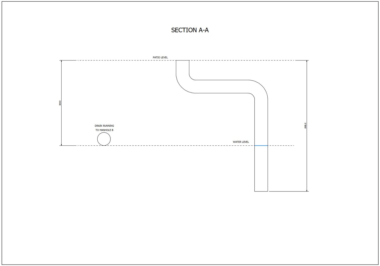

Another worrying sign is that the water level in the rear RWP drain sits a certain way up the vertical tube (I am assuming this is the same height as the lowest point of a crack in the drain pipes that it can enter) The guys vacced the water sat in the rear RWP out, and it filled back up to its previous level. (See Section A-A on sht2 attached) So now I am having visions of some sort of reservoir sitting under my property??!

From what I can ascertain, I suspect the Rainwater has been directed into a soakaway, (the hardcore/rubble you speak of), possibly as cheaper option than running it to the sewer. (Either this was agreed with Builder or Builder has done it off his own back and not told the Client...)
2 runs could have been laid from Manhole A, one to the bathroom, picking up the WC, Basin and Shower, a second alongside, and through the rear wall to a Gully for the rainwater.
Dye test, not quite sure what is going on there, but does seem like the water is finding it's way through to the sewerage system, either by accident or design, quite how though I am not sure. I would suggest you get a reputable Contractor in to CCTV the drains, and report on their condition before going much further, and decide on a course of action from there. Lining and patch repairs from existing manholes are an accepted solution for damaged drains, but it needs carrying out by someone competent, (see too many failed liners fitted by Cowboys who are charging 4 figure sums for the privilege.)

Yeah it is looking more and more like some sort of soakaway, although the pipe doesnt get any more than 100mm away from the extension wall on its route down to where it ends roughly 1m below patio level, so is essentially directing all rainwater straight down to the founds?!

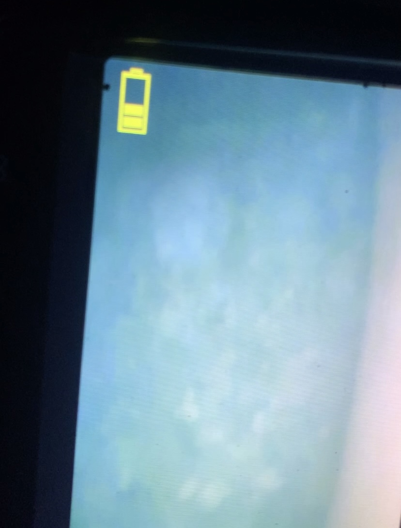

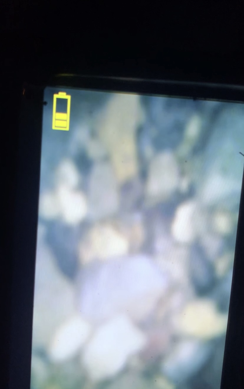

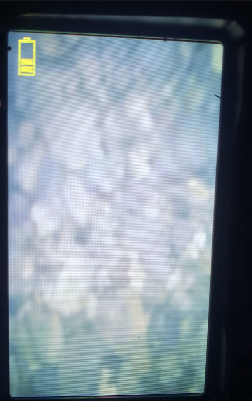

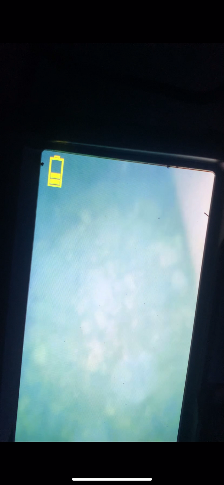

The other bit that is really concerning me now is that the water is standing at the bottom of the open pipe (as I have tried to detail on sheet 2 on initial post) how is that even possible considering I have not allowed any water down that pipe for a while now, how can the ground be that watertight? I have attached a couple of pics I took last night after miraculously manoeuvring an endoscope down the pipe (First 2 pics are just about where the pipe stops, second 2 pics are with the camera pushed slightly further until it reaches the bed of hardcore) It’s as if the pipe stops, there’s a small void and then a bed of rocks / stones / hardcore looking stuff. I can’t see how that is supporting the area of patio directly above it??!
Yeah strange results from the dye tests as you say, the fact that it does make its way through to Manhole B. Honestly I have images of some sort of pool under that whole section of the house, and once it reaches the level of the drain pipes it gets into cracks and drains that way. Not a pleasant thought
