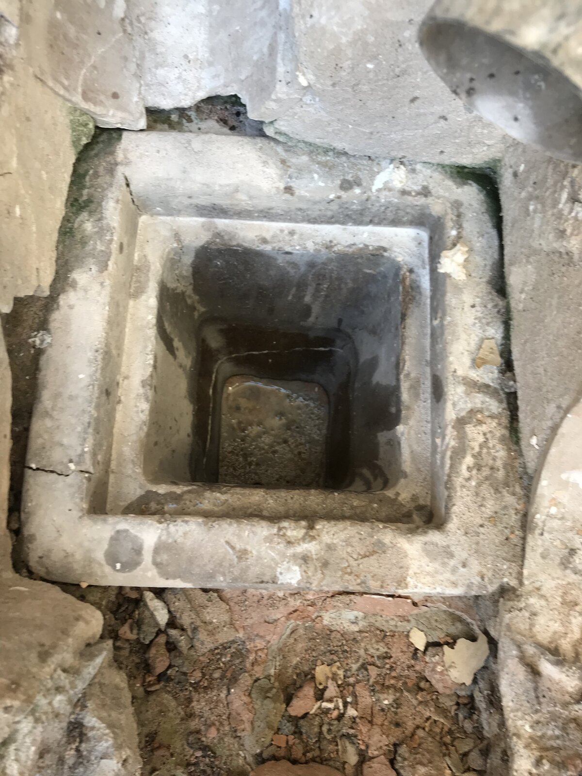

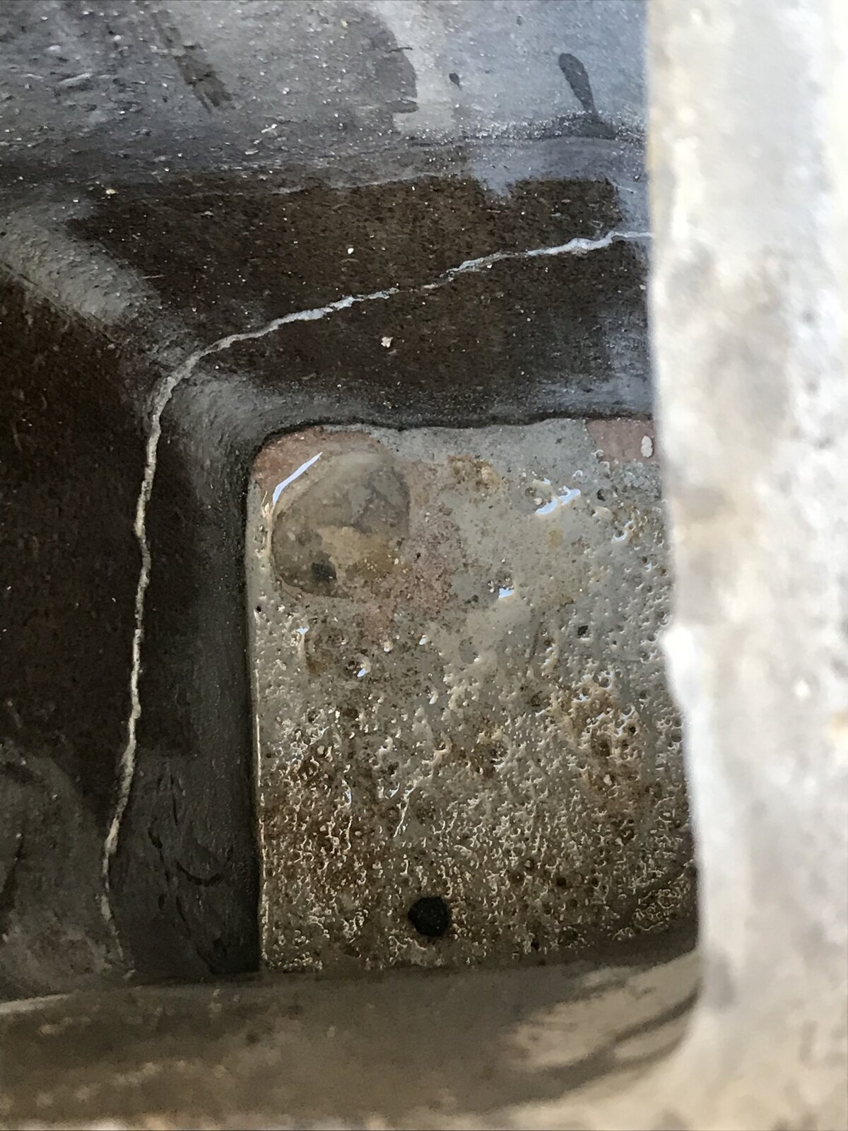

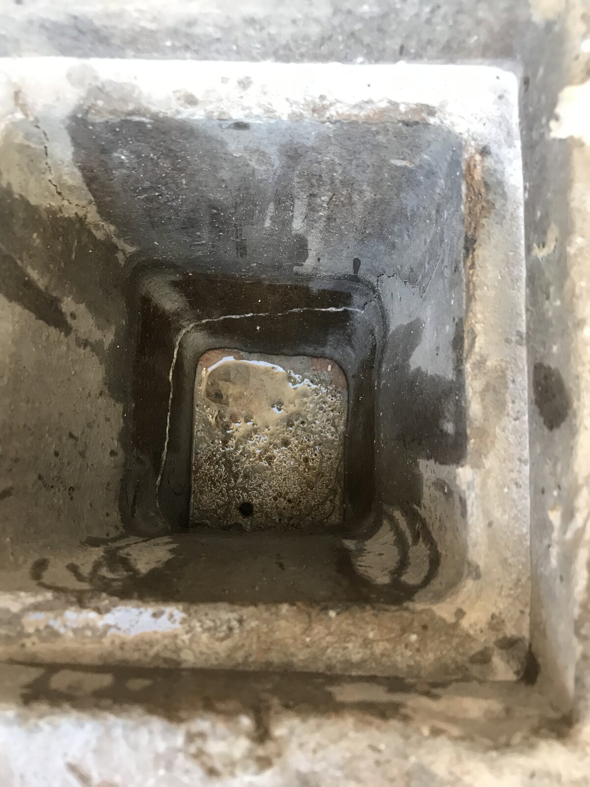

hi all,
We have a damp issue in the kitchen just posted a thread in the painting forum.
I believe the root cause is below. The question I have is can I fix it with some chemical solution and if so what?
Or do I have to rip it out which I don’t fancy doing...

The salt glaze has cracked ... needs dug out and replaced.

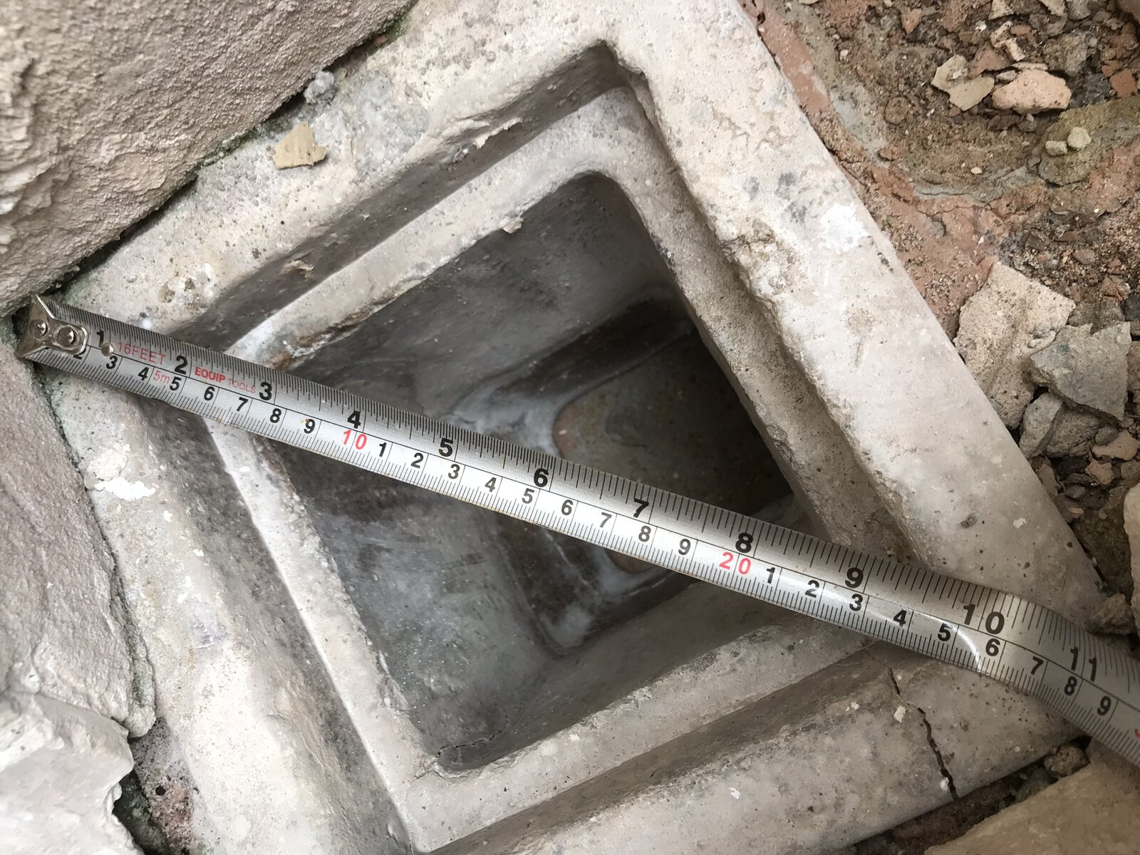

Could you line it with a piece of soil pipe, hmmmm .... what are the dimensions?
I'll check the dimensions tomorrow and get back to you.
Surprised you can't glue it with something though with all the stuff out there :(
When you say line it with a soil pipe. I'm guessing you mean stick a soil pipe in the middle of it and then cement all around the side?
Salt glaze is almost impossible to 'repair' it's hard fired clay and it's in a drain so an adhesive rarely works.
If you're not prepared to dig it up then lining and mortar would probably be the only way to make it water tight again, if it isn't also cracked further down.
oh man! okay let me get some dimensions tomorrow and we'll go from there.

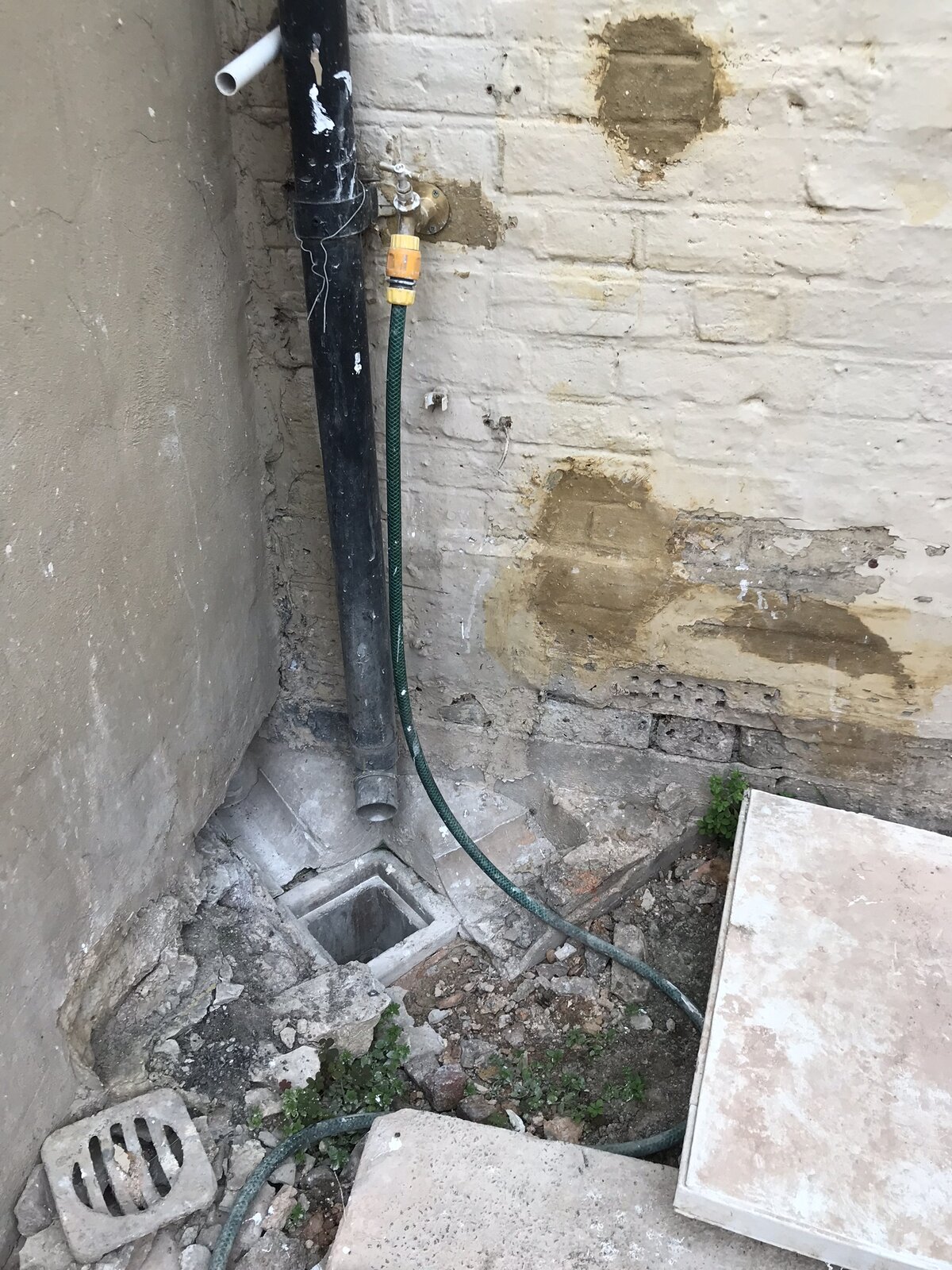

Not as difficult as you might think to replace, as long as you dont mind a bit of digging and shovelling. Photo from a bit further away showing the surrounding area may help determine quite how much work is going to be involved!

Gulley, I would look at using this one, https://www.screwfix.com/p/floplast-d530-back-inlet-bottle-gully/12051, fit a 90° bend into the back inlet, with an adaptor to accept the 68mm downpipe. Are there any other pipes discharging into the existing gulley?
Dig back from the old gulley and expose a decent section of pipework, be mindful of any other services that may be present, and also any other drains as they are easily disturbed/damaged by over zealous digging, dont want to be replacing any more than you have to! Once you've uncovered your pipework, using an angle grinder with a stone disc, carefully cut through the pipe, and remove old gulley arrangement. Chamfer edges of pipe, and fit suitable clay to plastic coupler, e.g. https://www.screwfix.com/p/floplast-underground-flexible-adaptor-110mm/19914
Position new Gulley, and from the outlet, measure up and arrange 110mm plastic to meet cut end of existing drain. If you need to use a couple of bend's to alter height/angle to connect onto the old pipework this wont matter.

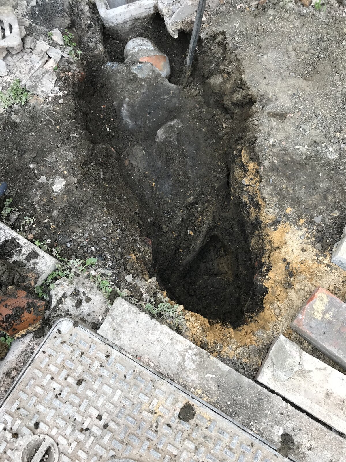

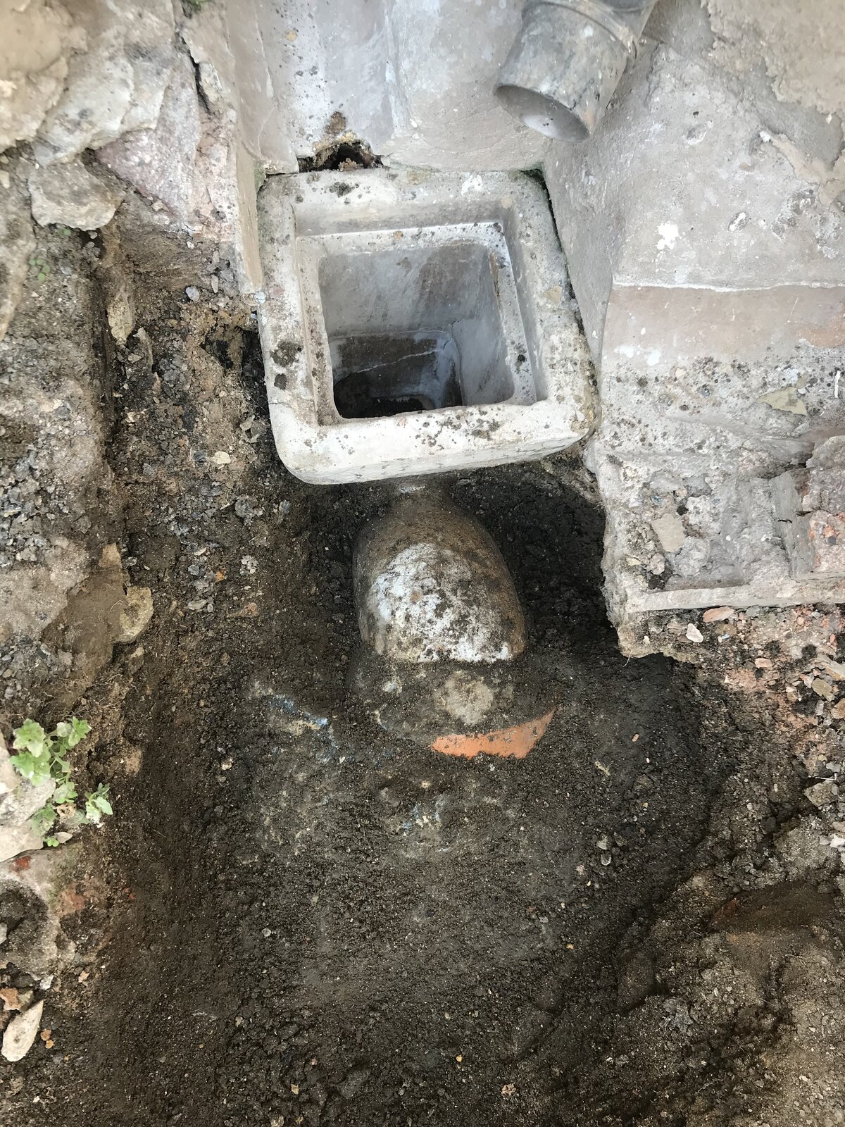

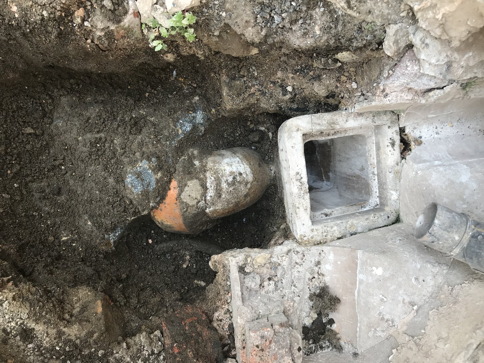

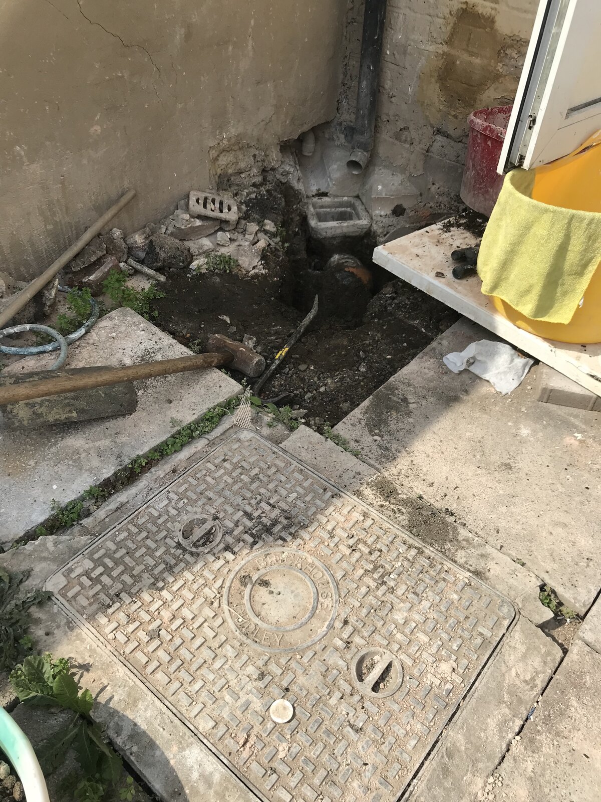

Latest update, dug a bit further and the whole thing is incased in concreate :(
I do t think I can do much without breaking into it and the clay pipe that’s in cased in it...
31C7B1A9-046B-437E-A0A2-841051FB9CEE.jpeg 0FD33651-9A99-417E-BE17-B15498730E8B.jpeg 25F9B0EC-8D25-47CF-9899-40C312F8E07A.jpeg

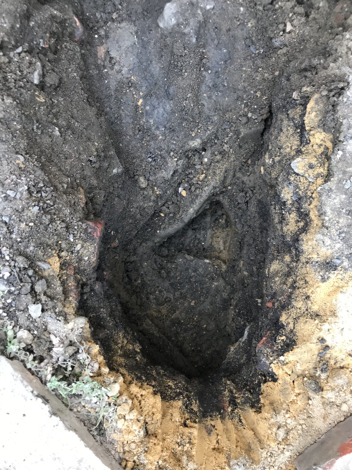

Looks like we also have issues further down - the clay is very wet. Which I don’t believe is normal.
It’s looking like we’ll need to break up the entire connection to the sewer section. Am wondering how we would insert a new pipe into that...

Can you stand back and photo the wall and it's pipework. also one of the open manhole to see depth and connections.
