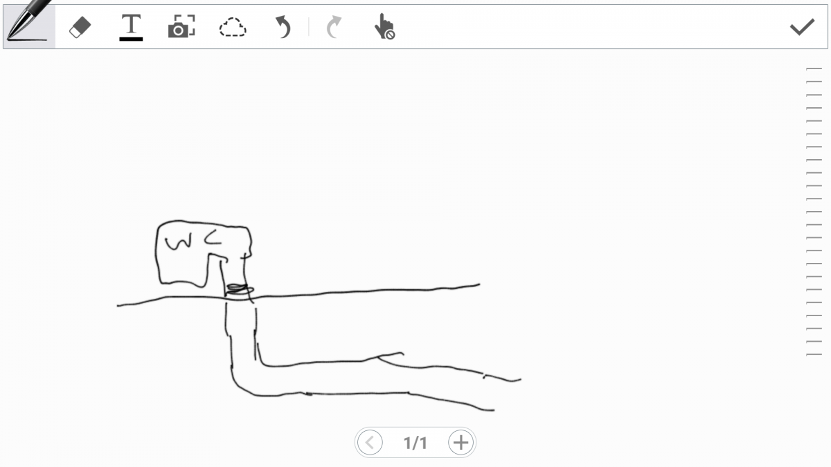

I'm in the process of doing my bathroom up and have a query I'm hoping you guys can help with.
The bathroom is located downstairs and I can not see any signs of a manhole or a external soil pipe. Other than two gullys outside. Which to me is quite puzzling.

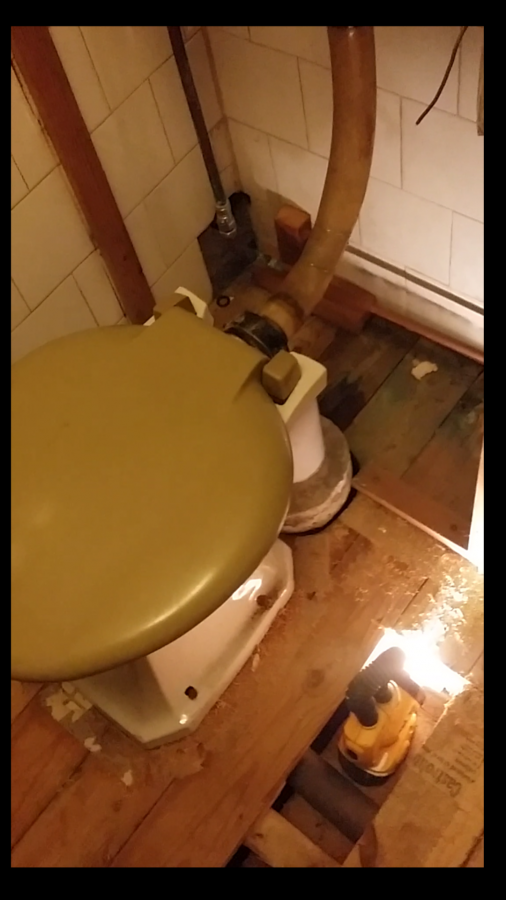

Currently the toilet is sat 30cm away from the wall and I was hoping to plumb the new one close up against the wall.
The toilet connects to a clay soil pipe directly below and has nothing else connected to it.
Does anyone know how and where I can find out the layouts of the drainage.
And also is there any specific adapters pipes I should used when plumbing the new toilet.
Also what's the best tool to use for cutting in the clay.
Many thanks in advance

Thanks Doggit.
I think it should be relatively straight forward cutting the pipe and sticking on a bend etc.
My concern is that the drainage in the house does not make sense to me.
There's a gully at the front of the house serving the kitchen.
There's a gully to the side of the house serving the bathroom sink
And there's a gully in the rear of the house serving the bath tub.
So there's definitely more drainage outside but don't know where it's leading.
The drain for the toilet has a fall going to wards the rear of the house (back garden)
Do you think local authority will have the plans?

If only. You will do well to work on those pipes under the floor, given the amount of room needed, what with floor joists etc. Also consider the failure factor particularly if the clay pipe is securely mortared through the wall. Take into account disturbing the tarred rope & mortar joints on the existing pipe run. Can you get the pipe where you want it in view of the joist positions etc.

The crawl space is a out a meter deep and the soil pipe goes vertically down to the floor of it and then bends of horizontally towards the back garden.
So I would imagine vertically I have a lot to play with.

A one metre deep void is... er... plenty deep! At least you will have some freedom of movement.
I'd look at getting the exact loo you are going to be using on site and tailor the vertical pipe to suit. We usually mock-up the loo somewhere in another part of a building, setting it up against a wall and with a pan connector attached. We then measure and set the pipe up to suit, particularly if the pipe is being concreted in. Take into account wall plaster thickness and ceramic tiles etc.
A lot of CC loos require the centre of the pipe to be aboot 115mm from the bare unplastered wall. But this is by no means a default setting.

Angle Grinder to (carefully!) cut the pipework, and chamfer the edges of the cut before fitting any adaptor collar to take you to plastic.

If it was me I'd make a box up and fill with concrete so that the clay bend is encased- then cut the vertical with an angle grinder. A vertical joint plastic/clay is less likely to leak than a horizontal one.

Just a update guys, I have successfully managed to cut and remove the section of the drainage I want to replace. The vertical section was encased with rock hard concrete! I would have thought a softish mix would have been enough but hey ho a beating with a kango done the trick!
