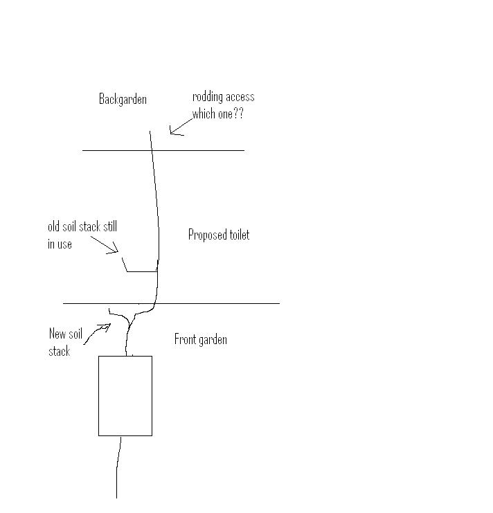

Does this help?
> Should i place a rodding access into the soil stacks?
> What kind of rodding access should i have in back garden? bearing in mind i need a gully there too for kitchen waste.
> and also the bend at the front may be (haven't tried yet) a hindrance for rodding through. What can i do there?
Thanks in advance

Cant quite tell from the drawing where pipes are going, but main factor is to ensure all pipework is accessible for clearance. Building regs allow a bend immediately outside an Inspection chamber, if that is the case I wouldnt worry too much. (Jetter will only struggle if the blockage is really solid, e.g. collapsed drain.)
Drains on your property are your responsibility, although shared drains (where 2 or more properties use the run) will come under the Water Authority remit in the Autumn when the rules change. Any work on drains that are your responsibility is down to you.
13 metres isn't a problem. If the pipe coming through the kitchen wall runs in a straight line to the manhole then fit a rodding eye on the end if desired.
