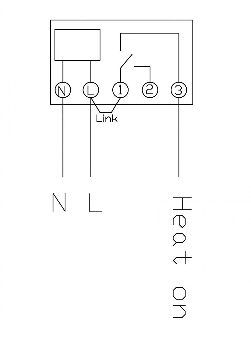

Hello,
I was wondering if one of you lovely people can be so kind as to help a neewb like me. I have been learning lots and I have almost got the rads balanced in my new house after cleaning with Fernox. Now to change the programmer....
Currently I have a Drayton Tempus 7 which is wired for JUST heating not hot water. I want to replace it with a Drayton Digistat+3RF which I ordered this morning.
Below are pics of the current wiring and wiring digram on the back of the tempus 7.
The wiring diagram for the Digistat is below:
Now Negative & Live are the easy bit. I assume ground can be isolated easily somewhere (hopefully that is clear when the unit arrives). But with the tempus 7 that only leaves one wire... "Heating On".
Do I just connect that up to pin 3 and leave pin 1 & 2 with no connection?
Correct, terminal 3 is the one you need, But on the Digistat you will also need to link the live terminal to terminal 1 (Common). Otherwise you will not get a live on terminal 3 when it switches on.
This link is made internally on the Tempus.
Congratulations on the clear and informative post BTW. Often there is insufficient information given requiring guess work & assumptions.
Excellent thank you Stem. So to achieve that I will need to add an extra brown wire from the live to terminal 1 to extend it out if you like?
I really hope this helps others too. :)
Unit was a breeze to fit apart from getting the three negative wires into one terminal . :D
