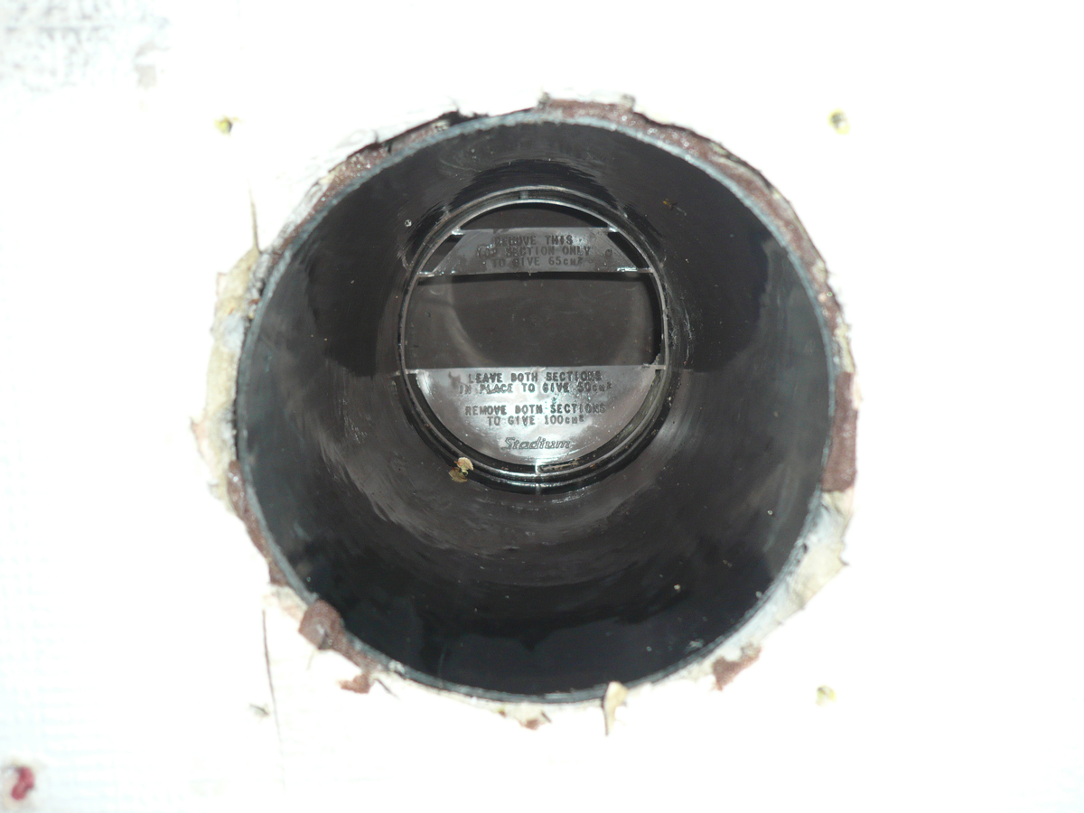

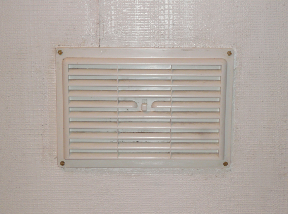

Hi all,
I've blocked off my apartment air vents due to a niggling draught. This is probably not the best idea as the air quality in my apartment now suffers.
Anyone know of any tricks or recommendations to having an air vent that is not draughty particularly now that it is winter here in the UK?
I do not own the apartment unfortunately but I am happy to spend with regards to resolving this problem.
Many thanks in advance.
Jason

Below is the vent in question in the event this is helpful. It appears it is not the best anti-draught design.
We are going round in circles.
Vent's vent, they are made to vent, vents = draughts.
No vents = Mould.
Unless you dry the air by other means (dehumidifyer) or reduce cold surfaces (upgrade insulation).
