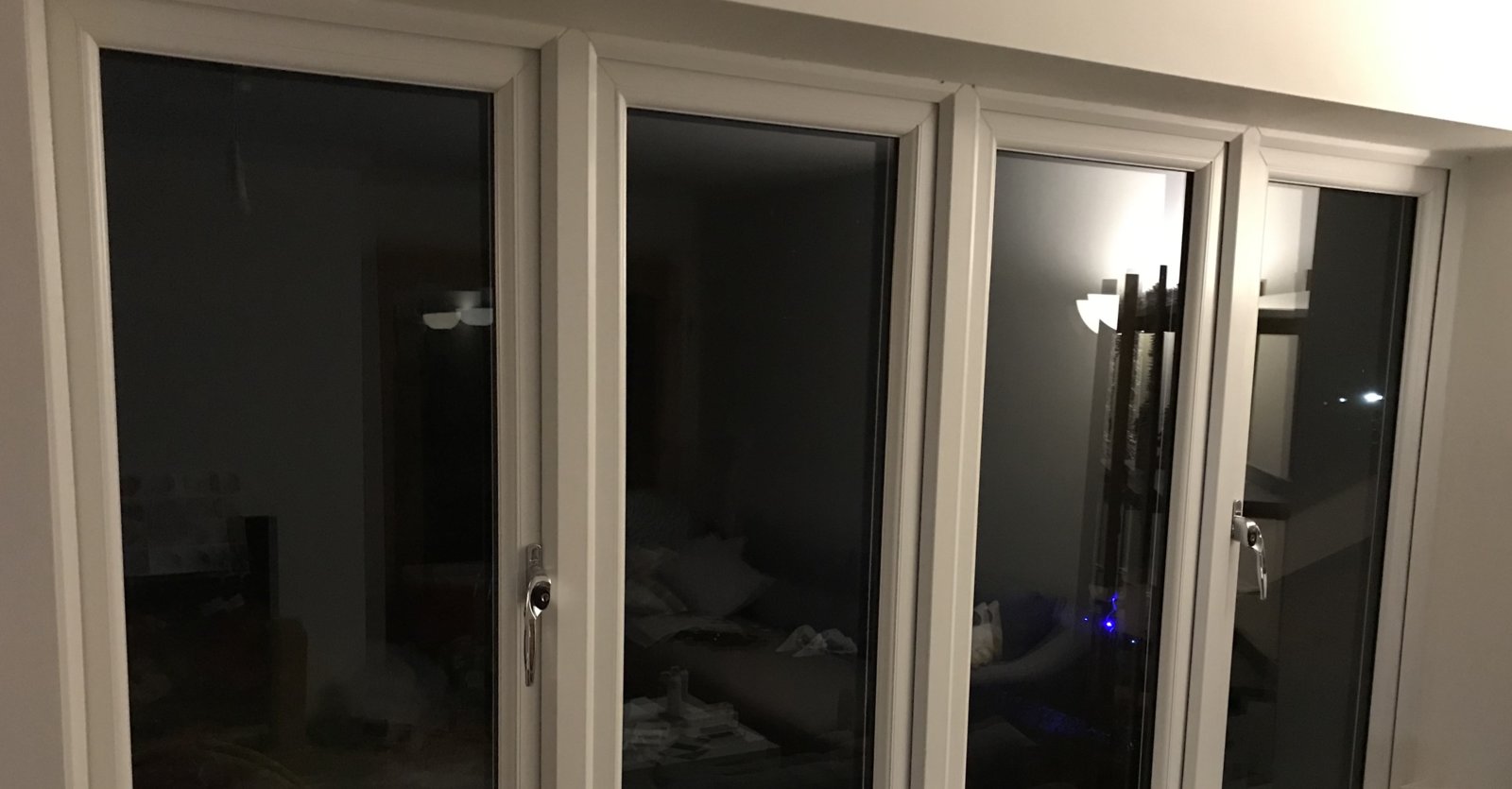

The double glazing in my house is around 8 years old and fitted by the previous owners. I find the windows noisey (from passing cars) and slightly draughty.
Is this normal or there anything I can do to improve the problem. The windows are synseal I think.
Thanks for any help and advice on this.

Sometimes the rubber / neoprene seals fitted to the frames and to which the moving sashes make contact with the frames can perish or become deformed to the extent that the seals become in-effective as originally intended.
On odd occasions the frame [especially older metal frames] can deflect and as such the movable sash does not make contact with the frame never mind the seals.
I have done a temporary fix to a situation such as the above and fitted thin compressible sticky backed foam to the frame and that has assisted a lot to reduce air leakage on that particular window.
Suggest you have a careful look at the state and contact of the seals and the window frames? Seals can be replaced ?
Ken.
I tend to agree in looking at the seals first, after 8 years I doubt they'd be perished but could of flattened off a little so a turn of the cams could help but this will only affect the lock side. Changing out the rubbers would be a none starter as its a co-extruded system(bonded gaskets). I notice though that the sashes are quite tall, these tend to bow out in the middle and do not touch the gaskets - check here first visually and then try and side some paper in, it shouldn't slide in easily or better still at all
Yes, they aren't perished but I wonder if they have flattened/crushed over the period of time. I can't notice any major draft from them but there's a definite coldness coming from them. IS this expected or do you think that something can be done to reduce this? I can't slide paper into the frames next to the gaskets. The gaskets listed on their site (https://store.synseal.com/c-2423-gaskets.aspx) won't work due to them being a co-extruded system (bonded gaskets) then? Thanks for the help on this.
