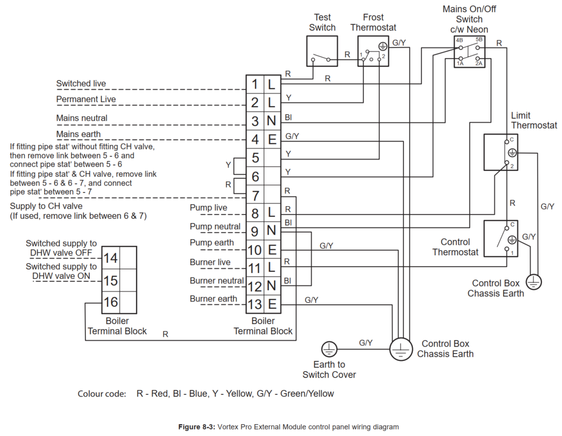

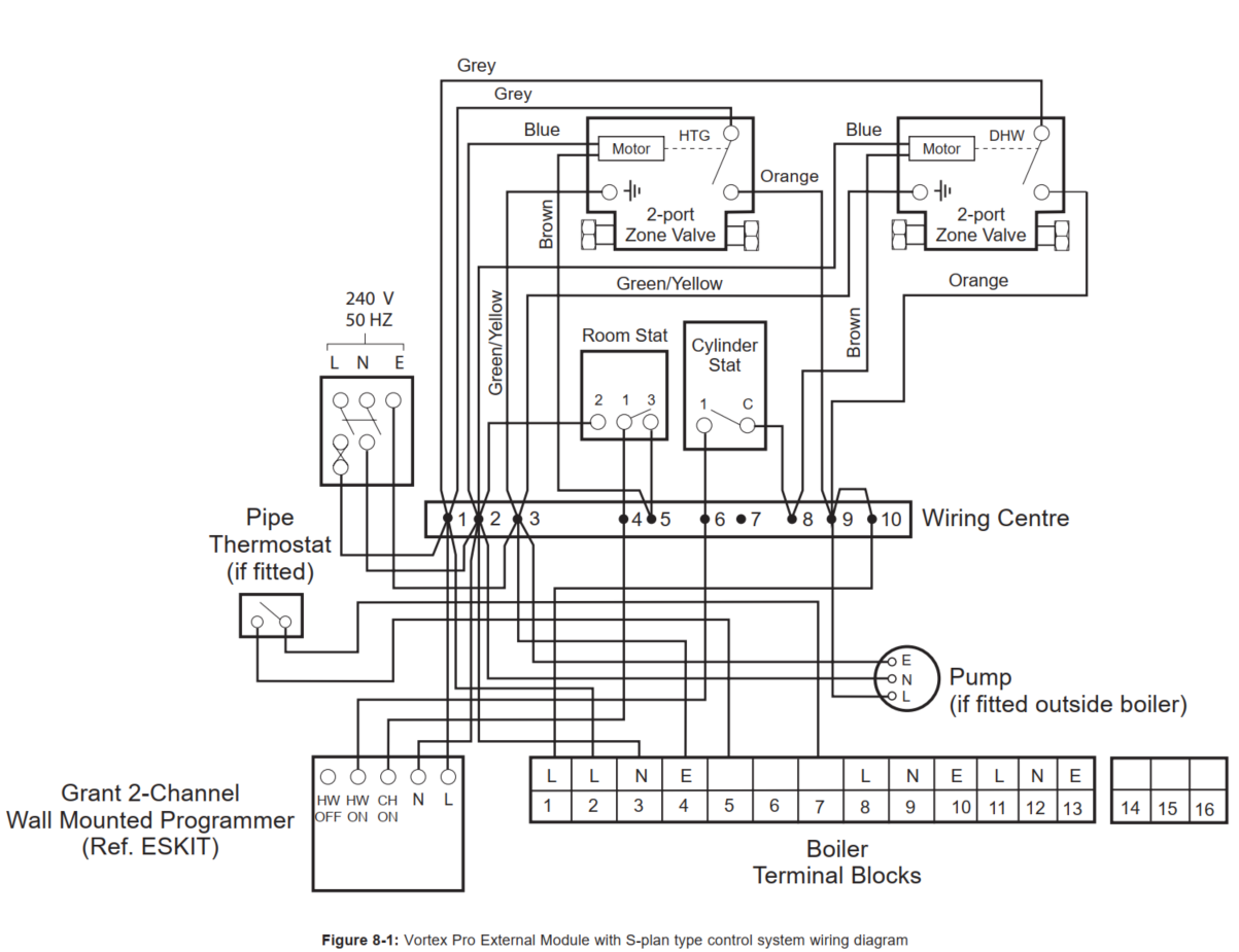

I had a chance to trace the diagrams for the boiler and it doesn't seem to me that the frost protection stat would (should) trigger the pump. See attached diagram ..
Whether that's exactly how ours is wired up is a different matter of course.
Also attached the internal module wiring, again I can't see how the frost stat would power the pump.

If you have a frost stat, then as the boiler and pump are fired from interconnecting terminals, firing one will fire the other. This is why you have a pipe stat in the circuit so that once the vulnerable pipework is warm enough, both switch off. Obviously if the pump is switched on then a valve must open to enable circulation.
The frost stat and pipe stat are wired in series to energise the Htg valve brown wire which will fire the burner and turn pump on. This overrides the prog and room stat. The pipe stat opens when the return pipe has warmed up
That would make sense but I haven't confirmed that this is how ours is actually configured. However if that's how it's set then it wouldn't cause the issue we're seeing which is the pump running with both valves closed.
There's an alternative configuration noted on the diagram which connects Live and Switched Live inside the boiler, and that configuration doesn't appear to open either valve. I'm not sure if the "CH valve" they refer to is an option in the boiler, or whether they mean the main heating valve in the house.
If fitting pipe stat without fitting CH valve then remove link between 5-6 and connect pipe stat between 5-6

The frost stat puts 240 on T5
The Pipe stat across T5 and T7 supplies the heating valve brown wire (Bypassing Prog and R stat) The valve opens and Puts a supply on T1 which energises Burner and pump.
The pipe stat which is on the return close to boiler, opens when pipe warms up thus removing supply to Htg valve brown, The valve closes and turns off boiler and pump. Simples!!!
This cycle continues until Frost stat is warm enough.
Thanks. Do you happen to know if it's possible to test the frost stat operation so I can see exactly what happens when it kicks in? Save having to trace all the wiring in both boiler and junction box. Because if our installation works the way you say then I need to look for another fault, something which brings on the boiler and pump with both valves closed.
I have seen frost stats and pipe stats wired to not open the zone valves and circulate via the by-pass, not the correct way to do it, but have seen it done that way, take the tamper cover off aand turn the frost stat up until it operates and you will see what it brings on
