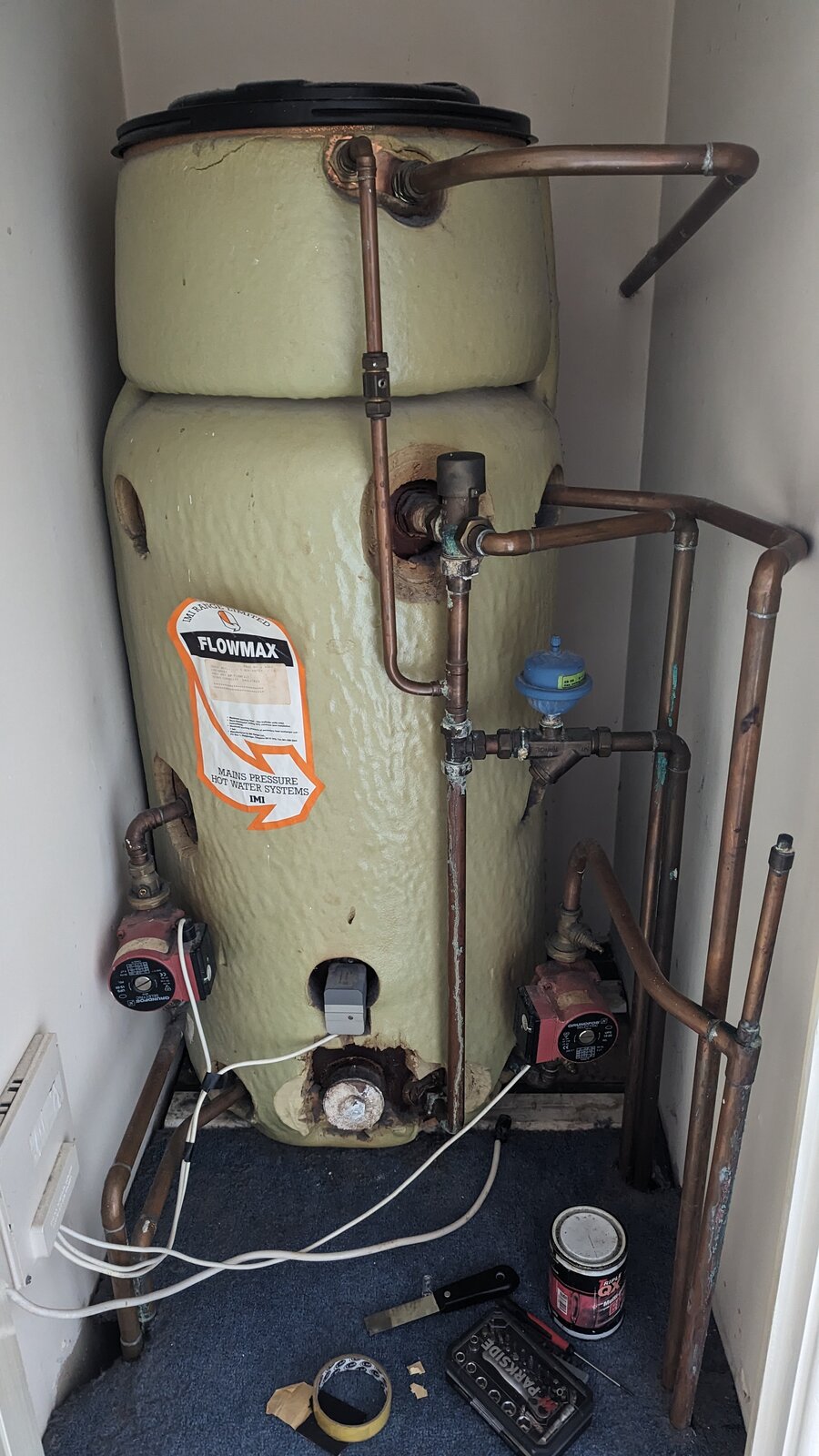

Attached a pic of the water cylinder. Like I say, this system is old and will be replaced soon, but for now, would love to get this working
Ok, so you don't have a motorised valve, you have a thermal store with twin pumps. Could be that one if the pumps isn't sending a signal, but I'm out if my depth as I don't know how these work

With a thermal store for the heating to work the hot water has to be turned on too, you can't have heating on on it's own.
Depending on which controller you have it would usually be set to gravity mode so when you select heating it automatically turns hot water at the same time.
