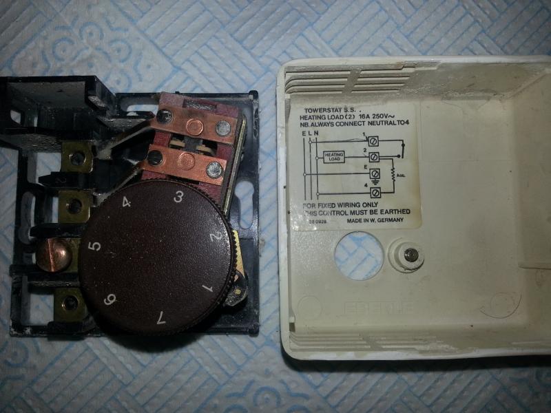

Ive just attempted to replace my old thermostat with a Drayton p710r

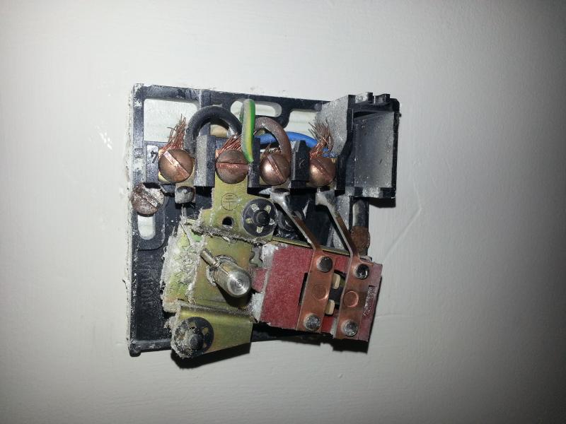

And i only seem to have 4 wires avalible one of which is earth
Wires avalible are , according to my past thermotasts wiring diagram
Blue... Live
Brown... Neutral
Black... neutral???
Earth.
The thermostat was connected up via a box of wiring to a programmer and the boiler.
Ive connected up the Blue to Live and Brown to neutral. And the black to Call for heat.
So that leaves me with common missing.
The boiler is a he15 non combi (naff).Please can anyone point me in the right direction,,,
Your wire colours don't make any sense. Which stat did you have before, and which terminals were the wires connected to?
You won't have two neutrals. It will have live, switched live, neutral and earth.

The blue and brown in 1-2 are the switching pair. put either near a neutral and you'll do damage to the boiler.
You really need to find the other end as I think you'll find brown is the live and blue is the switch live.
