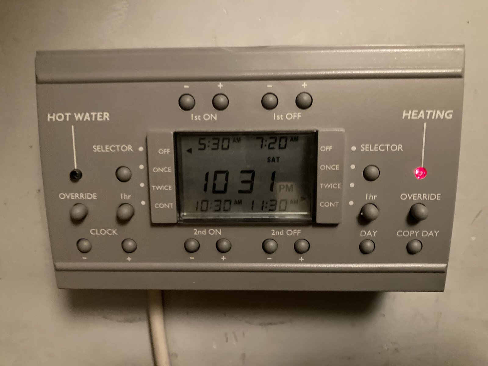

Hi there,
Found my way here through similar problems with the Drayton Tempus.
Basically everything was working ok until a flatmate messed with the settings recently.
I've posted a picture which shows the panel (the 2nd on and 1st off times are now flashing which they weren't before the meddling). I used to be able to get instant CH by pressing the override button but for some reason it will not work now. I'm guessing maybe a reset is needed but would greatly appreciate any help as we are relying on a small portable heater at the moment.
Thank you so much for any info/advice
You might need to remove the programmer to reset it. Should be clipped in or a small screw(s). I should point out to isolate the power first
