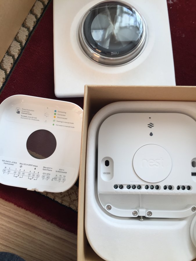

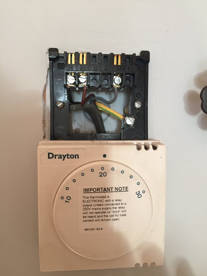

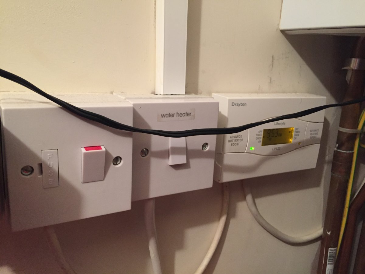

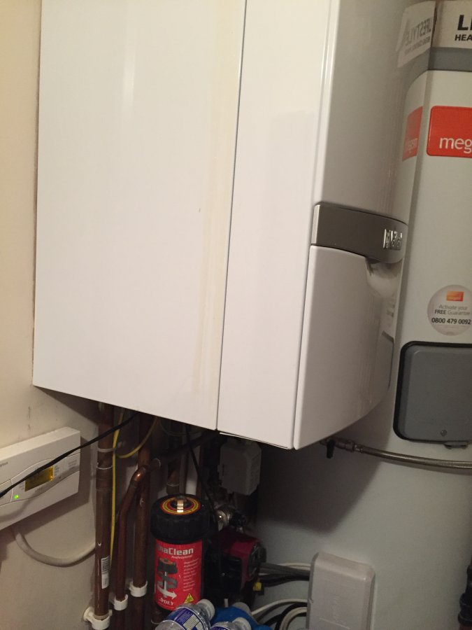

IMG_3266.JPG IMG_3268.JPG IMG_3267.JPG Thank you Stem for reply I'm posting some images I have 2 Drayton thermostats exactly same one upstairs/downstairs then I have Drayton programmer for megaflo and centre heating then I have Vaillant Ecotec Plus 637 system boiler
The plan is to replace existing Drayton thermostats with Nest heat link and nest thermostat I've bought two sets of nest for two zone controlled heating

OK, so you have two Nest thermostats, do you also have two Heat links, or just the one?

The Wiring to your Thermostat now is:
Black = N (Neutral)
Brown = L (Live)
Grey = 3 (Call for Heat)

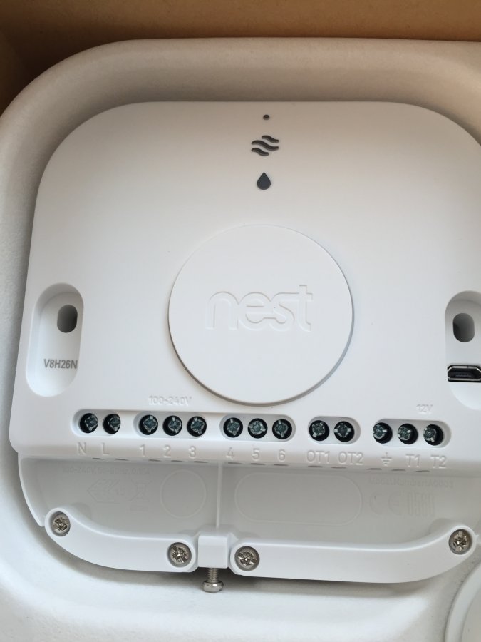

So at the Heatlink
The black wire should go to N (Neutral)
The brown wire should go to L (Live)
The grey wire should go to 3 (Call for Heat)
You will then need to add a link between terminals L and 2 (common)
The photo of the Heatlink you have posted is also one that also has control functions for the hot water system (terminals 4, 5 &6) which you won't be able to use. You will also need to set any existing programmer for the central heating to be permanently 'on' (or reconfigure the wiring at the programmer) otherwise it will override the Nest.
T1 and T2 can be used to provide power to the Nest thermostat, unless you are using a separate plug in power supply.
You could install the Heatlinks at the wiring centre, remove the existing programmer, and also have hot water control via the Nest, but it will be much more complicated. There is a model of Nest with two Thermostats and one Heatlink suitable for twin zones which would have been better if you did want to go that route.
