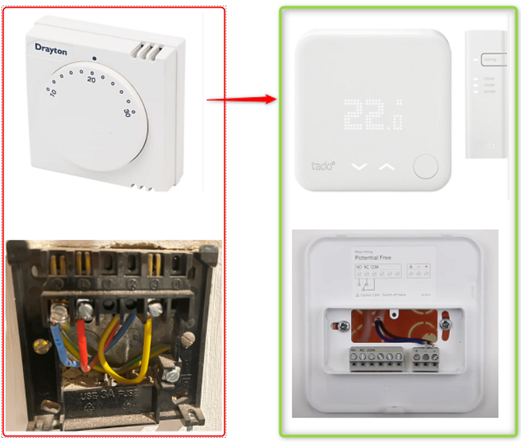

Hi all,
At the moment we've got a Drayton wired Thermostat to a TADO V3+ SMART WIRED HEATING THERMOSTAT.
The Drayton is a 3 wire installation and I could see in the tutorials that the Tado thermostat has only two cables.
How would be the way to change this? How would it be possible to install the new smart thermostat if it only requires 2 cables?
Is there any thermostat that is 3 wire so the set up could be the easiest?
Any experience moving from a 3 wired installation to a smart thermostat, will be very appreciated.
Yes the Tado is battery operated so no neutral is required. Isolate it safely out of the way, then, the Red and Yellow wires go to COM and NO

Yes, all smart thermostats with just two wires will be battery powered, but the batteries will last a long time possibly a few years and the thermostat will tell you when they require changing.
As your existing thermostat has 3 wires, you have the option of fitting a 2 or 3 wire thermostat in its place.
Nest is more difficult to install as it will have a 'receiver' that the three wires from the thermostat are connected to like this:
And a separate thermostat that needs to be wired using 2 wires to the receiver to get 12v operating power, or it can be powered by a separate plug-in USB power supply.
As your existing thermostat doesn't have any time control, I assume that there is a separate timeswitch / programmer somewhere. That would need either to be removed and the wiring modified at the timeswitch, or left in situ and set such that the heating is permanently 'on' and then the new smart thermostat would control both time and temperature functions.
If you have a heating system with a separate hot water cylinder [not a combi boiler] then the Nest receiver can control that too, but the wiring becomes more complicated.

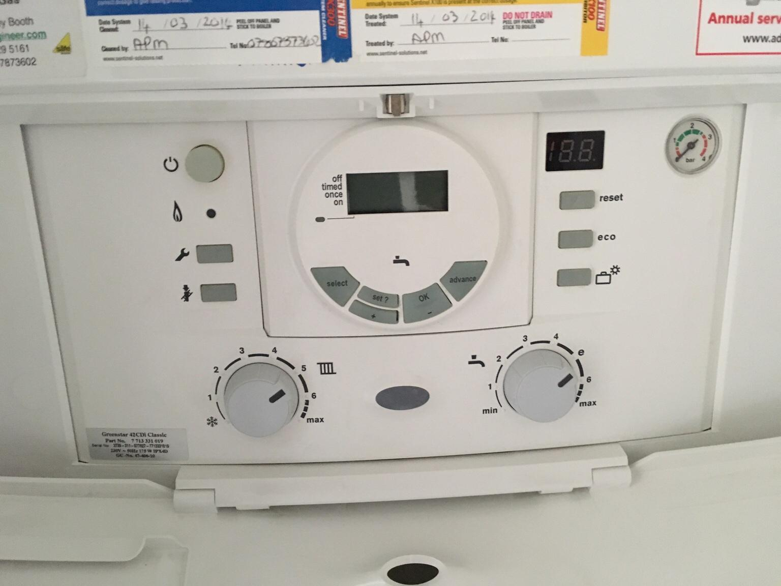

So my actual set up is a combi Worcester boiler that manages heating and hot water.
I have the thermostat to manage the temperature when the heating goes on but that's the only thing it manages.
The rest is managed through the boiler controls:
So it's a combi then, therefore the hot water control remains as it is. The CH would need to be set to be permanently 'on' at the boiler and then a smart stat of either the 2 or 3 wire variant :giggle: would use the existing wires that go to the existing thermostat. The new thermostat would then provide sole control of the heating temperature and time.
BTW, your boiler pressure looks low.....err very low....
