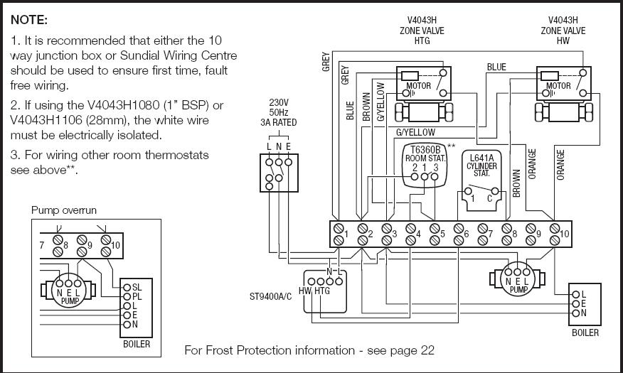

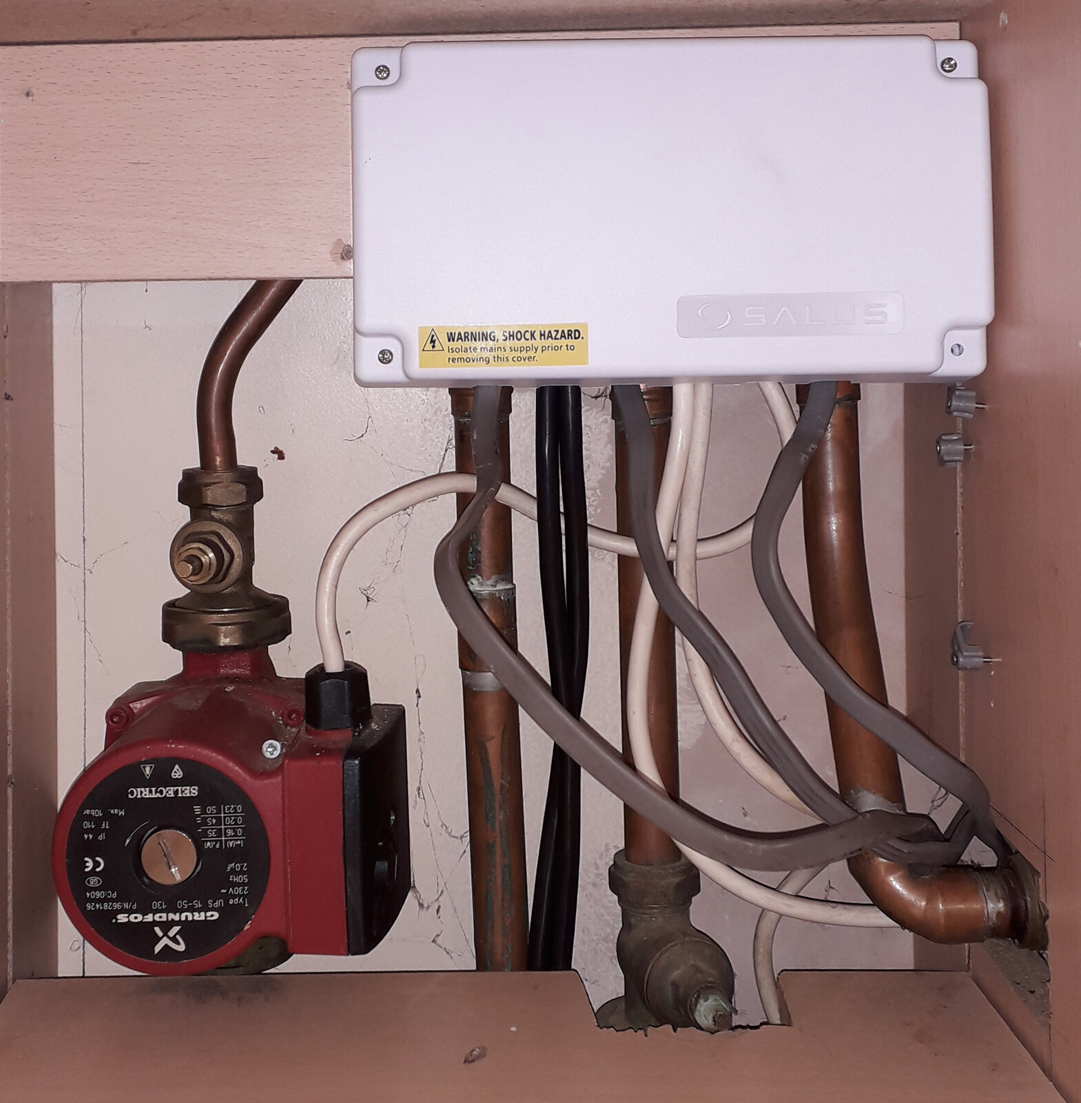

A S Plan uses standard zone valves, Grey and Orange to Micro switch, Brown and Blue to the coil, the two motorised valves are likely close together, likely you will have a wiring centre like these upper_wiring_centre_plus_heatlink.jpgSecond_Wiring_Centre.jpg where the valves or programmers are connected, and you will see the cable from the motorised valve 1664035664162.png the colours for this cable will be correct, as the valve comes with the cable already connected, so two of the browns need to go together, since only three valves even using trial and error it should not be a problem, clearly take a picture first, you put brown for upper motorised valve with the one for lower valve, and now only one zone.
