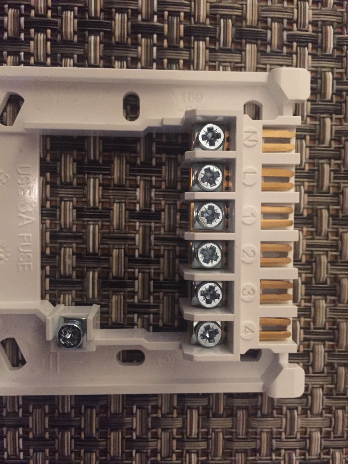

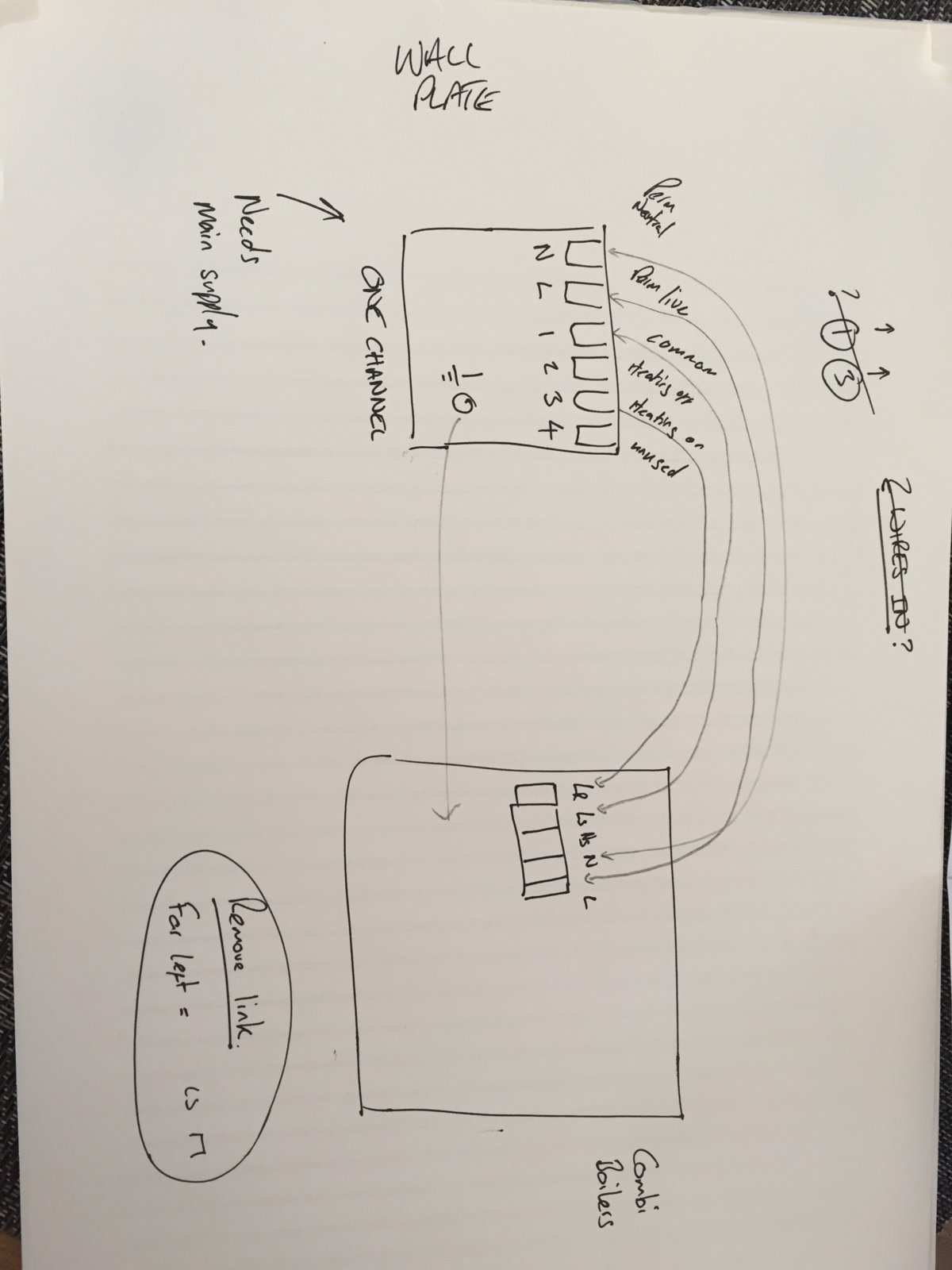

Hi,
Looking for advice to confirm how to wire up a new Drayton Wiser 1 channel smart thermostat to a Worcester Bosch CDI30. This will replaces an existing Drayton LP20RF dual channel digistat and wireless thermostat (easily removed).
As there’s no existing wall plate I need to wire this in.
Great to get confirmation of my understanding on the wiring for this (shown in my crudely drawn diagram)
Basically am I right in doing the following
From wall plate To boiler
N To N
L To L
Common (1) To Ls (Live switch)
Heating on (3) To Lr (live return)
Earth To Earth
I know I need to remove the bridge too.
Images of the boiler connectors and wall plate also included as might be helpful

Your drawing of the wiring connections as you show them would work OK. However, as Ls and Ns provide a 'Live Supply' and 'Neutral Supply' specifically for remote controls, I would connect it like this. It's easier than trying to get two wires in the boiler N & L terminals.

Thanks Stem. That makes a lot more sense to link the Live and Common (and a much smarter diagram to mine).
Thankfully no sealed parts to access in the boiler. The terminals are easy to access, just under a standard cover plate.
Appreciate the help!
