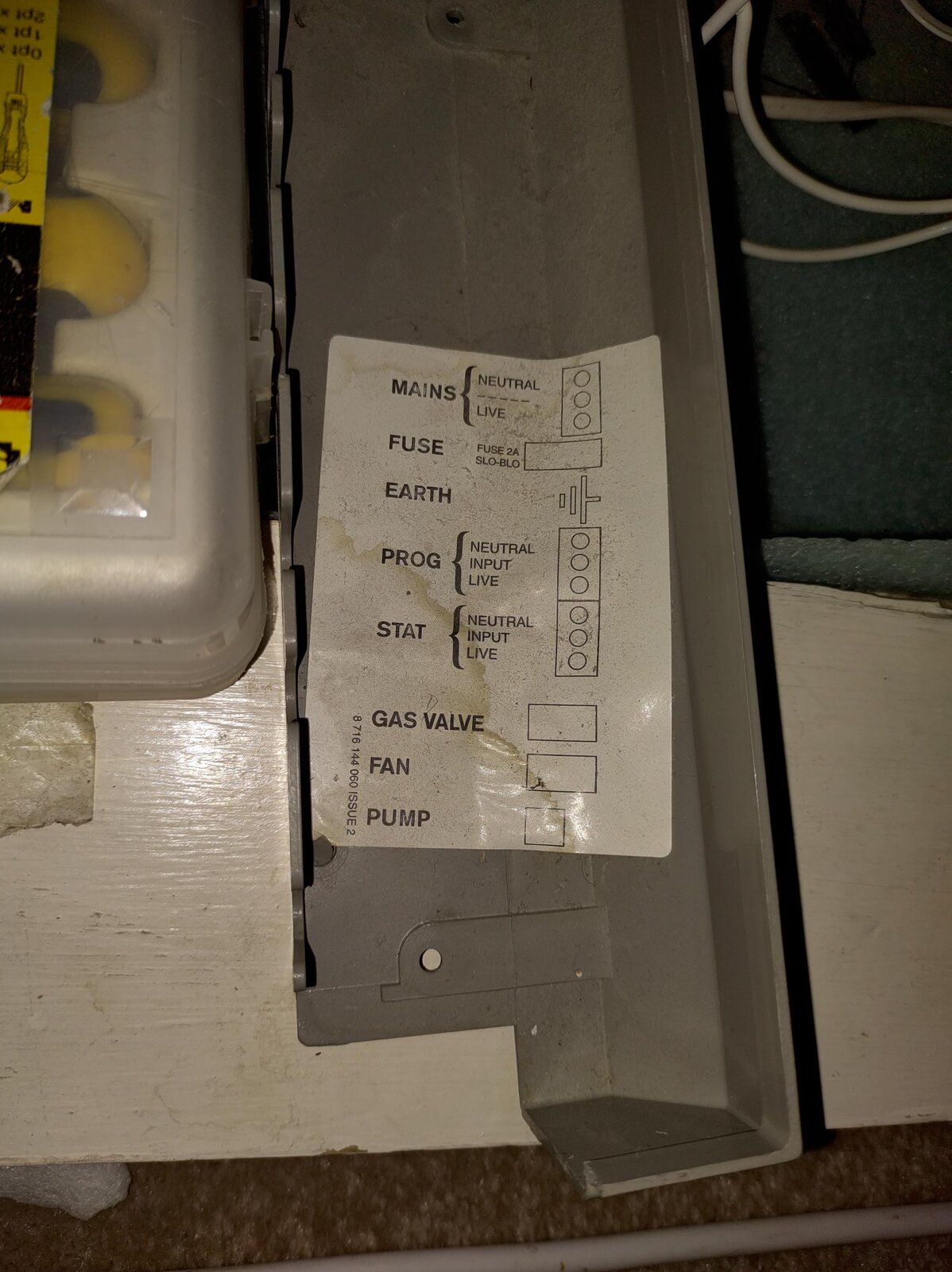

Hi,
I am trying to install a Drayton Wiser kit 1 on my combi boiler & I want to confirm the wiring as it is an old boiler - attached is the wiring diagram for my existing setup with a room thermostat and a mechanical clock & below is what is required for the Drayton, I can take the neutral & live from the fused spur on the boiler so no issues there, I want to remove the stat and the clock from the boiler so if I remove the wires I assume I will then wire the 3 lines from the prog section of my boiler to the Drayton but does this sound correct.
Prog Input to Drayton com 1
Prog Neutral to Drayon off 2
Prog Live to Drayton on 3
Is this correct or is there something else I am missing ?
Thanks in advance

No that does not seem correct.
The Wiser itself is powered via the N & L terminals. Any connections (bar N & L) will only go on terminals 1 & 3. Terminals 2 & 4 are unused.
But check very carefully before making any connections. As Mister Banks indicated, model of boiler would be helpful. Can you provide a picture of the current wiring currently in place to "PROG" and "STAT".
As for the room thermostat, whilst you are verifying the Wiser is working ok the easiest is to turn it up to max. Once you are happy all is well your existing thermostat can be eliminated.

The Wiser itself is powered via the N & L terminals. The remaining steps depend on Combi boiler type, is its 240V or potential free switching. Any connections (bar N & L) will only go on terminals 1 & 3. Terminals 2 & 4 are unused.
Based on the picture you have posted, it seems the boiler is 240V switching. On that basis, Neutral & Live go to the N & L terminals. Then a link wire from L to 1, then the "input" wire to 3. But check very carefully before making any connections. As Mister Banks indicated, model of boiler would be helpful. Can you provide a picture of the current wiring currently in place to "PROG" and "STAT".
It is a worcester 28i rsf combi - I am at work at the moment so can't access the wiring but can do this evening.
Can I leave the thermostat connected whilst the wiser is there as well ? I assume from the conversations that the above would be wired to the stat and not the prog as I had initially said ?
Thanks again
From what I can see the PROG and STAT connections just work in series. If both are "closed" the heating is on, if either are "open" it's off.
You can leave the existing room thermostat in place (& turned to max), the Wiser would the go into PROG. Or equally leave current timer in (& set to permanently on) and Wiser goes into STAT. That said you should bridge PROG or STAT and Wiser goes into the other.
You can leave the existing room thermostat in place (& turned to max), the Wiser would the go into PROG. Or equally leave current timer in (& set to permanently on) and Wiser goes into STAT. That said long term you should bridge PROG or STAT (either prog live to prog input or stat live to stat input) and Wiser goes into the other.
retracting what I previously said in an earliest post (which I've now corrected).
Assuming you used the PROG interface.
PROG_live to Wiser #1
PROG_Input to Wiser #3
with no link between Wiser L & Wiser #1
HI,
So if I want to remove existing Clock & Stat I would wire as such
Spur Neutral - Wiser Neutral
Spur Live - Wiser Live
Prog Live - Wiser #1
Prog Input - Wser #3
Stat Live - Stat input
This will allow me to remove both the clock & Stat from the boiler & use the wiser system in place of both?

see my updated reply. But your response is also OK.
Apologies for the delay - I hit my peak at work and things went a bit crazy, I have only just had time to install this last night, it works perfectly thank you all for your assistance!
