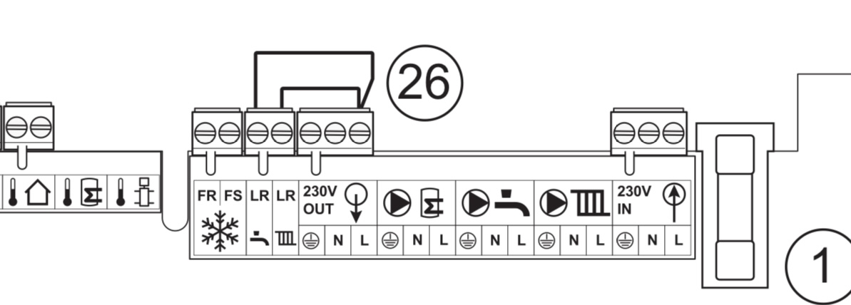

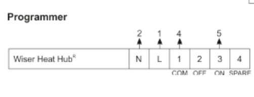

Looking for some help. I’ve just installed a Drayton Wiser hub in my house and ran a 5core from the hub to my Worcester Greenstar Heatslave boiler.
The connections aren’t clear to me, just wondering g if anyone can state what the connections should be?
Thanks!
Your Heat slave 26 LR to 3 on Wiser this
shows the 4 connections with the link removed, you will need a link on wiser L to 1 but the Wiser you show does not seems to do domestic hot water so that will need to remain linked. Earth has a tag on the wiser.
