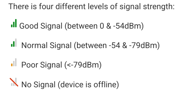

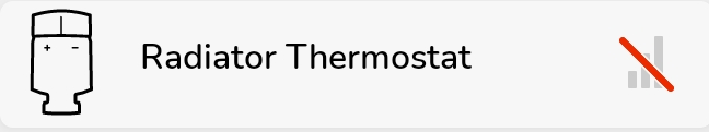

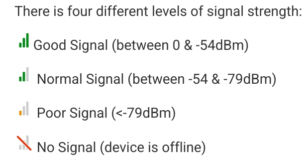

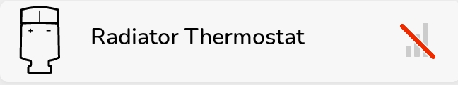

1743013510535.png Battery full, No Signal 1743013652856.png It seems Zigbee, and each device relays to next, I have Zigbee elsewhere in the house, but does not seem to be connected to Wiser.
Can I combine the two Zigbee systems?
The Wiser TRV’s and room thermostats do not act as zigbee relays, you need a mains powered device to act as a relay (Wiser smart plug or electrical heat switch for example). The Wiser zigbee network can not be combined with another zigbee network.
I took the wall thermostat to where intend to put the range extender, and it worked, so don't foresee any problems. Worst room in the house, faces Northwest, has two windows, and above the dinning room which is hardly used in the Winter. My hope is, if that room is warm, then the boiler running long enough to ensure all rooms are warm enough to turn off the TRV head in their room.

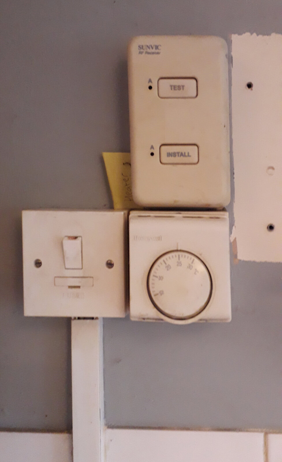

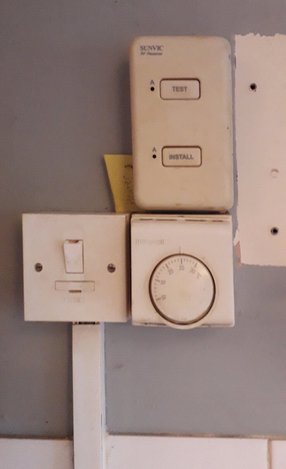

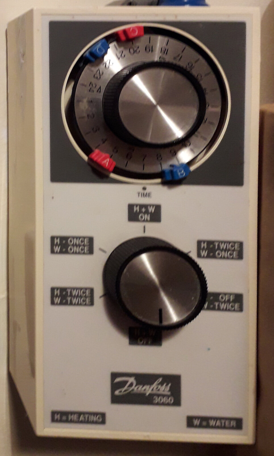

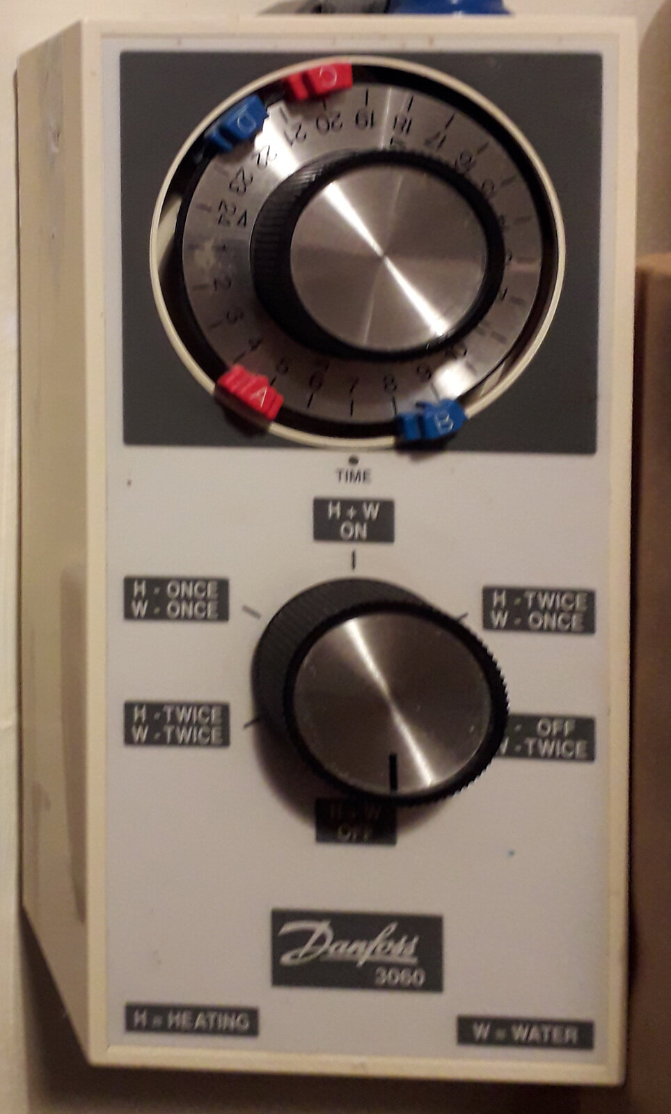

I made a miscalculation when I installed the first thermostat, wires went to the hall, were sticking out of the wall, so assumed the thermostat had been in the hall, found the receiver, 20190619_063642.jpg but no thermostat, the one under the receiver was for flat under house, not main house. There was a programmer Danfoss3060programmer.jpg but found only 2 wires of the triple and earth had continuity, and also changed from red, yellow, blue, to brown, black, grey, so somewhere there must be a joint. So seemed prudent to use extra low voltage, so installed Nest Gen 3. However, it seems the hall is the slowest room in the house to cool, never considered cooling speed, heating speed you can adjust with lock shield valve, but cooling speed nothing one can do.
