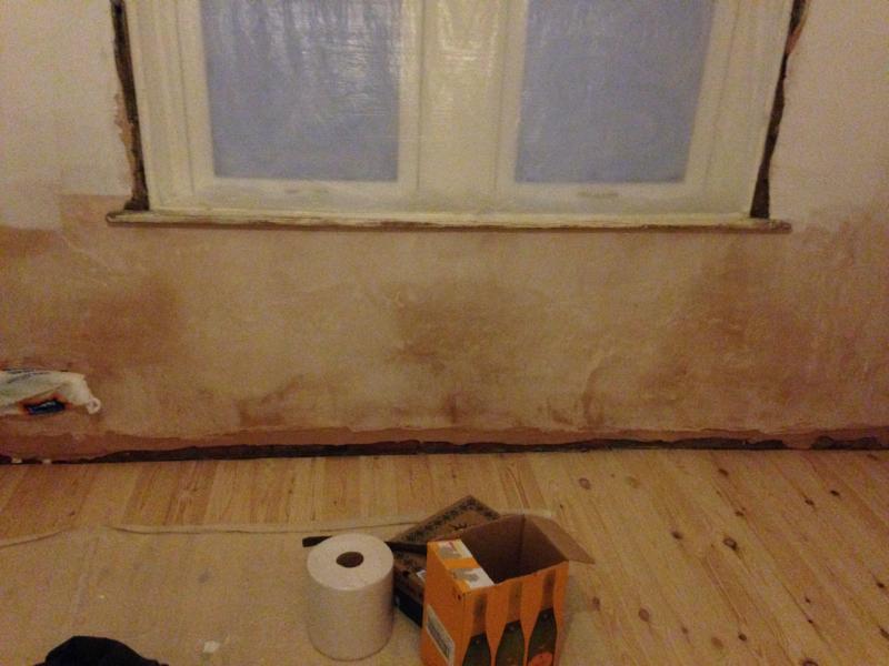

I had the front room skimmed around 8 weeks ago and we have been waiting for 1 wall (only external facing wall in the room) to fully dry out. This area in particular was taken back to brick so I assumed due to the cold weather it was just taking time.
Any ideas what this could be? Please see the picture. To be fair I took this this morning and it was fairly dark outside still so the camera makes the patches out to be slightly darker than they are. I'll add another picture this evening. Some of the darker streaks towards the bottom are actually where the skim is really thin and showing render colour.

I added some direct heat from a fan to the area last night and it seemed to clear up nicely after a period of time. This morning it looks to have re appeared but somewhat less apparent as before. Picture below.

don't use a heater to force dry plaster. it will make it crack.
There has to be something causing the damp.

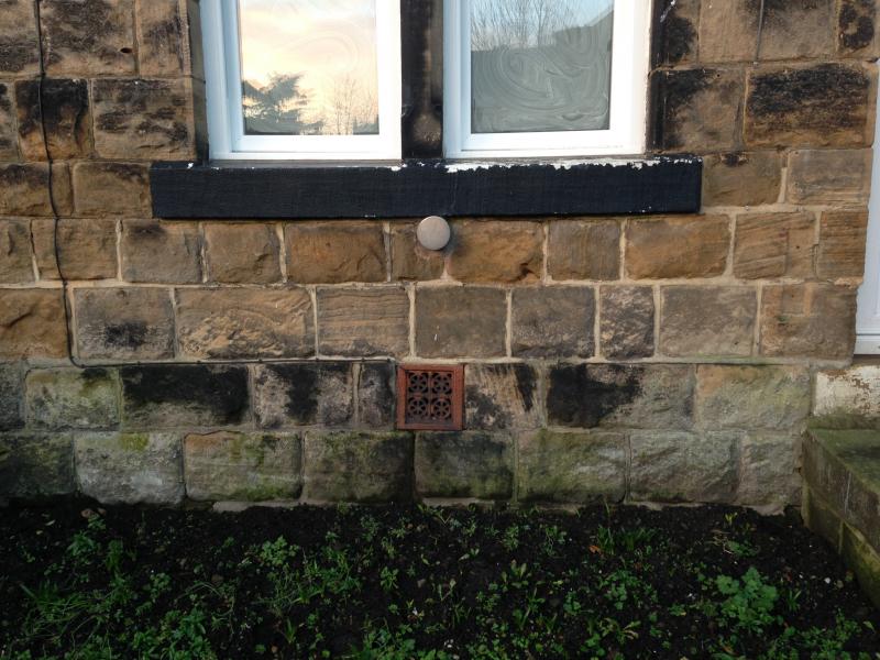

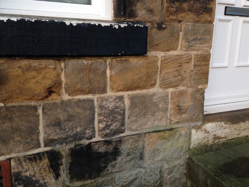

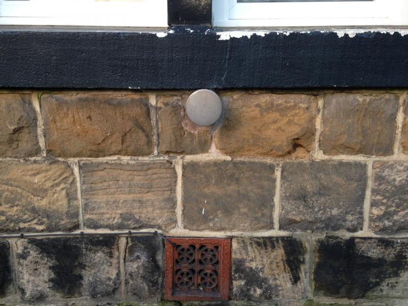

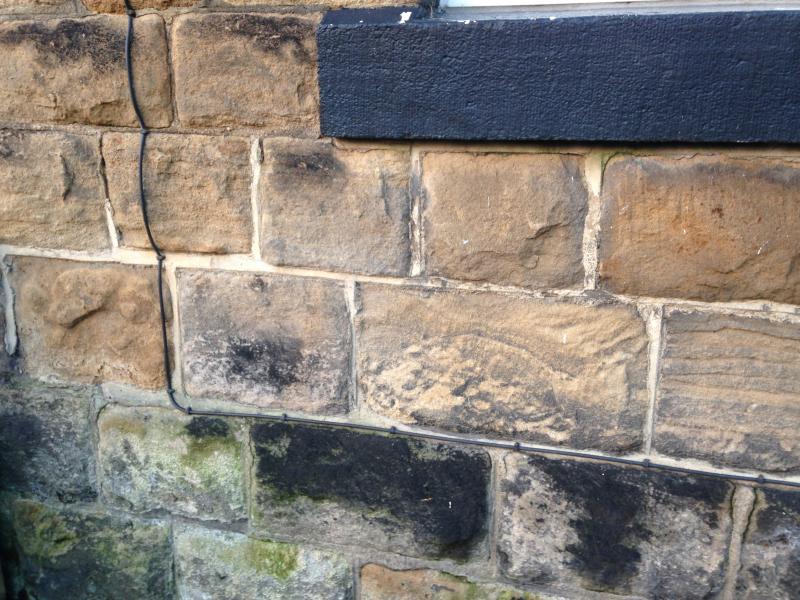

Thanks for the responses, here are some pictures from the outside. I'm thinking it's no coincidence that it looks like the pointing has been touched up on all 3 areas that are patchy inside. The internal floor level is level with the door step and directly above the air brick. I've only been in a year and didn't have any involvement in the pointing. It looks to be sand and cement rather than lime.
On the centralised picture there is a stone to the right that looks to have a crack but this is just a surface crack and the image shadow makes it look worse.
Cheers
Paul

On the basis of the text and the pics there are no grounds for saying that the "damp proof course is gone". Neither does a bitumen DPC wear through after 60+ (or a 100+) years.
Bitumen squeeze out snot(s) can be seen to the right of the air brick.
The pointing, as the OP has noticed, is the most likely culprit for penetrating damp - the pointing should be raked out to 20mm to 25mm and re-pointed in lime mortar.
Check the sill for a throat? Best practice, the sill should project a min of 50mm.

What is the circular metal device below the sill?
