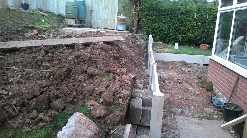

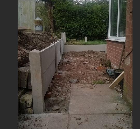

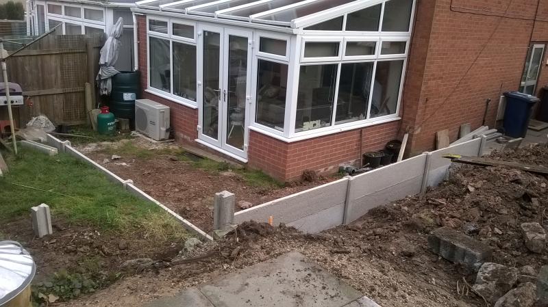

big-all, this is the wall in question :)
the bottom bit all around the conservatory will be the decked area.
Both retaining walls will hopefully be faced with vertical decking boards and topped with sleepers....somehow.
Might add a full length 'step' on the shorter of the 2 walls.
The top bit will be levelled and re-turfed.
