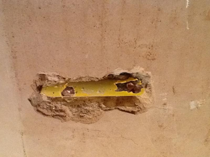

Hi all,
Ripped out my kitchen to make way for it's replacement. I have a lot of prep to do before the fun of fitting the new kitchen.
The previous kitchen was fitted before we owned the house, they did a good job of damaging services. I've uncovered drill damage to the ring main (damaged sheath of all cores of 2.5mm t&e) and also looks as if someone has almost drilled right through the 15mm gas pipe supplying the cooker.
Until I fitted a new bathroom (room above) I wasn't aware the kitchen was serviced by gas. Now that I've ripped the units out I have found a small capped 15mm pipe poking out the wall, following up the wall a drill hole.
I knocked some plaster out and cannot see any piercing or have ever smelt gas, no fixing was in the hole.
What do you suggest?

It wouldn't be too difficult for a gas man to cap the pipe in the wall. There would be a hole in the plaster but if it's behind a unit that's less ag than a hole in the ceiling.
I wouldn't leave the pipe you've shown, live.
And mark the wall to show there's a pipe, for the next kitchen fitter...

Before you do anything else ring this number 0800 111 999
they will check it for free and cap your meter if it is unsafe
