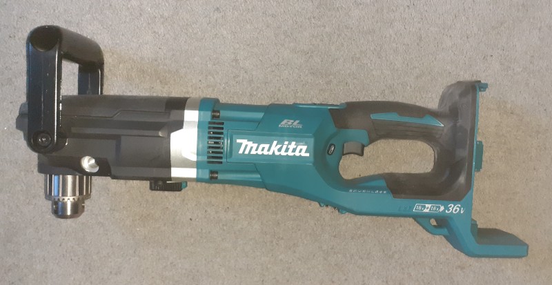

AFAIK it has a clutch (without one it might be a bit dangerous). Not as powerful as this baby, though:
Makita, of course (DDG460) - with 136Nm of torque. I think the OP may be looking for something a wee bit less spendy than the thick end of £350, though, without batteries or charger. Goes through beams a treat! (although you do need the additional side handle)
