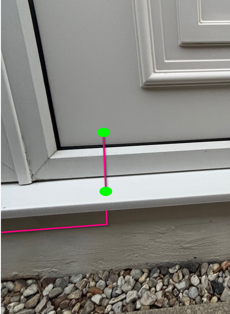

Hi all,
This is my first post, hope you can advise please, as my DIY skills are rudimentary at best!
Openreach are installing full fibre for us next month, which is proving to be a logistical nightmare due to living in an old, single storey cottage with side conservatory (no walls below), coupled with the necessary BT overhead cable height and routing.
To continue having broadband, which we rely on heavily, we know we have to proceed. All BT copper lines will cease by 2027 at the very latest.
BT/Openreach do not discuss cable routing until the day of install, so I’m having to think of the most serviceable cable route for the fibre, should a problem occur in the future. They cannot follow the existing copper line route. Routing a cat5 cable from anywhere other than the conservatory, where the current copper line terminates and current, but old copper tech router resides is very difficult/risky too. As it would mean breaching the void between the kitchen and conservatory - I don't want them/me to cause any leaks and create a bigger problem.
It is most likely, the only route we have, is to bring the cable through the conservatory sill and panel (see photo). But we do not know for certain if BT will agree, although we do not see any other workable option.
To allow the cable through, ideally we would need to drill a 12mm hole both in the sill and the panel (shown in green). Would not be drilling through any of the conservatory frames.
Is this something we could do? without damaging/cracking either the side panel, sill or both? If so, what are the best tools, drill bits to use please?
Many thanks.

Do you mean 12mm is too big a hole to drill through UPVC panel and/or sill - or 12mm seems too big a hole for the fibre cable?
Item 4 of Openreach faq; "Just a heads up, we'll need to drill a hole through the wall to enable us to connect the two boxes. If you're renting the property please make sure you get your landlord's permission for us to drill a hole. This will be 12mm wide and you can tell the engineer where you'd like them to drill."

That'll be an oversized masonry bit so it's easy to feed through the wall. That looks a terrible place to fit a cable, post some pics of the full elevation - people may have better suggestions - eg in the corner where it meets the house

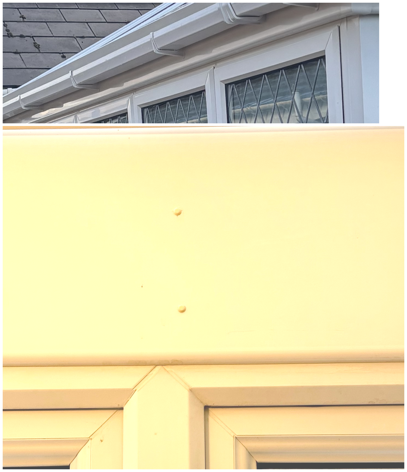

Totally agree, one I would avoid if a maintainable alternative is possible. The current BT copper cable enters the house, but this is into a crawl loft space which I helped run years back, as BT/Openreach would not run the cable and do not maintain that part if there is any issue - and I'm not getting any younger! But this is something I will take another look at. Out of interests, looking at the UPVC gutter mounts, would it be possible for me to drill a 12mm hole through this, as I notice for the gutter mounts, they are plugged on the inside. What would I use to drill a 12mm through this? Thanks.

Have you got a full picture of the conservatory and maybe we can come up with a different idea?
That's the fascia on the outside and trim on the inside, with probably a timber "wall plate" in between - you could drill through this with a 12mm HSS or wood drill bit (whatever's cheapest if you need to buy one) make sure whatever you get is long enough. Drill from outside at an upwards angle and seal with silicone (the installer should do that).

Don’t understand any of your concerns , they can install thru any of your external walls .

Hi all, thank you for all your thoughts and comments - its does very much appear to depend on which installer turns up to do the work. Whist not the easiest and means going into the loft space I'll follow the existing copper cable route, as I know this is the tidiest and least obtrusive.
