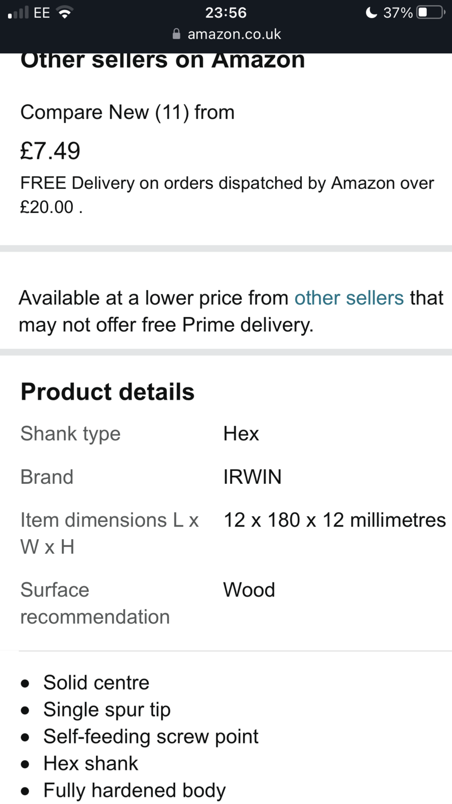

OP link shows 180mm length.
It says "Dimensions: 12 x 180 x 12mm" which is the size of the packaging (tube or box) it comes in. The auger bit size at the top of the page is clearly stated as "Irwin 105027385 5 x 150mm Auger Drill Bit", or the dimension is a typical misleading Amazon description. BtW how does a 5mm diameter hole get drilled by an 8mm bit? As the FFX site states, "Length 150mm, working length 73mm"...
