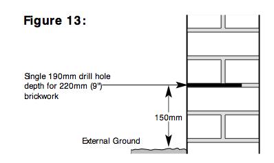

I'm going to inject Dryzone. I started drilling and was only able to get about half way in before the walls started bleeding red dust. What I'm thinking is the inner wall doesn't match the outer wall. So I drill through mortar on one side and into brick the other. Dryzone says to drill into mortar and inject into that. Every time I drill I get half way and the wall bleeds red.

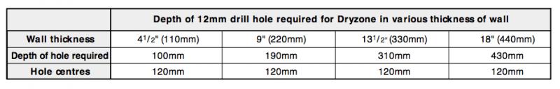

How deep are you actually drilling?
190mm based on the Dryzone guidelines for a 220mm wall.
I don't think our wall looks anything like this;

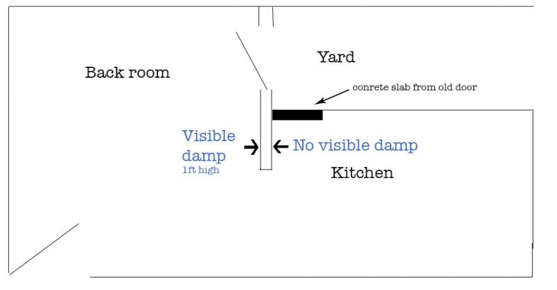

Something I just noticed was the internal back room wall has visible damp but on the other side of that wall in the kitchen there isn't any. I don't understand why damp would come in from outside and only sit in that one side, not both.
The bricks outside all look dry.
It may well be your drilling at a slight angle. Have you checked under carpets etc is there any pipes running underneath?
No carpets. Just laminate. Looked like a solid concrete floor when we had laminate put in.
Spoke with Dryzone people and they said just do the holes closer together to be safe.
