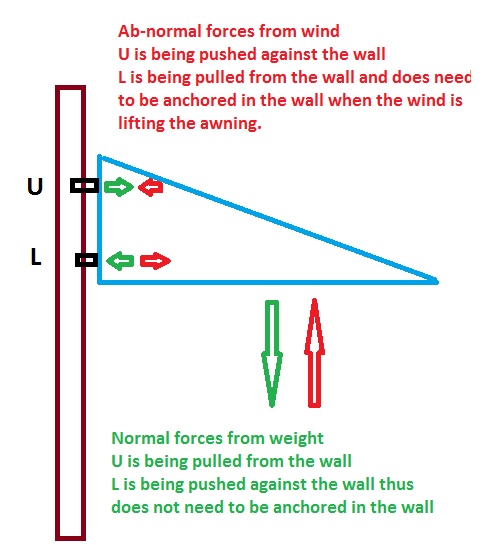

Those awnings can impose a substantial lateral load on a wall- be wary (there's an article on here somewhere about a gable end wall being collapsed by one, though think that was a big cantilevered thing).
Is any of the brickwork visible below the render (so you can see what height each course is and where the perps are)- if you can then it's tape measure and plumb line time and hope the brickies were good. Test holes would work but drill them where they'll be covered by your awning batten or framework or whatever- test holes also won't tell you how near the edge of a brick you are.
I must admit when I first started looking at them I thought to myself that the load on the brackets would be very high. Especially as some of these awnings extend out a good 2 or 3 meters. My entire wall is rendered and there are no bricks visible. I may look around to see if there are alternatives...
In some locations the wind loading has to be considered as well. The force from wind against the awning can be several times the firce due to the weight of the awning
The force of the wind has nothing to do with the weight of the awning.
He's inserting an imaginary comma between 'firce' (sic) and 'due'. If you read the sentence straight through without the imaginary comma then it is grammatically odd but factually correct.
That looks like the wind load is cancelling the weight load, so the thing will just float there. o_O
