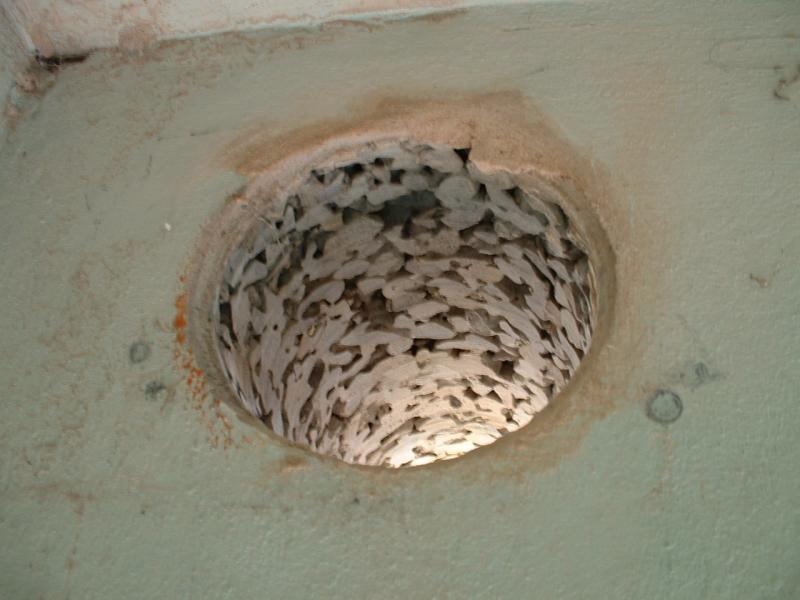

Council in about 2003 cut this 135mm diameter hole thru no fines wall. I would guess great accuracy was not important in the position of hole.
You won't get accuracy with no-fines walls unless you use a core drilling rig bolted down - within 5mm is about the nearest anyone can normally get! Horrible stuff!
