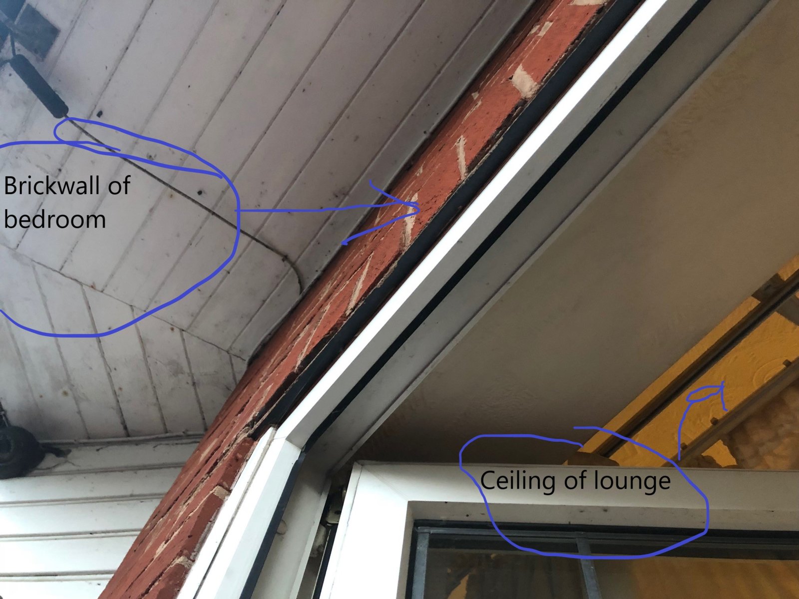

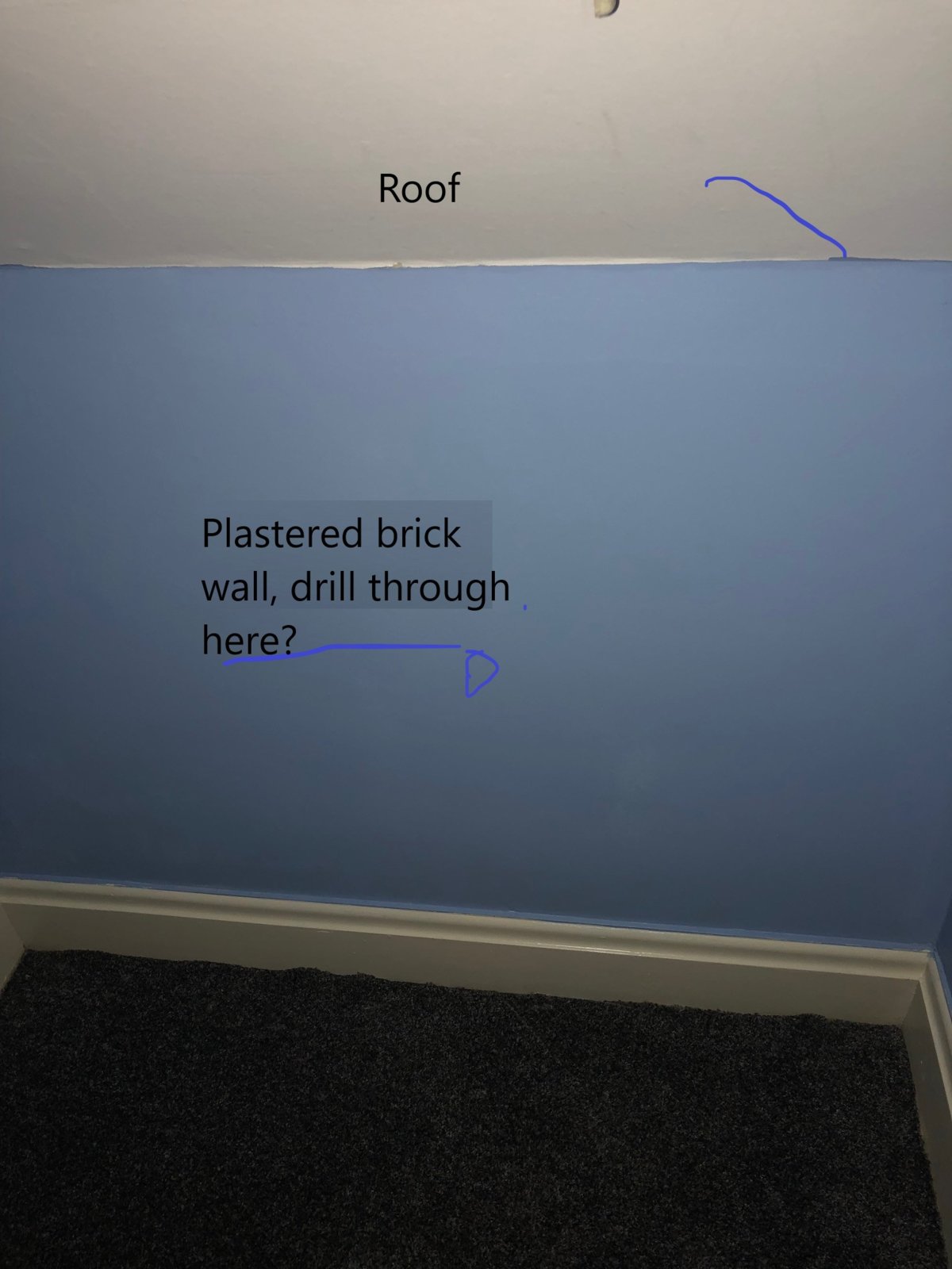

This sounds like a simple question but I live in a 1930's house and in one of the rooms we have a cctv system, current camera wires go through the roof into the loft and then come down the ceiling. I had to get some guys in to do this. Want to put some more up and seen that an easier way would be to drill through the wall and thread cable through. The house by the way has dormer eaves. Looking at the pictures am I right in thinking if i drill through the internal wall it will be two bricks with an empty cavity inbetween? It would be easier for me to drill from the inside. from the pictures you can see that the lounge ceiling (bedroom floor) sits lower than eaves and assumming that the space above the window directly under the roof/eaves is the other side of the bedroom wall in the other picture. Advise please, is this simple?

Cheers Ian yep will drill from outside then, would of been easy to drill crouched down in bedroom instead of up some ladders but I down want to damage the wall. Should I go though with a small drill first, I’ve got 3 cables to go through so I might make 3 small holes 10mm-14mm instead of one big one
Bear in mind that the eaves mean that from the outside, you need to drill upwards- not a bad thing as it avoids water running down the cable.
Buy a long thin drill bit and a fatter one. Use the thin one and open up the hole with the fatter one
Use a length of bendy wire of plastic to thread the cable
On my house, I drilled into the sofit (upvc) vertically and rammed a piece of plastic trunking capping up
It took several goes but eventually it came up inside the loft
