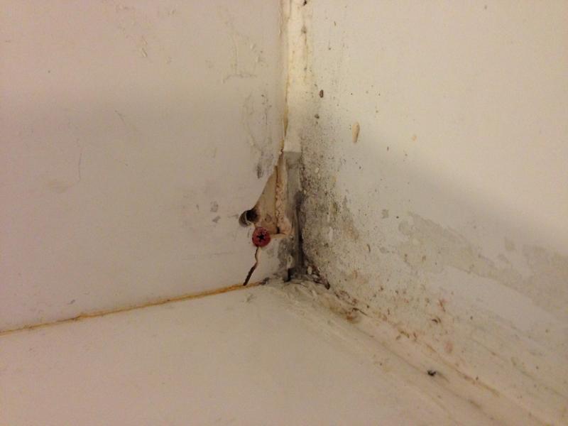

Hi, I'm fitting a shower door, I've started drilling the holes but I've cracked a tile in the process.
Can anyone suggest how I can work around this?
See image below...
Can't quite see why you are drilling in a corner to fit a shower door? But if you are fitting some sort of hinge, bracket or mounting strip clean out all loose material and repair with grout might take a couple of fills to get it smooth and level the thing you are mounting should cover it.
Correct answer of course is replace the tile, but I assume you can't match or simply don't want to.

Hi, yeah it's for a hinge, so I have to do one at the top too.
So, when I do that hinge, should I remove the tile? Or drill through it? How do I drill through it without cracking it?

It depends on how well the tile is fixed and supported by the adhesive if there is a void behind it it may well crack again.
Use a new sharp good quality masonry drill (not one of those in a set of 5 for a couple of quid :)) put a couple of layers of masking tape on the tile and use light pressure. masonry drills always say slow speed, but once the drill has made a slight start I find fast works fine on tiles.
Hammer action off till you hit hard brick.
After you have gone through you may need to use a larger drill to provide clearance for the wall plug to pass through depending on how large the rim of the plug is, ensure the plug is pushed through well into the wall so it will not expand in the tile or adhesive splitting it apart.

Your drilling to far into the corner to fit screen for a start...and you won't be able to seal the outside off it with silicone...
The tiles you have cracked take out and replace and before you fix new tile,drill the holes for hinge through it before fixing onto the wall then fix tile and drill into wall for plug then screw hinge on...
6mm masonary bit on drill not hammer.
