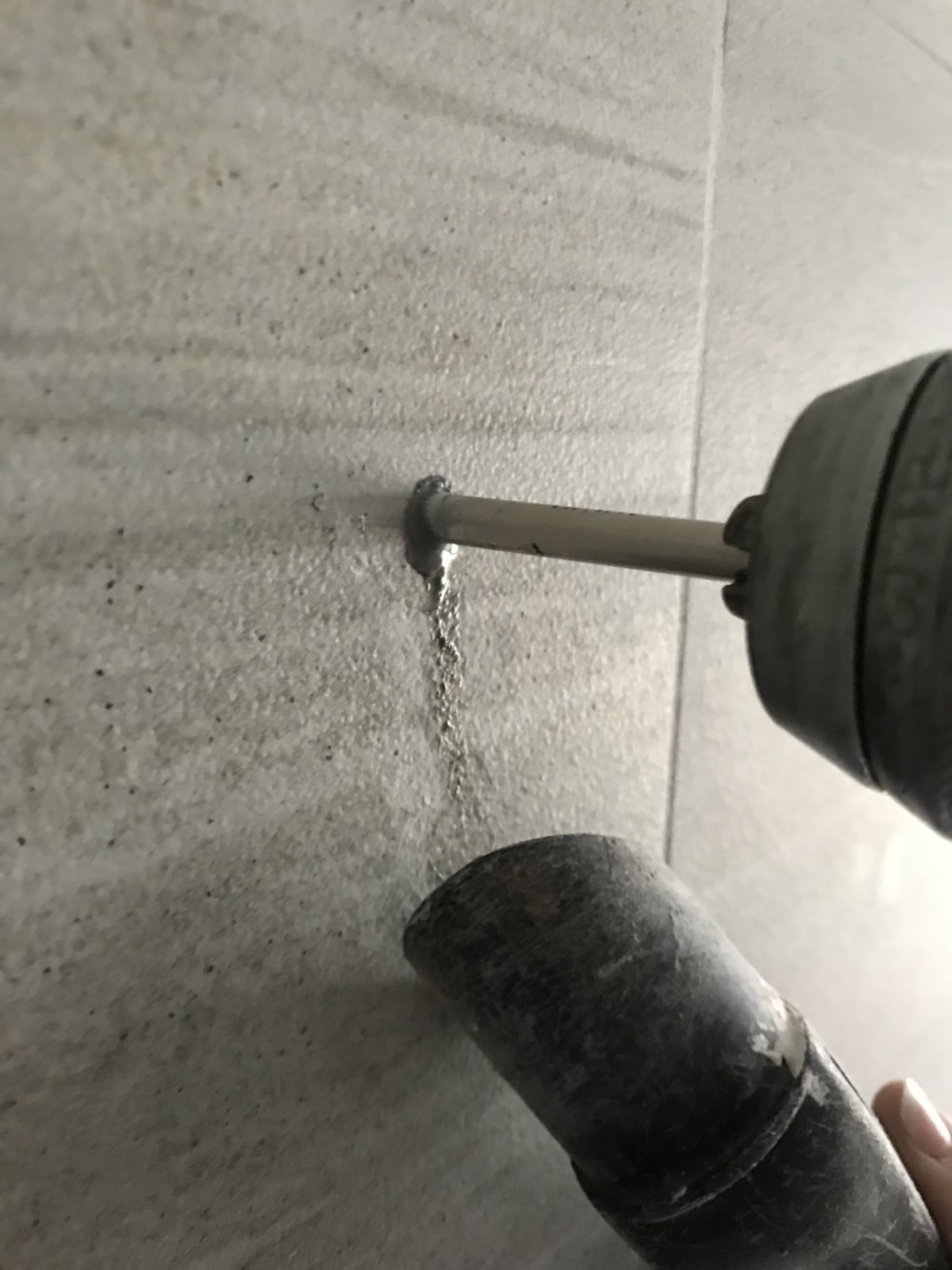

I had fun last night trying to drill through bathroom tiles which were thicker than average bathroom tiles. I started off using Bosch multiconstruction bits and even after 30 mins of drilling, I'd made a dent about 3-4mm deep at most.

The 6mm did most of the work but even then, it wouldn't go more than 7-8mm deep. I ended up resorting to the multiconstruction bits again and using the hammer function. Still took time but I managed to get through without cracking the tiles.

Armeg do an excellent drill bit for hard tiles, I use them on the sort of tiles you find in public lavatories (e.g in restaurants, pubs, hotels, etc) these days as the old style "spear" bits just won't hack it. They aren't chjeap, they require water lubrication and they only do 25 to 40 holes. But they do work on very hard tiles. A tad expensive to buy as a set, though.
A mate of mine has recently tried Keramo drill bits and says they are good (and a lot cheaper), but I can't say one way or the other as I haven't used them personally

If they are stone, you could try silicon carbide or diamond hole saws/core bit. If you can find one small enough..
Use regular coolant on the bit with a sprayer
Nozzle
I used some similar to the ones Foxhole linked but could only use them once I started the hole with one of these:
https://www.toolstation.com/shop/p98281
That was on porcelain tiles that were very hard, kept the drill slow and the tip wet :cautious:

Me too, they're cheap but pop them in a glass of cold water after 10 seconds of drilling keeps them cool and the water lubricates the drill.
