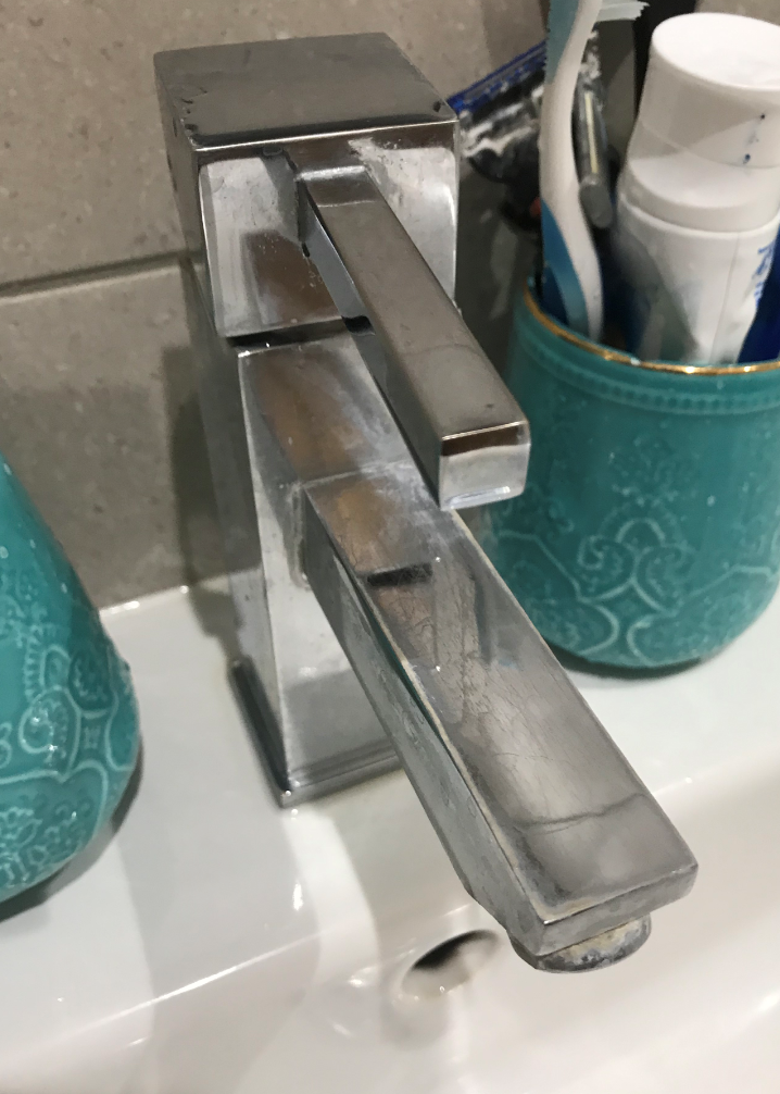

Dripping basin tap
30 Mar 2015
4,136
64
I have one of these in my bath basin and it's been dripping for a while.
Can this be resolved using one of these?
Also, I have a megaflo for my hot water which I think means that I just need to switch the water off at the cold mains as it enters the house and this will then stop my hot and cold supply. Can you please confirm.
Thanks in advance.
1. You are going to need something like Screwfix 6086X - as an example, may not suit your taps.
2. You will need to turn off the water and remove the existing cartridge, take various measurement and obtain a replacement.
3. If you have an unvented cylinder, as you say, turning off the cold at the main stopcock will stop both hot and cold. Run the taps for a short while to make sure there aren't any "odd" connections.
