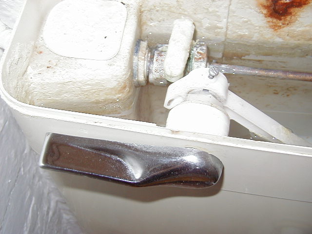

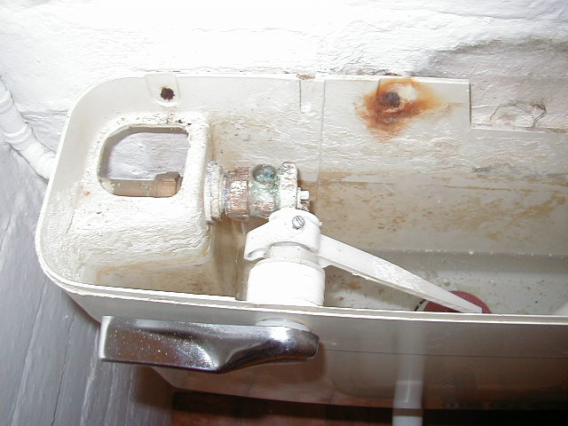

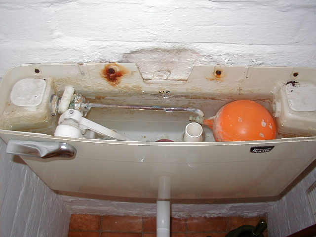

My loo cistern has suddenly decided to drip from the feed pipe and cause the overflow to drip.
The ballcock could be adjusted but for the build up of limescale (see photo) but I suspect it might be the other end that's the problem - ie is there a washer or something that closes off the entry point when the ballcock rises? Might this need replacing and if so how?
You can either fit a brand new ballcock cost around 10 quid,or strip down the existing one ,clean it and fit new parts / seals.
If you choose the latter ,the big brass knurled nut ,where the float arm meets the valve, unscrews off to access the innards.

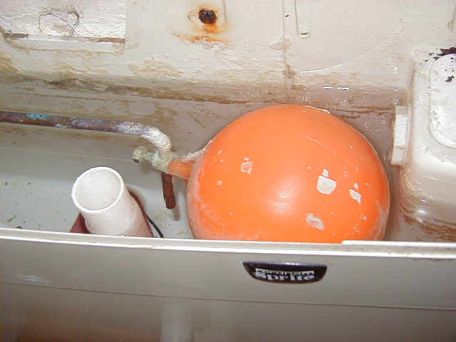

Thanks. Have disconnected the ball and removed the plastic water inlet to get access/space to the connections.
I can turn the whole unit now but it just turns- does not unscrew.....
Do I need to disconnect where the pipe comes through the side of the cistern (I'd rather not!)?
You need 2 sets of decent grips. One to hold the body 9f the valve,and the other to unscrew the knurled nut (Probably held together firmly by Limescale).
You need something to hold against turning it, like footprint wrench, grips et al, failing that just replace it.
sorry to be slow but...
which bit is the 'valve' that needs holding? If it's the section to the right (where the plastic water inlet was), then turning the nut on its left anti-clockwise will just tighten the twoparts together. Or am I turning it the wrong way.....?
Replacing it is the idea - but got to get the old one out first!
Apologies ,I thought you was trying to disassemble the valve ,not replace it.
If you are replacing ,that's done on the supply side ,externally.
And it looks,judging from your pics , like it may be awkward to do, as you will need to get spanners through that gap.
You should see a large hexagonal nut that tightens the valve to the cistern,next to that a smaller brass hexagonal nut that connects the supply pipe to the threaded valve tail. The smaller nut has to be undone first ,to seperate the supply pipe. Then remove the large nut and withdraw the whole thing from inside the cistern.
