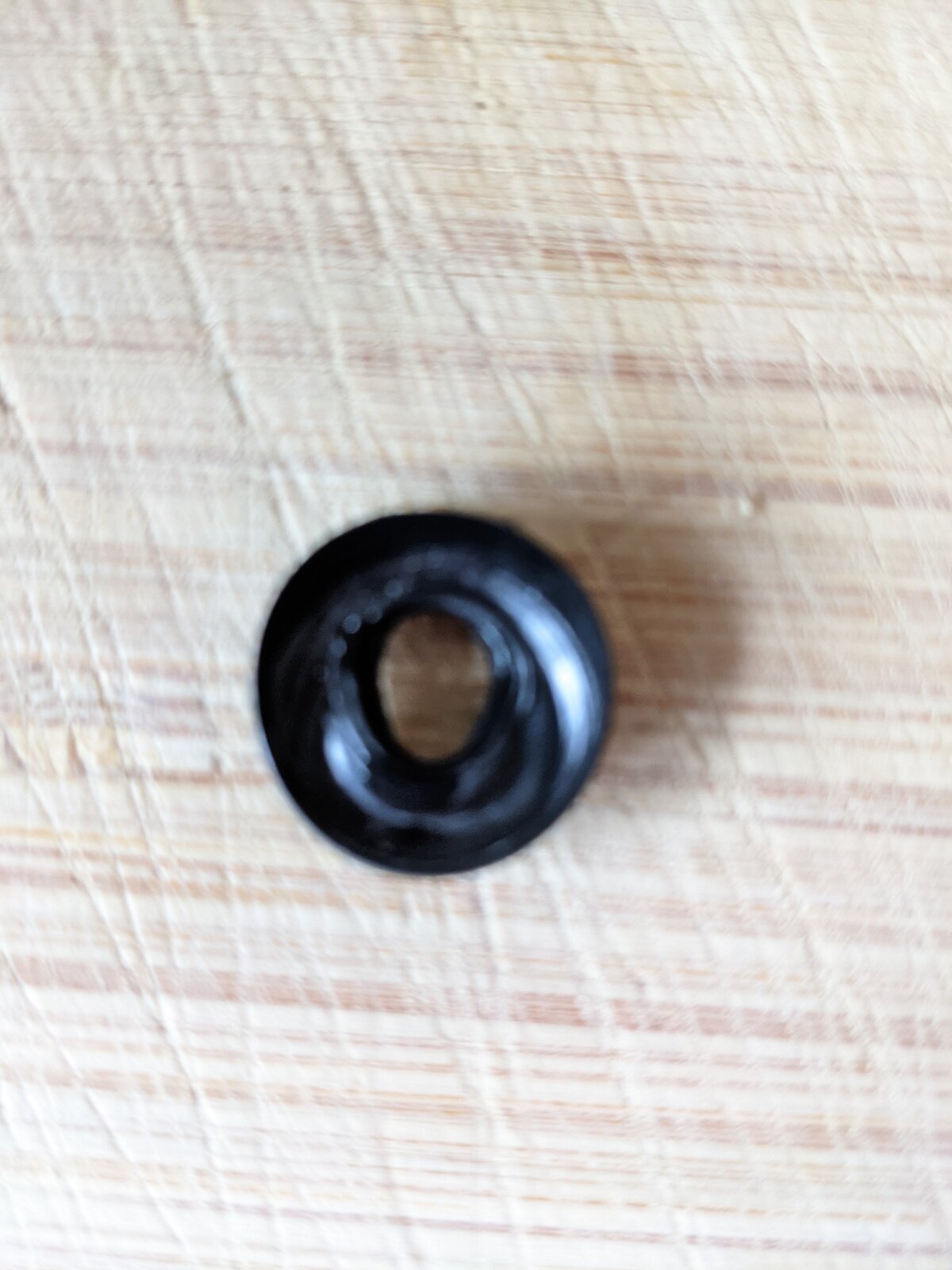

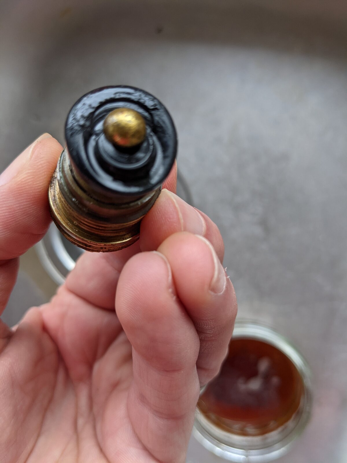

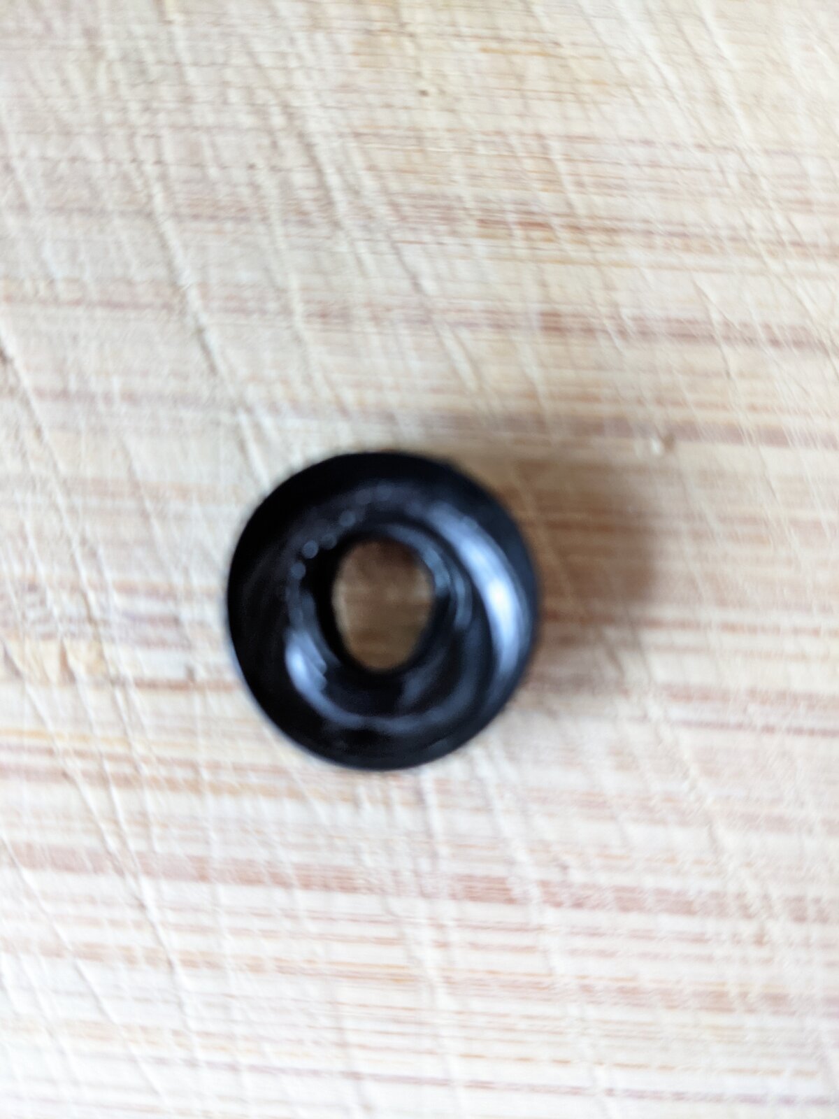

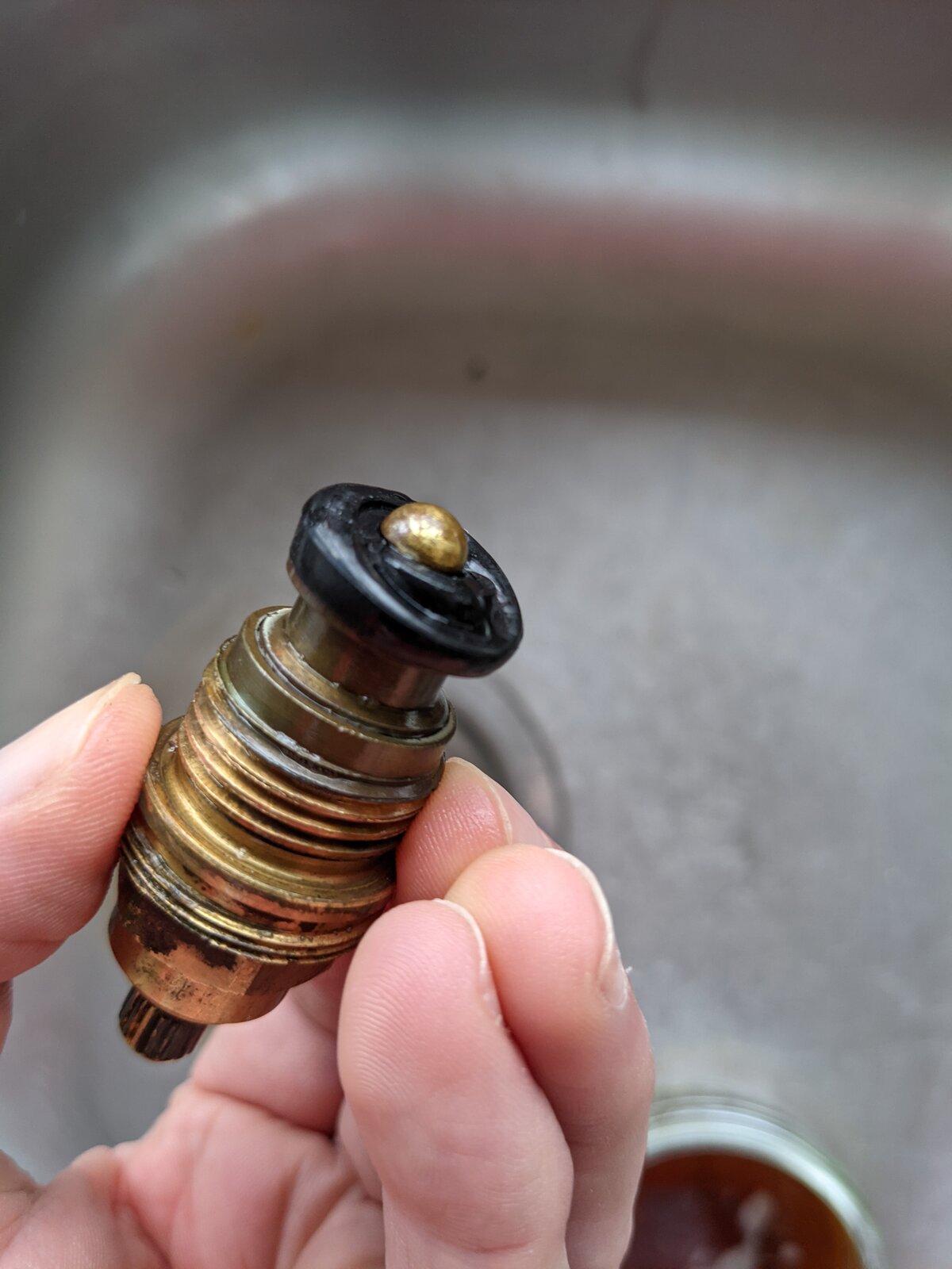

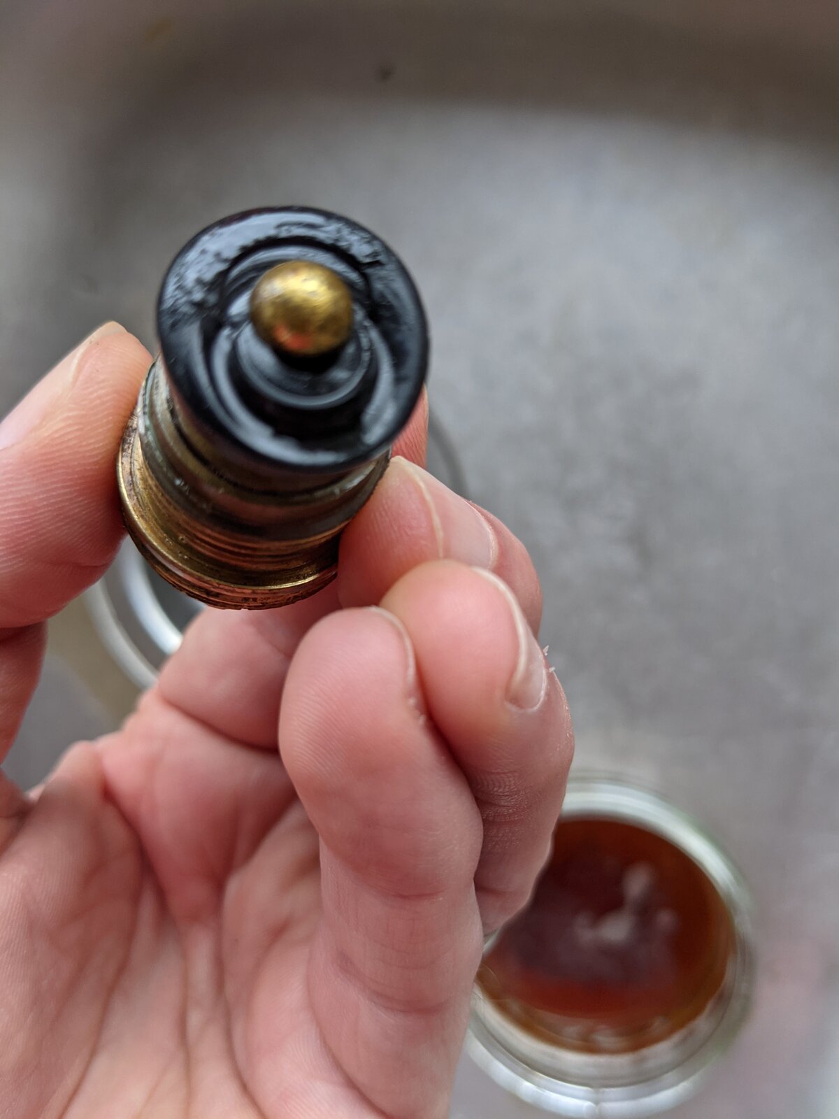

well I've just washed a video on repairing a Franke tap which looks similar and all he does is cleans the brasswork in vinegar and bicarb so I'm just trying that, although I couldn't shift the hot water shroud to take it out. One thing I did notice was that although there was a washer halfway up the assembly which I think is what was replaced, there was also one right on the bottom. This one was thicker and went around what looked like a nipple but it was more oval then round so had some slack in it. I'm thinking I should replace this one and maybe the issue?
Difficult to try and get the pics but hopefully can see firstly the washer isn't even and secondly the hole is quite big

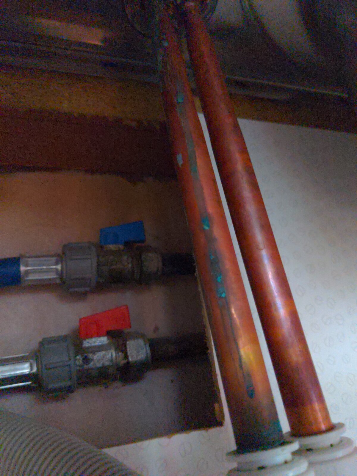

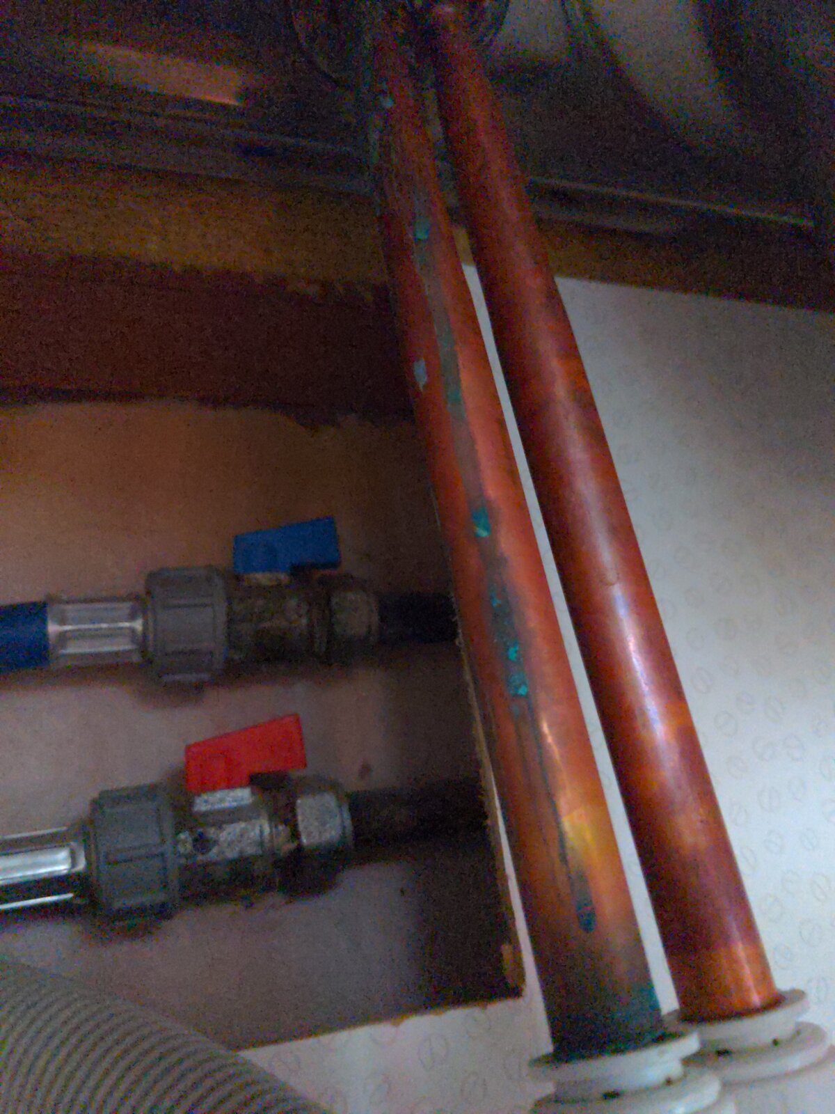

Tempted to change the tap, but it looks like when the B&Q fitted the kitchen 6 years ago, they used copper to push-fit connections so I'm not sure how easy it's going to be to replace that.
That washer has had it! Sorry!
If you want to post a pic of the under sink tap connectors, we may be able to help with that as well.
Didn't think it looked right :D
So I'm going to shoot to Toolstation and get a new washer, hopefully that could be the cause and I'll put it all back together testing with the hot water still off.

Those look like standard copper tails that come with the taps. You would just have to pull off the pushfit connectors and push them back on to the new taps tails.

Boom, Stuart 1 - Drip 0. Had to buy a 5 pack of washers for the mighty sum of £1.51 Struggled to get it on but I guess they aren't supposed to be easy but with a bit of persuasion from pliers it went on. Reassembled and no drip from the cold. Tried the hot, considering I didn't change that one, and still no drip. In fact I'd even go as far as saying it's the best it's ever been.
Can only assume when our guy replaced it a couple of weeks ago, it didn't go on right which is why when I took the assembly out, it fell of and was stuck in the base and looked the way it did.
