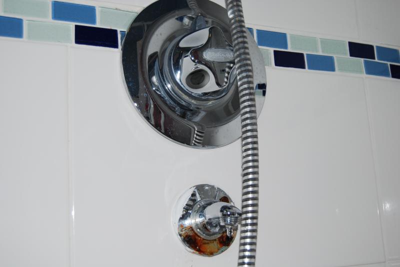

Hello,
I have a Gainsborough Ambassador shower (built in valve type) which has started dripping through the outlet pipe. Can anyone advise what might be causing this and if I am likely to be able to fix it without having to expose the enclosed pipework behind the tiles?
Thanks in advance....
a new sevice kit or replacement cartridge will sort this there should be no need to expose any pipework
