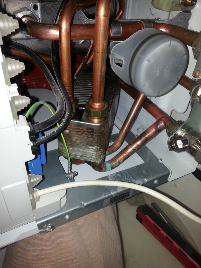

This morning I came downstairs to find water under the boiler and a drip every 2 seconds from the silver corrugated box shown in the pic (view taken looking up). Pressure gauge dial was at nearly zero (I had toppped it up to 1 last night)
I'll get on to a plumber on Monday morning, but just so I know, can anyone hazard a guess as to the problem? What is that silver box? I cant see it leaking from the compression joint either side of it, and the staining on the box would sugest a leak for some time, though I've never noticed it.

The silver box is a hot water plate heat exchanger ,it may have pinholed or a seal gone or it could even be above
There's an auto air vent up above there that would sound more likely.
would be surprised if plate leaking , it looks like its coming from above as looking on left side panel at bottom ( staining )

It was the pressure release valve, as suggested above. That and the pressure vessel below it were replaced today by Worcester.
