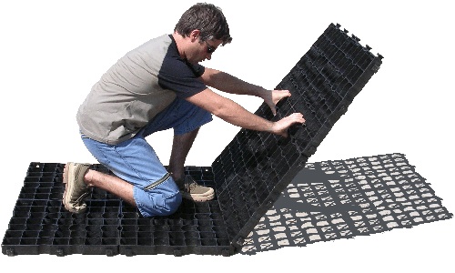

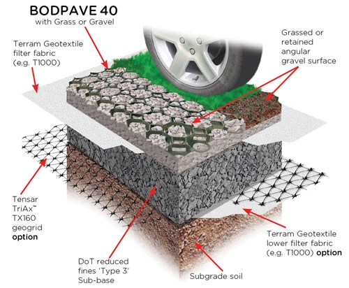

...in the mean have you looked into this?

hi thanks for that however i want to stay clear of the stone method from now on.
couldn't find the stuff at a sensible price per sq m-
Give us an idea of what you've found so far... See if I can find a better price.
Why it's expensive I've no idea; it's just glamorised interlocked upside down milk crates! :)
I know and its really annoying- best price for the plastic for medium-heavy load was about £10-odd/sq m (when I was looking on Google a year ago)- which sounds fine till you add the geotex and excavation depth (= skips to lose spoil) and other bits and bobs and suddenly for the 50 sq m I need to do it gets a bit pricey- near concrete price as it goes.
