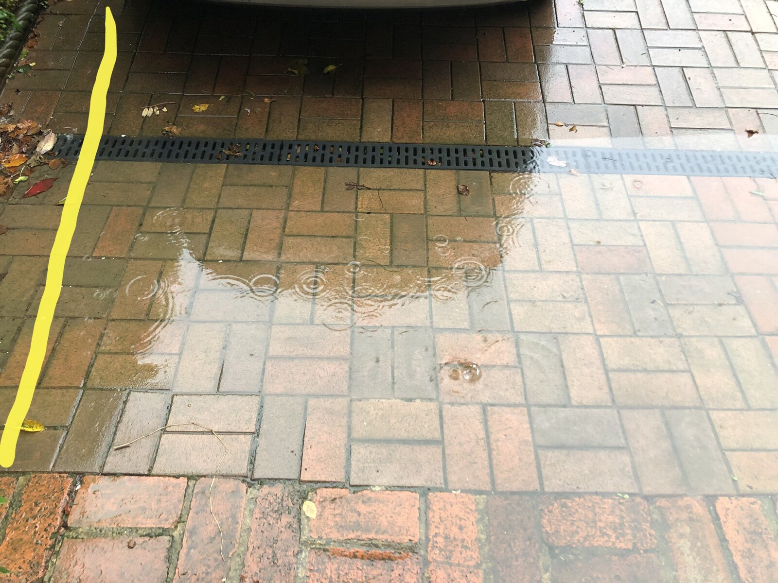

I was wondering if anyone could offer me some advice and the process to take to add proper drainage to my driveway.
The house is situated on the side of a road down a slight hill. Whenever we have heavy rain we get a build up of water outside the front door, as the water just runs down the driveway/garden. There is a small channel at the bottom of the drive but this doesn't actually go anywhere.
We have a combined sewage system and the yellow line in the picture above is where i believe the drainage runs.
We can't use a soakaway as the front garden is too small to allow good distance from house and we also have clay soil.
Would i be able in someway to connect up the drainage channel to the sewage system?
What would be the way to do this? and would i need to contact water company? council?
Many Thanks

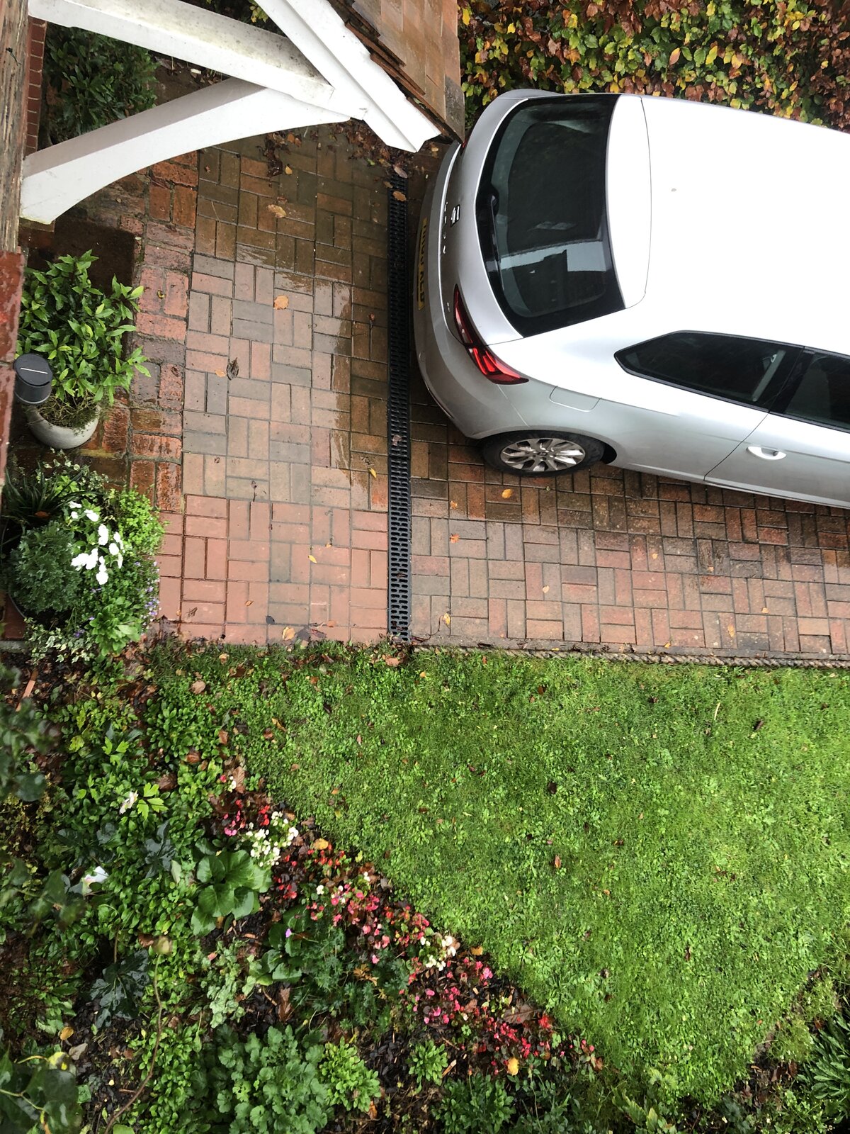

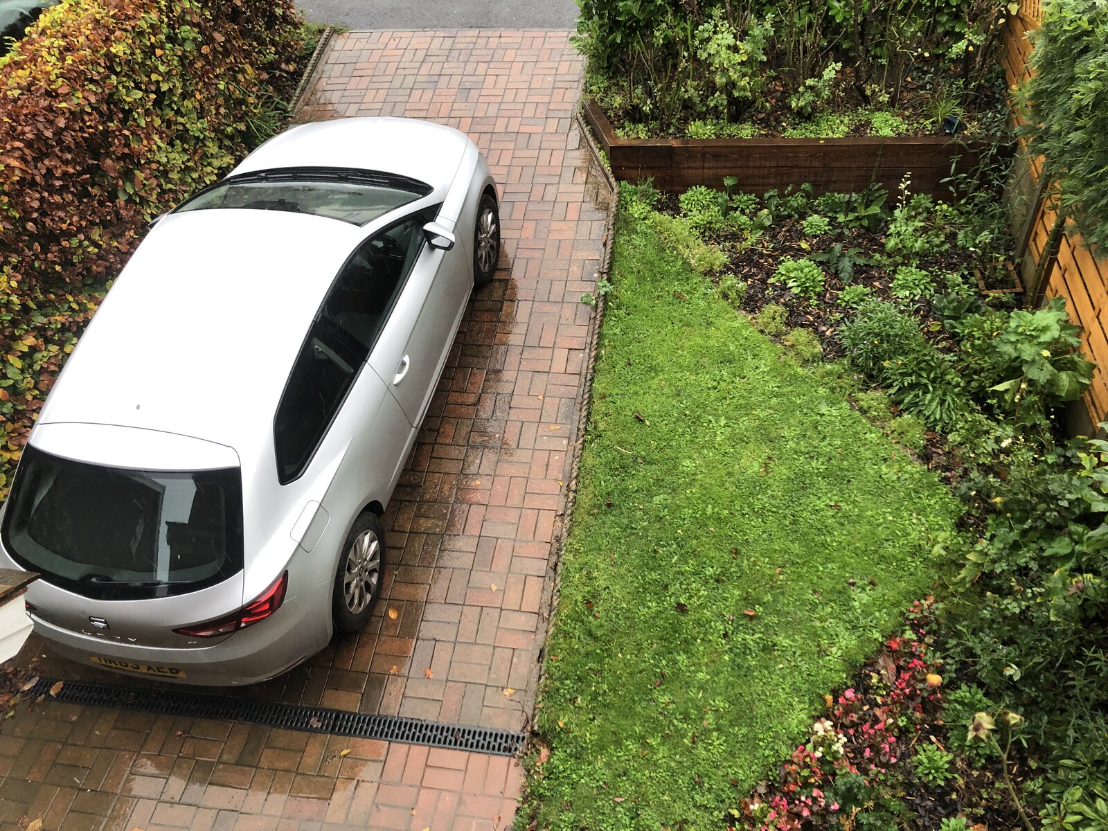

A wider view of the whole drive and what's in front of it may help those on here that know about this give you better advise.
Hopefully these help?!?
Pavement and road are at top of drive
I heard that they don't like you doing it.
However, if you already have a combined surface water and foul, then you already will be paying the surface water charge. If so, I wonder if you can just connect it?
I'm sure someone who knows more will be along and will say if this is allowed.
Recently I found my soakaway was silted up. Jetting etc was no good. Required a new one.
I phoned and asked the Water Co if I could link up the gutters to the main drain. They said yes, let me know how much the surface water charge was and updated my bills from that date.
