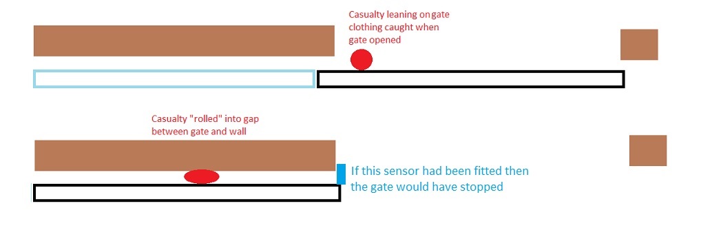

This was a non fatal incident. The person was trapped ( and slightly squashed ) between the gate and the wall for over an hour before the gate could be dismantled to release him.
