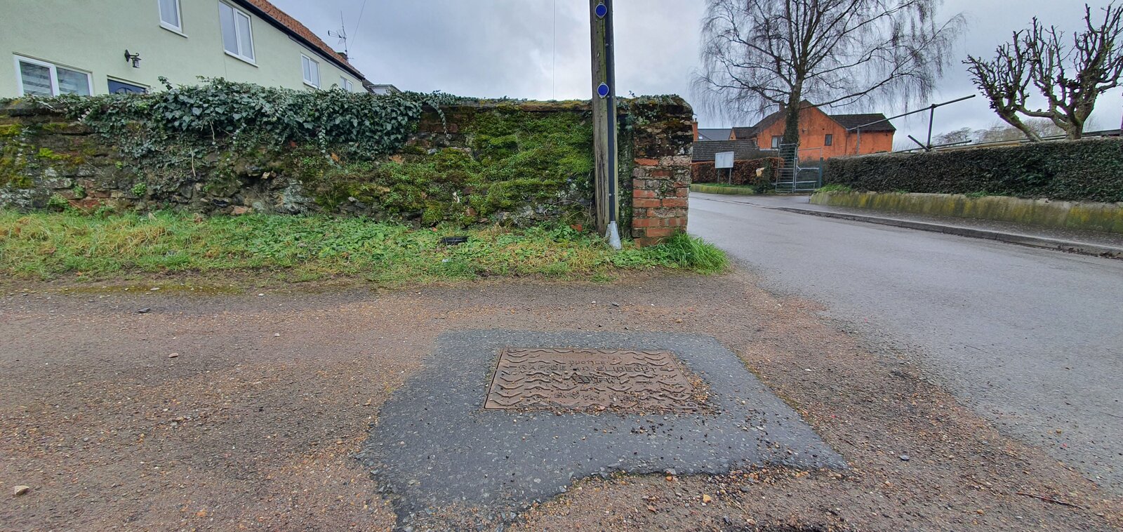

We access our house from a driveway shared between 3 houses. There is a old wall to one side that is not owned by any of us and is too high. I have talked to the owner of the wall and they are not very keen to allow the height to be sympathetically altered, even at my expense, so we're on to Plan B.
The owners of the 3 houses that use the drive agree that we would like to improve the safety and will seek to raise the level of the driveway as the best workaround. To do that we would need to add around 200-220mm to the height, 2.4-2.5 metres back from the highway line, blending it back to highway level, but of course this creates a bit of a ramp (around 10% by my reckoning). This would create a height of around 1m to the top of the wall, much safer.
If you look closely at the picture, there is a water main cover in the grass verge. That happens to be about 2.5 metres back from the highway and it currently sits at around 250mm from the surface, so the alteration would put the finished drive just under that height.
My question is, how would this be in terms of usage when turning in off the road? Will this gradient pose much risk of normal cars grounding out?

To see traffic to the left when you join the highway. There is a 1m fence on the other side and the view that was is perfect, we want to achieve the same effect to the left. By raising the surface of the drive, we'll be able to see over it. Problem (mostly) solved. (Hopefully).

Yes, I said that in my original post. The slope would need to transition back to the highway in the last 2.5m. But the rest of the driveway would benefit from the raised height, right up the point that you stop to view what's coming before you pull out. That's surely better than how it is now, where you have to pull gradually out into the road to peep round the corner of the wall?
So, on the original point, do you think a gradient change of 200-220mm over a length of 2.4-2.5m would create a slope that is unreasonable?
20 cm rise over 200 cm is a 1:10
20 cm rise over 250cm is 1:12 ish
