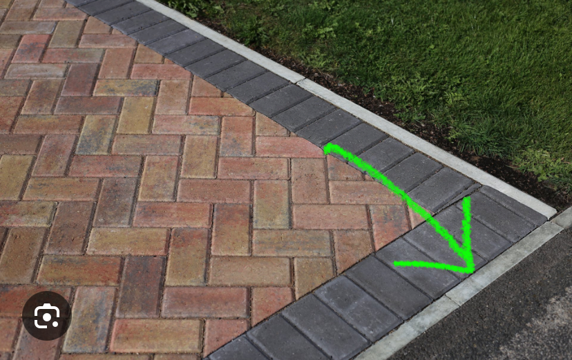

Just to hijack my own thread, am I right in thinking I should probably put those concrete 6” edgings buried level with top of pavers and pavement, between the two? Guess it gives my pavers a bit of protection when they maintain the pavement? I’ve seen it done with and without but I am guessing with, is the better job ….
Ie these:
Ie these:View attachment 355605
Yes. Always have a demarcation edging. You will see them installed on sites (between domestic and Highways), for a reason.
