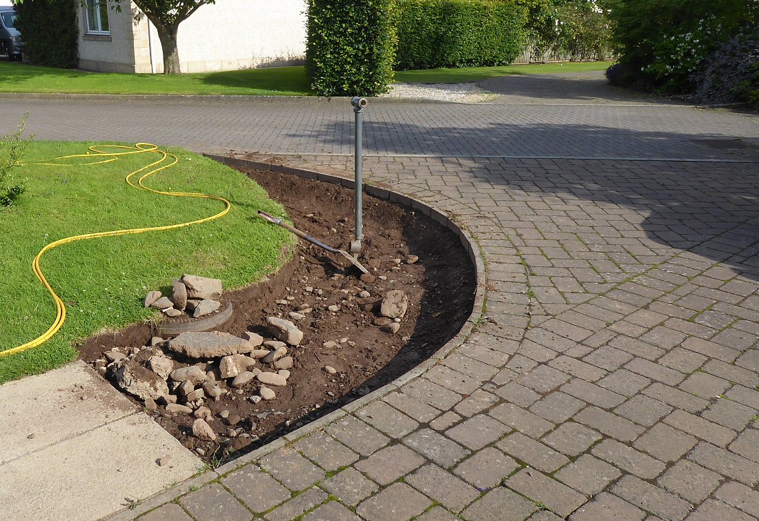

I am going to widen the entrance to the driveway, which you can see by the picture I got started the day by digging out the area it is going to be extended into.

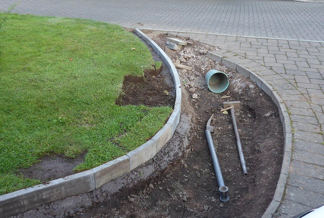

The plan: Form a new edge just in from the grass, dig completely out the old edge, fill with hardcore, compact down and then relay the new paviour blocks on a bed of sharp sand.
My Questions; How long after I lay the new edge on/in concrete can I add the hardcre and compact down? I know its sort of dam-shaped but I don't want the compacter to break it. Is a week enough?
Also, the old edge, if I just break off the top of the edging leaving the concrete below (it will be close to the underneath of the blocks) will it be obvious what I have done? or would I be best digging all the concrete out and have an even sub-base throughout ?
A week is plenty. If you leave the concrete in and the rest settles a bit then the new bit above it may sit proud of the rest.
As it turns out the concrete holding up the original edge was fairly soft (must of been 8:1 / 10:1) , soon broke it up with a little micky mouse 2kg SDS
By the time I get round to back filling with hardcore and getting a whacker the concrete on the new edge will of had a few weeks, and with the turf relaid I'm guessing it should be strong enough
When I back fill with hardcore, what sort of gap should I allow for for the sharp sand - (what depth of sharp sand should these blocks sit in? looks like they have used about an inch on whats there)) is that about right?
Not more than 50mm of sand (y)
If you can match the existing that would be ideal.
