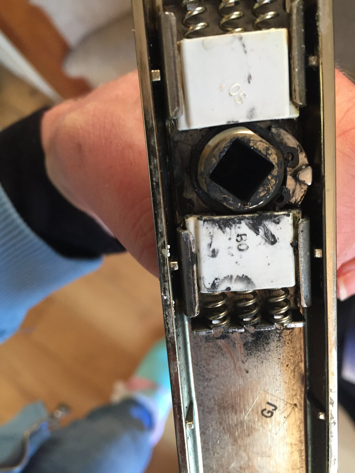

My external doors are drooping. I have enclosed a photo to show the inside of the handles. Can anyone help as the springs aren’t in a removable cartridge
Remove handle from faceplate and then spring cassette should slide out.
