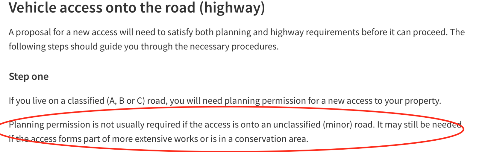

Maybe in the world of BAS, but in reality it's not. I took this originally from speaking to the council but it can be seen on both Derbys. and Staffs. County Council websites.
There's no mention of "extensive works" or the OP being in a "conservation area", so please explain to me how I am - as you so bluntly put it - "wrong".
Ah - that will be the world in which people read things properly.

OP -- my advice is to speak to the council for definite confirmation, but experience tells me it's very unlikely you'll need any permission for an extension to an existing dropped kerb if you're not on a classified road.
