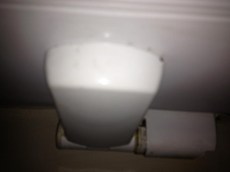

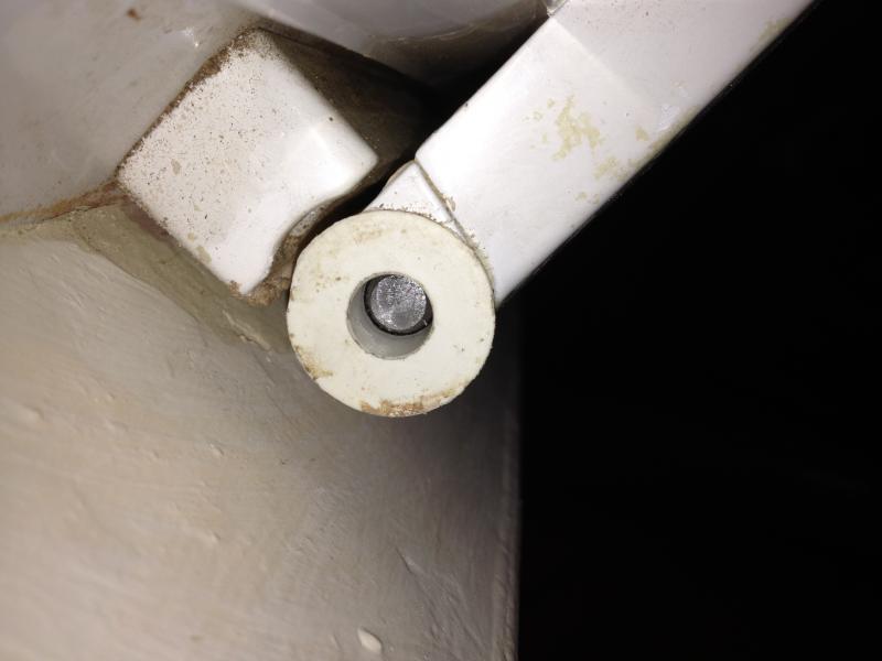

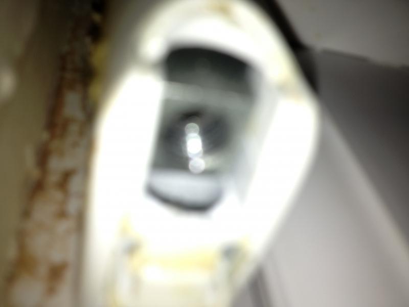

Hi I have a problem.
Ever since we had our sunshine.
My door has dropped and it is catching at the bottom.
On my hinge there is a alum key at the bottom on which I have adjusted clock rise. Which seems to have lifted the door.
However there is a gap where the door seal is not touching the frame.
I can hear the traffic outside and feel the cold coming through it.
Somebody told me to adjust the top of the hinge.
However there is just a bolt head at the top not a alum key hole.
This turns when I move the alum key from the bottom.
Please help.

Do you know who fitted the door?
It may be just a case of correctly packing the glazed area or infill, i.e. toe 'n' heel packing etc.
the bottom adjuster moves in and out aswell when you adjust it up or down, itl need a quarter of a turn back or to
