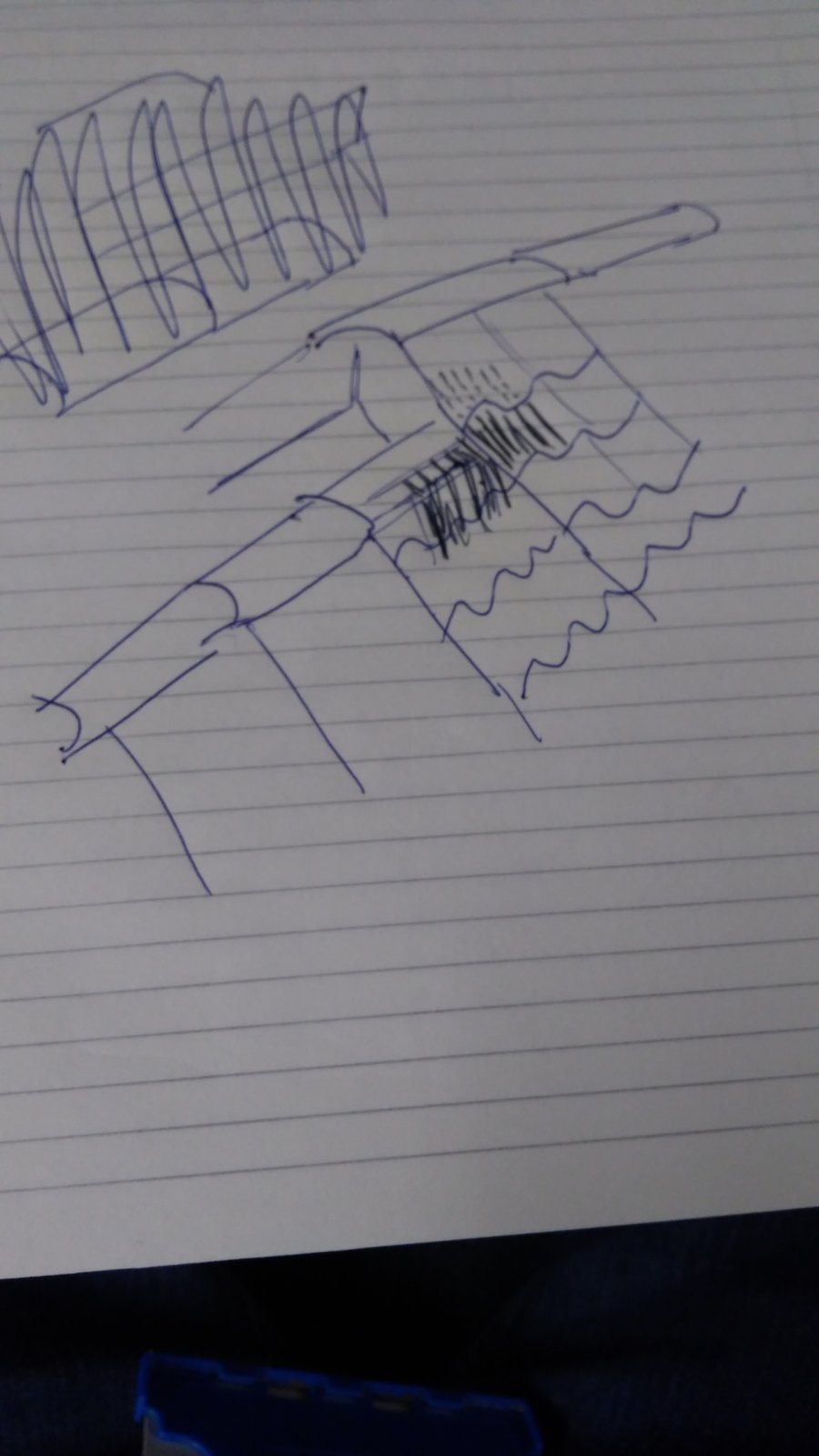

Thanks I think I know what you mean, I've tried to sketch it below, would the lead be dressed over the ridge battens and over the top of the first tile below the ridge on the new roof? Thanks for this really appreciated
I'd probably have to fix a screw through the lead for the last ridge fixing? Or shall I try and avoid that

Ok you have basically got it. I did think the ridges were inline with each other.
Even so the same applies as you have drawn it Saddle from under top course on main roof dressed around he end rafter and down onto your top tile (cut I believe) Then your lower ridge will go over it.
It doesn't need to be under the ridge more than 150mm
Now it will require a bit of bossing slowly slowly.. or get one made up .

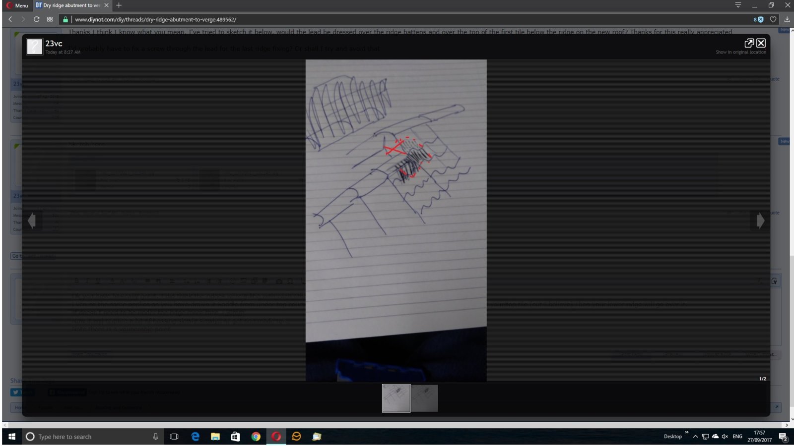

Note there is a vaunerable point at the X the lead would go on before you fit your barge or if its a brick gable An addition flashing will be required..

Only other thing was I need to batten the ridge up with a few battens and those square brackets as part of the klober dry ridge kit. I guess I am better stopping short of where the lead will be as I don't think dressing the lead over this will be easy or much point? Or I could fit the lead first and trap it under the ridge battens?
I guess I need to felt everything first in any case, lapping it over the ridge and getting everything covered.
Sorry loads of questions but I'm starting to get my head round it thanks.
the lead ideally needs to go over the ridge batten , you could cut the batten slightly short. dont trap it under the ridge batten.

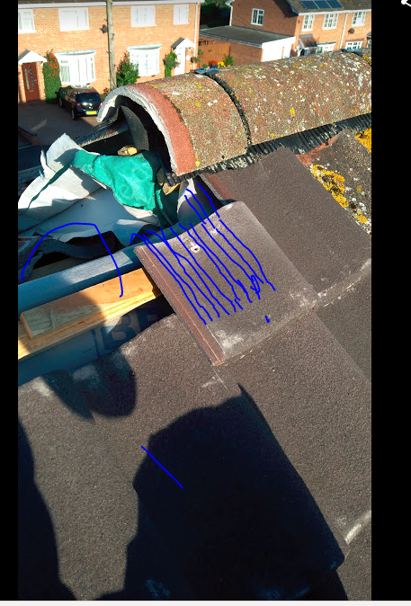

I have got a bit further with this now, pic attached showing my first cut tile on my new roof, the new ridge tile will sit above that
what I am not sure about is exactly where the lead is going in terms of the existing roof. I have tried to show it in blue on the picture, but I am not sure what to do with the lead when it meets the first full tile on the top course of the existing roof. Any pointers really appreciated

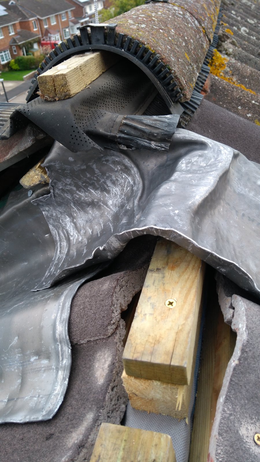

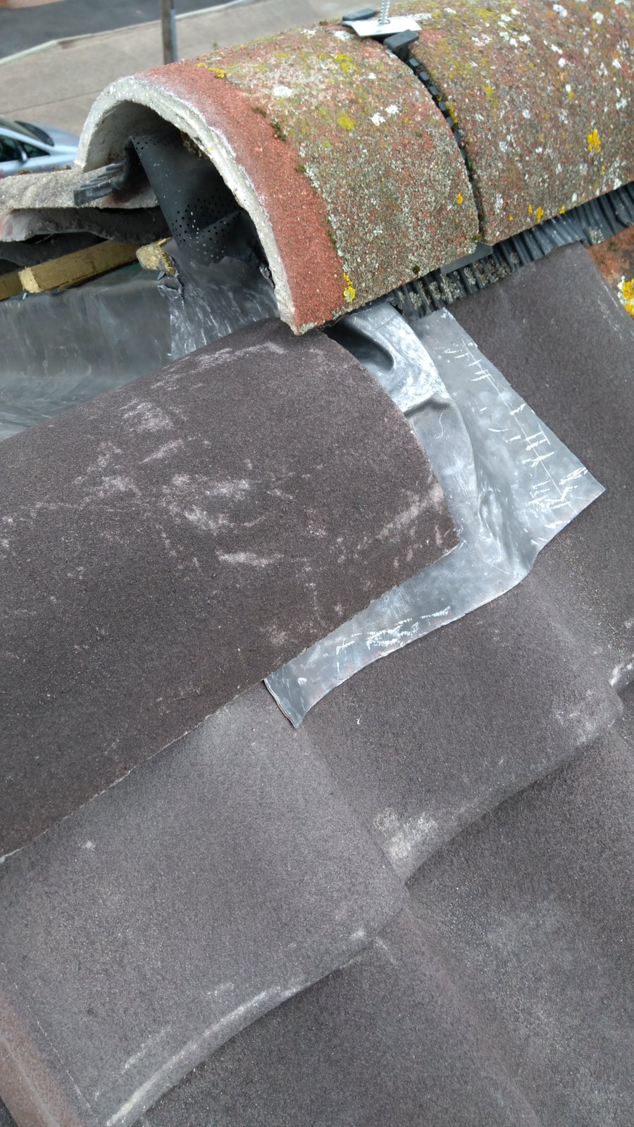

Been doing this all day today and I think I've cracked it, I will also point some mortar into the end of the lower ridge where it finishes, although water getting in there should just run down the lead and out.
I have turned the ends of the lead up under the roof to stop any water going sideways.
Any comments on this welcome, thanks again for the advice datarebal
