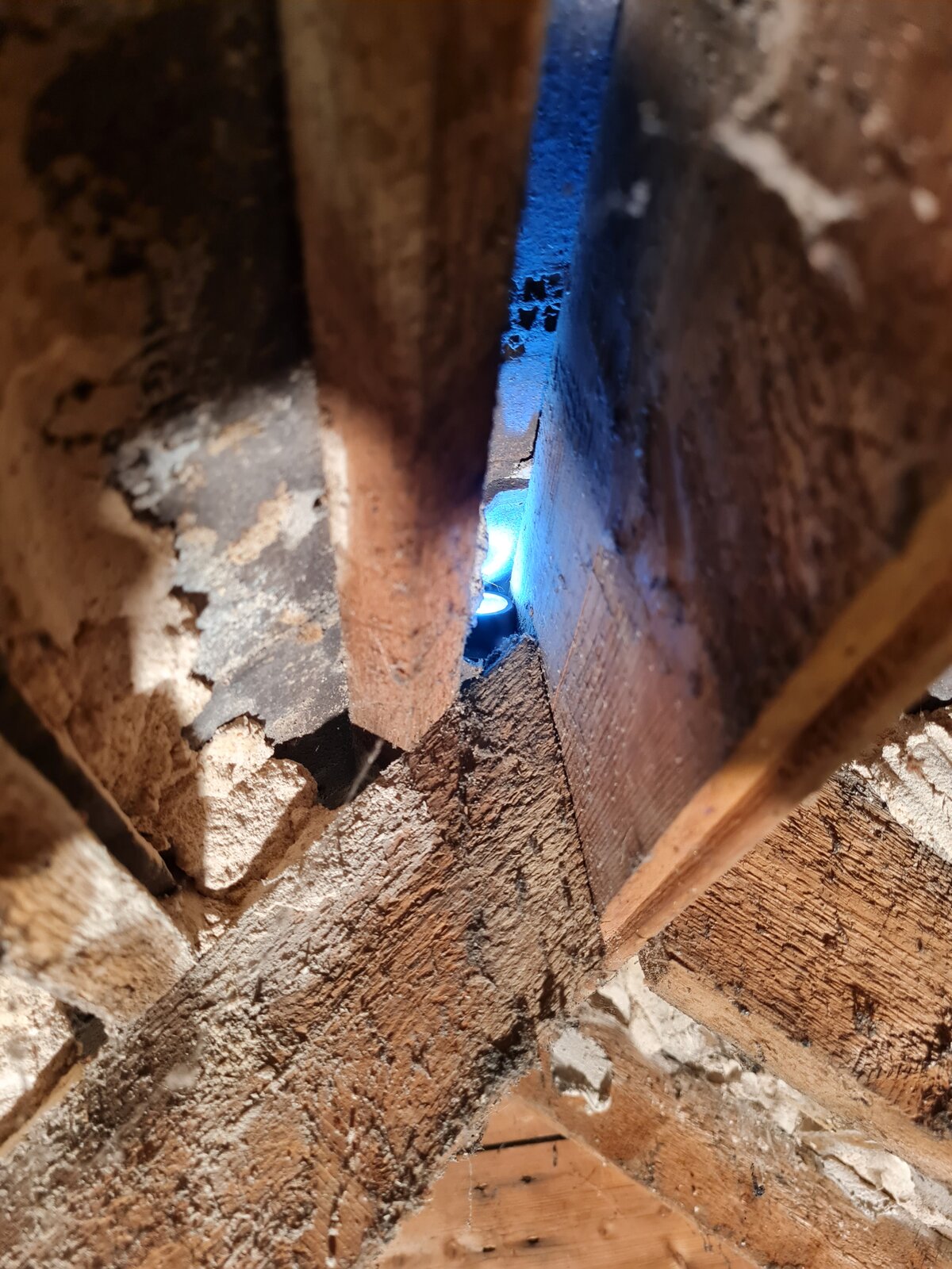

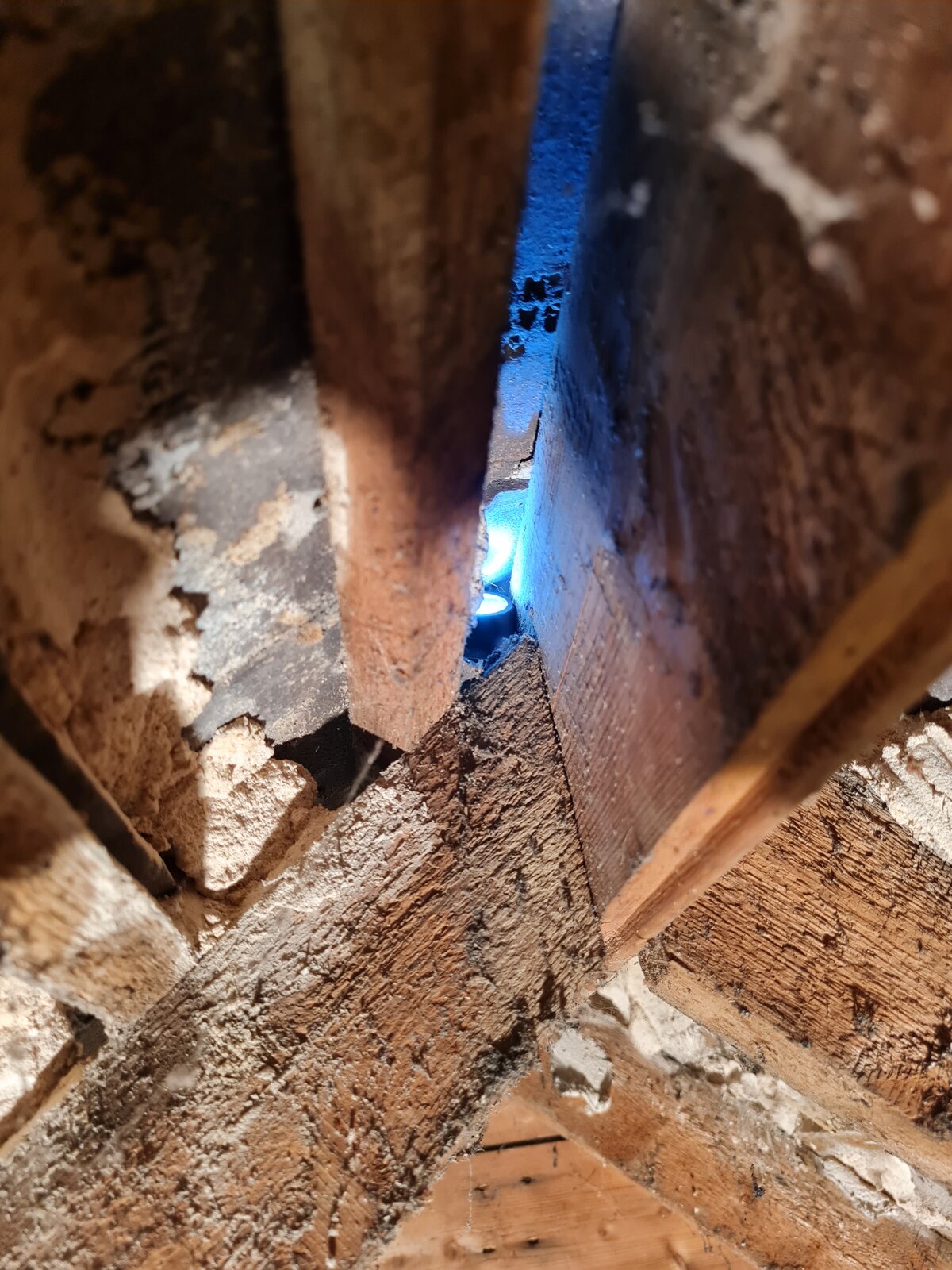

Hello can you help please I'm installing a dry ridge system problem is ridge board is 40mm higher than the top of the rafters

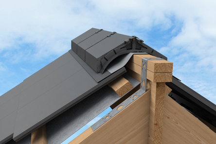

Hi I'm using the easyridge f dry fit kit as in the photo top of ridge board is tight to the underside of the ridge tile no room for a batten thanks
Are your current ridge tiles mortared in place and were you planning to reuse them?
No putting new half round clay ridge tiles on would it be OK to screw into the top of the ridge board to hold the union clips
hi there would I do any damage if I were to cut 25mm off the top of the ridge board many thanks
