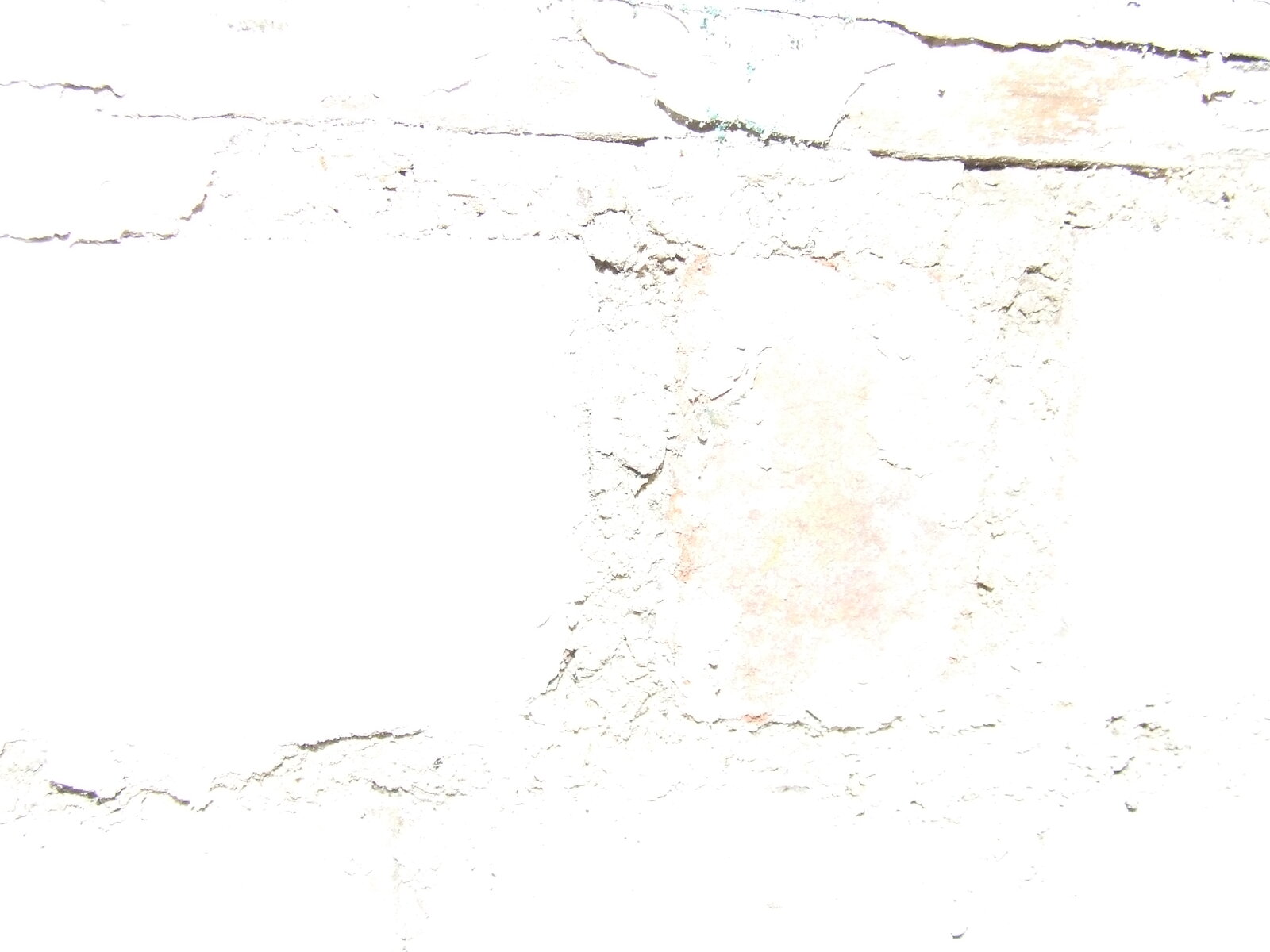

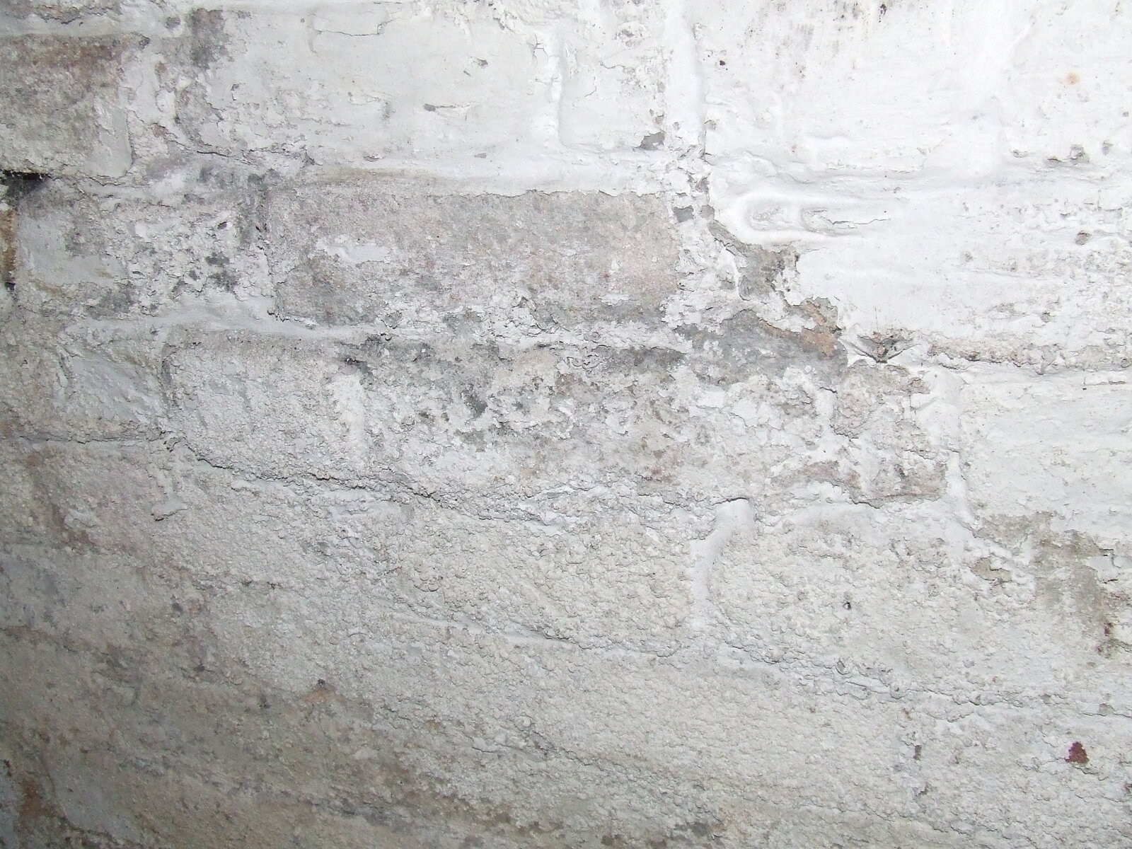

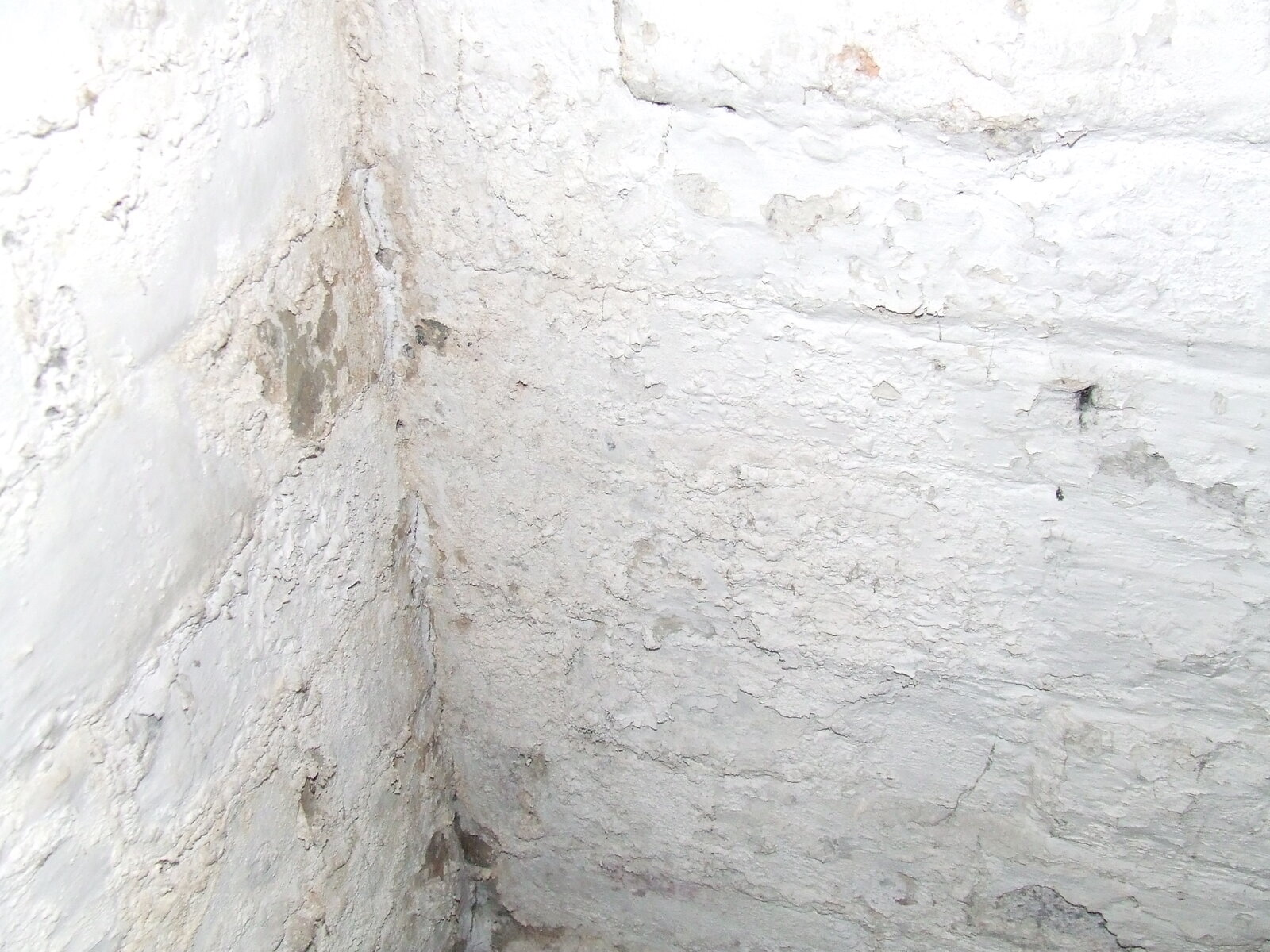

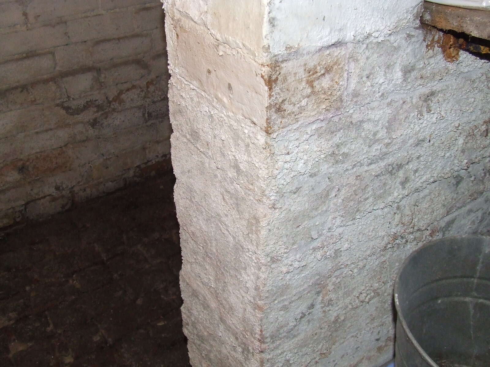

Thank you so much for the reply. It is much appreciated. I have attached some photos of the brickwork in my cellar. Are you able to shed any light on what is going on with the bricks. In the first one the mortar appears to be crumbling and on the others the brickwork appears to be flaking.
Thank you.

all looks very normal to me, looks like someone has painted it sometime in the past and it is now flaking off due to the dampness in the bricks (if it is in a cellar then the bricks will be a bit damp, thats normal)
